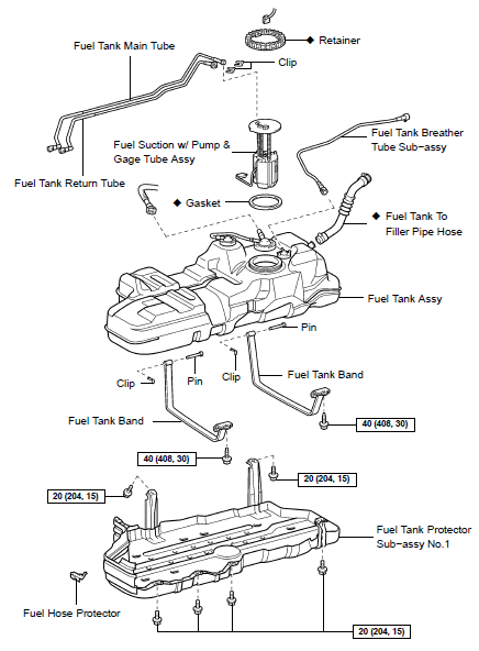

I don't know if this parts diagram of the fuel tank will help you or not...
It looks like you could disconnect the filler hose easily enough, IF there aren't other parts in the way.

Thanks Toto! That helps. I'll crawl under and take a look when I've got some light tomorrow.

Alreadybeenused: The obstruction was much lower, probably at the level of the tank. Accessing the hose from the cargo compartment wouldn't help, I think.
