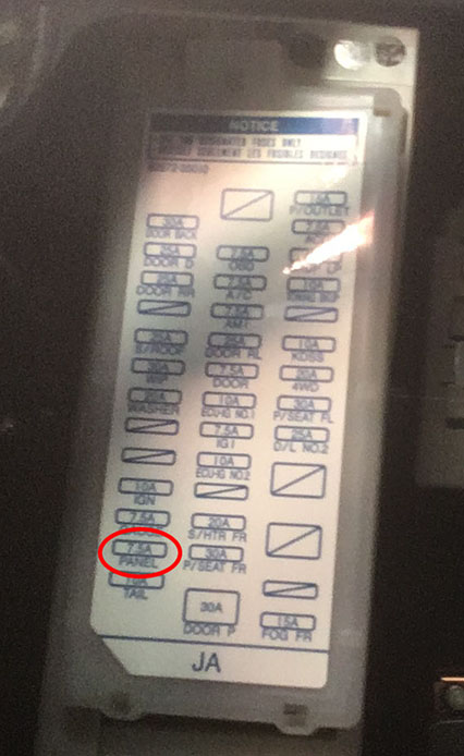

Well first up check all the fuses after you disconnect your last connection. That means both fuse boxes - the one by the E brake pedal and the one under the hood. By check, I mean pull each one out one at a time and check them with an ohm meter. They should all read a direct short. I know you can usually see if the fuse is blown; but sometimes it's not easy to tell; so pulling them out is the best way. Don't pull relays or fuses that are bolted in.

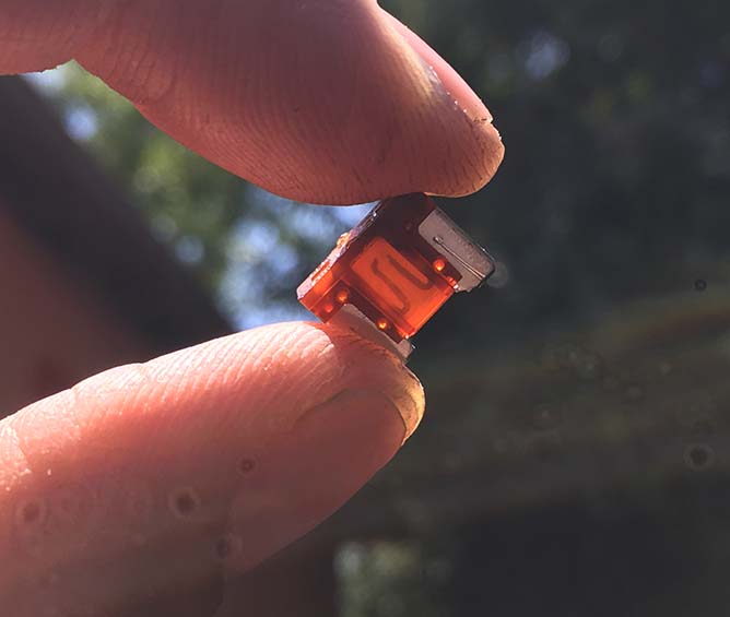

Thank you! I found a blown fuse in the box under by the parking brake pedal. It was the "panel" fuse, go figure. I'll go grab a replacement and see if that does it.

Good job - it looks like you found the problem. I'd get an assortment of fuses and keep them in the truck. They're real handy on trips. Also be sure to check your wiring before powering things back on.
Sure enough the new fuse fixed it. I bought a small variety pack of fuses that will now live in my glove box. Thanks again! So glad it wasn't something more expensive. Learned my lesson about digging in to the electrics without doing my homework.
