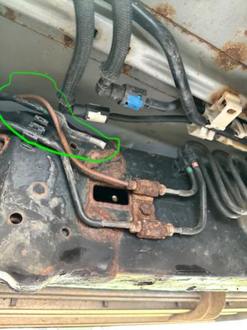

I was under my 2014 SR5 working on some corrosion mitigation and saw that I have a disconnected line that runs from near the front of the fuel tank to above the rear axle housing. It has a green paint mark on it and is next to what appears like the rear brake lines. Image attached. Any idea what it is? Thanks

Looks like it has already rotted through at some point and the OEM line was cutoff and a (poor) replacement section (rusty line) was installed. You should replace that junction and the cut line with OEM replacement parts.

So, if you follow that line back, where is the other end?
"front of the fuel tank to above the rear axle housing" It is above the rear axle housing not connected to anything. Looks like it is the stock brake line that is no longer in use.
This. And look at the bends (or lack thereof) in the replacement line. Obviously a poor fix and they even left the old line just hanging there. The repair obviously saved someone a couple bucks though.
I just had a dealer replace all my hardlines the right way, and it sure wasn't cheap. Especially adding in the full fluid flush afterwards.
