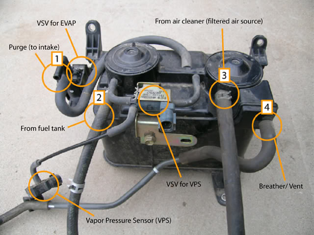

Evap Canister Question
Hey guys, while checking my vacuum hoses the other day I noticed something peculiar. While my rig was idling I pinched the vacuum hose that goes front the evap canister to the intake (after throttle body) which caused a stall (#1 on picture). I started the engine and pinched it again, this time I can hear the RPMs fluctuate but could not cause it to stall again. So my question is, why would this cause my engine to stall or fluctuate? Is this the only source of air while the throttle plate is closed at idle? I though the IAC provided air while idling.
Based on ajonesnv's suggestion, I'm looking into the evap canister as well.
Two possible things could cause a stall when pinching off that hose.
1. The system is in purge mode, and the computer EXPECTS this extra air in the system, and when it doesn't have it, it can stall
2. There is a failure in the purge system or canister, and the IAC has adapted to the additional air coming through, but when you pinch it off, the engine will stall because it doesn't have enough air. I haven't read the entire thread, but am simply answering that one specific question.

Hmmm interesting. I have a question about the VSV (#1 in picture). I know it's a simple open/close switch that feeds air to the intake but is the valve itself variable? The reason why I ask is I've noticed that the ticking intensity on the VSV is sometimes quite and sometimes loud. Shouldn't it be consistent?

Pretty sure it's an on/off solenoid.
I would also suggest that you pull the canister and inspect the seam where it is pressed together. This area has a consistent rate of failure in these trucks and can be a source of a vacuum leak. The factory glue gets brittle and starts falling out. Many have been able to reseal the edge with a heavy RTV or Silicon successfully.

Seems like we are getting somewhere, I've noticed that when I shut off my engine I hear a very very faint high pitched noise like air either being sucked in or escaping from the canister. I've never though much of it because it was so faint, I'm now assuming it supposed to be a sealed system right?. Until now, I would have never suspected the evap canister to affect the vehicles driveabilty characteristics because I though it was only an emissions device.
Some of this is starting to make sense because the stalling only occurs during warmer weather and after longer drives. It has to be somehow connected right? The reason why I never suspected the evap canister is because every Goggle search I've done has only produced posts where people had to replace there canister because of a CEL, not because it caused a stall. You are the only person who mentioned that the canister had a direct relation to stalling.

The evap canister making noise on early 4runners after shutting it off is pretty common. I know it is for 96's and think it goes through the 98 model year. They even had a fix for it years ago from the dealer that's not offered anymore. Do a Google search for evap canister making noise or bumblebee noises and you'll find threads about it.

The noise I hear is a faint high pitched noise, almost like letting air out of a balloon.
