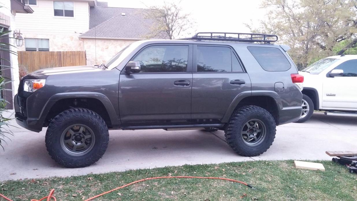

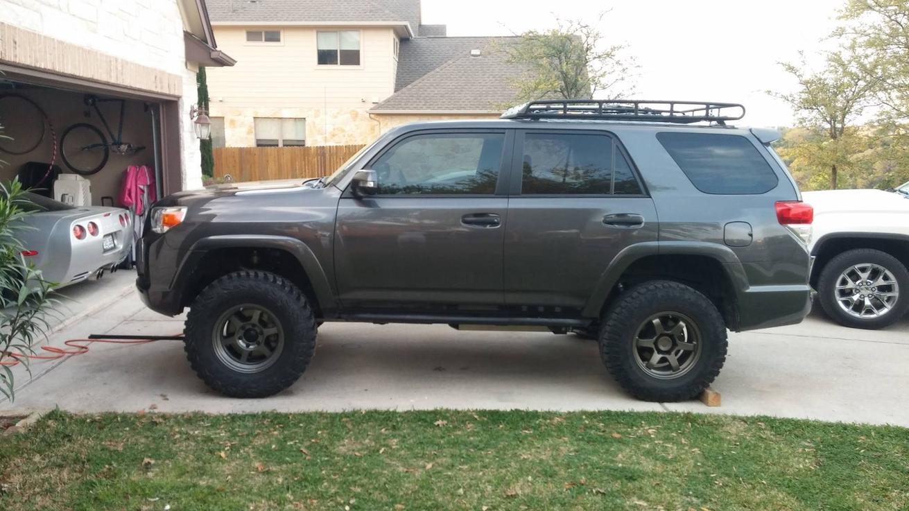

Got them mounted and installed today. Super duper happy so far. No real road time yet, just mounted and drove around the neighborhood. It looks great and these are clearly the max tire that will fit without a body lift. Still need to do the BMC, but clearance looks good so far. I flexed to the bump stops in rear and all was good. But it only works because of the 3" bump stop extensions. I don't think it would clear with normal up travel and stock bump stops.
They measured exactly 34.2 on the 8" rim. I gained .75" of ground clearance at the rear diff now @ 11.20". My Duratracks 285/70 17 measure ~32.7". So 1.5" larger diameter. It is significant, does not sound like much, but man its bad ass.
Here is a couple of quick pics (taken with my broken phone). Not very good ones... but it will give you and idea of what they look like.
First one is with the 34s up front and 33s in the rear.
Thanks to [MENTION=89562]bimrunner[/MENTION] for the inspiration on these. I'm thrilled (and I did not copy your wheel color). I can't wait to hit the trail with it, but I'm going need to wait on my buddy to do the BMC. I should just do it myself, and get out this weekend, but he was looking for work and is a fantastic welder, so I will probably wait until he has time, since I already offered him the job.
