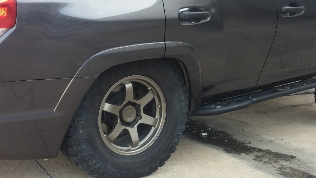

Pic is my rear tire on the bump stop. EDIT: It's actually not quite on it looks to be about .25 or so off.

Dang those bumps really limit the up travel. I can pretty much stuff my 34s only problem being the rear bumper a little.
With your rear tire like that is the shock pretty much bottomed out?
I went and looked at the pic I took under and I'm actually about .25" - .5 off the bump stop there.... I need to take the sway bar off to really get it fully flexed out at that spot (which is my neighbors driveway LOL).
But yes they are there to stop the shock from bottom out. With most LT shocks you have to sacrifice up-travel to gain down. I had some cheap pro-comps on for a while that did not require bump stops (since they had a great compressed vs extended profile). I could stuff the tires like crazy, but the Icons with the longer extension (but also a longer compressed length) actually yielded much better overall characteristics on the trail.

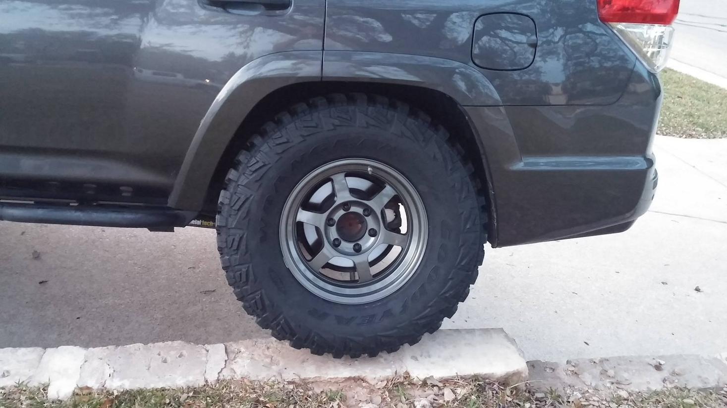

pic is with the procomp shocks on the non extended bump stops and the 33s.
It was not terrible like this, but I was dragging my bumper too much.
Another side note: with the exact same setup but 33" tires... I could easily get on the bump stop on that driveway in the pic above. Now, with the 34s it won't flex out all the way. Interesting how tire size changes everything up.

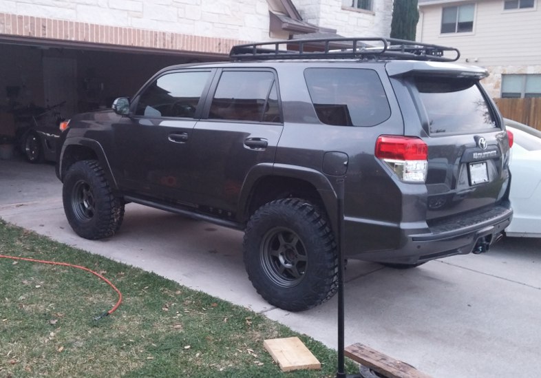

Truck's looking great! If you have a chance, could you please snap a pic from the front to show the stance with the 305's? I imagine it to be similar to someone with 33x12.5's mounted, but would be good to see for sure.

305/70:
285/75:
[MENTION=89562]bimrunner[/MENTION]
What's up with you highbeam housing?
Man does that stance have me considering 305/70s over 285/75s

LED high beams... gives is a yellow look due to the little LED thingies... Makes it look like cat eyes in the daylight. lol
Much appreciated.
My phone is toast, so I could not take any more pics. But here is another from yesterday that sort of shows the stance. I love the look....
