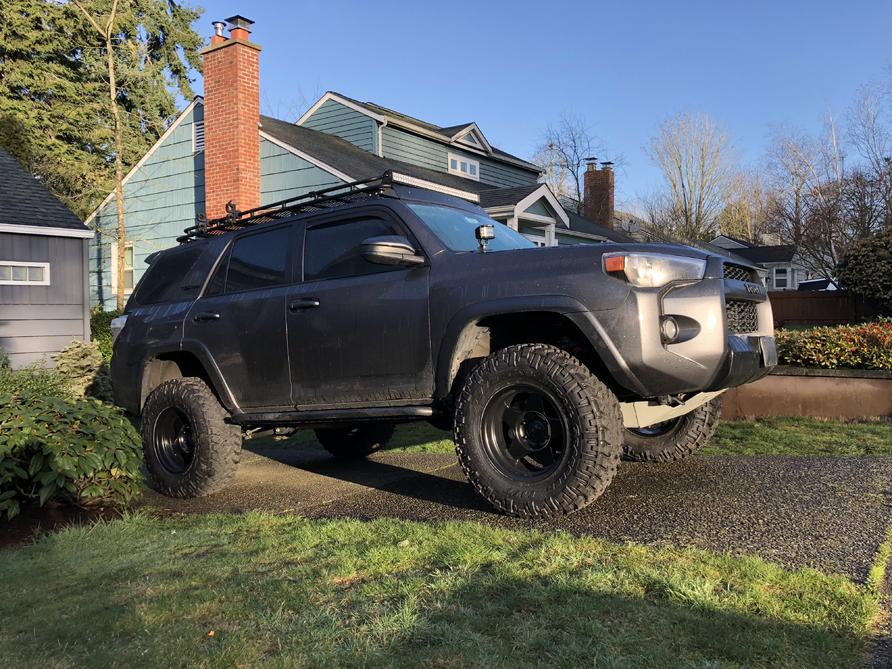

Old thread... I'm still around here.. Truck is much different now, but still on the 305 MTRs (for now). Great tires that match the truck well for what I do with it.
Still getting a little rubbing from bushing deflection from time to time when crawling up a steep ledge with all the pressure on one tire, but no big deal at all.

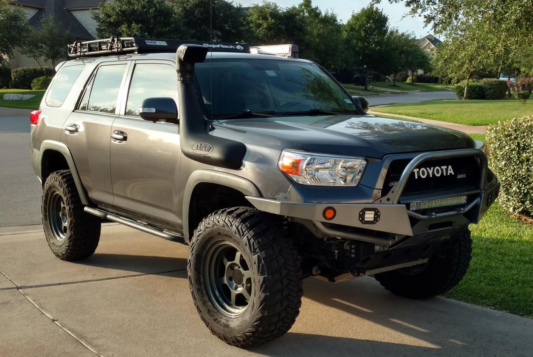

Build looks great. Came across this thread. I just put nitto trail grapplers MTRs 285/75r17 on my 4Runner. Did the BMC and trimmed quite a bit. Only point of potential rubbing when flexing is in the front on the rear fender/rocker location behind front wheel. The wheels I purchased have an offset of -38mm, which I am thinking was a mistake. Looks great tho. Haha
Your thoughts? I was thinking about selling the wheels and getting ones with less offset too avoid issues in the future.

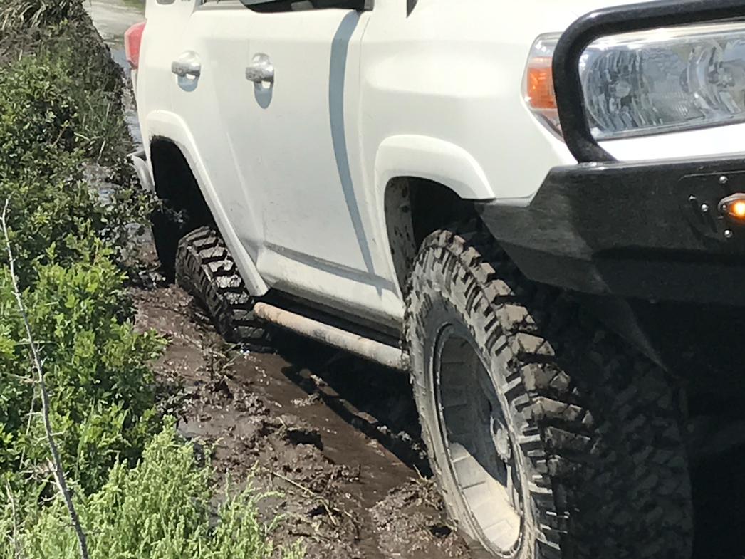

I'm about 7,500 miles into my Nitto Trail Grappler 285-75-17. Lots of trimming and of course BMC when I put them on. Excellent off-road, whether rocks, sand or mud. Only got stuck once in mud, but my fault, not the tires. On road definitely some noise, and also some slippage on curvy country roads, even dry. I have limited snow driving on them, but with zero siping I am considering getting a set of AT snow rated tires for winter driving. My truck is not a daily driver, if I was using it as a daily driver I would use AT tires.
