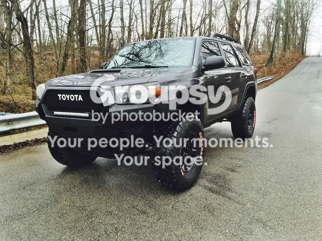

My phone is toast, so I could not take any more pics. But here is another from yesterday that sort of shows the stance. I love the look....
Thanks! It looks just like a 5th gen should tbh. Very well done.
