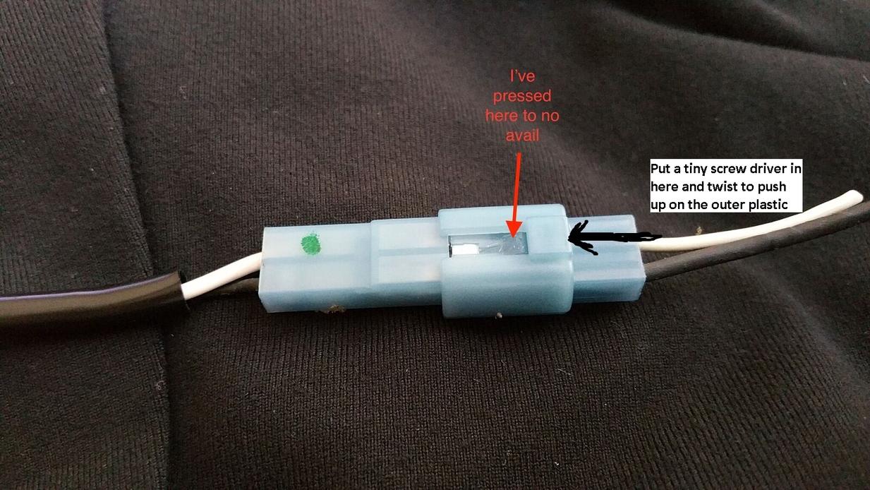

Help me disconnect this!
I HATE those connectors for the alarm system. I struggled with them many times and this last time they came apart super easy. Not sure if I loosened them up after doing them a few times, but putting a small screwdriver in the hole and prying up on it worked really easily this last time. I had both apart in 30 seconds.

You have to use a small flat head to get it apart. It's a pain, but that's how I get them apart.
you guys rock...put a smaller screwdriver in and lifted. Still was stubborn as hell, thanks for the help!
