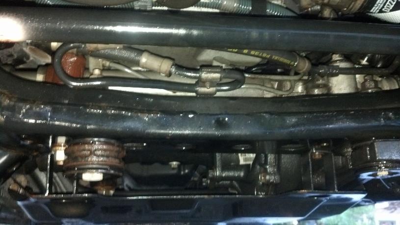

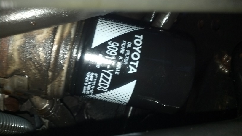

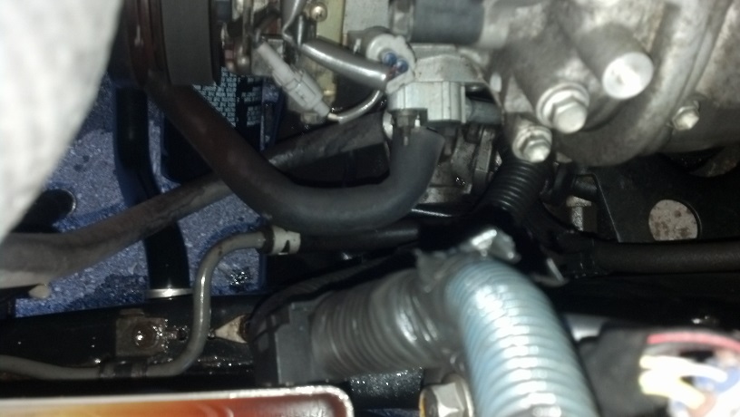

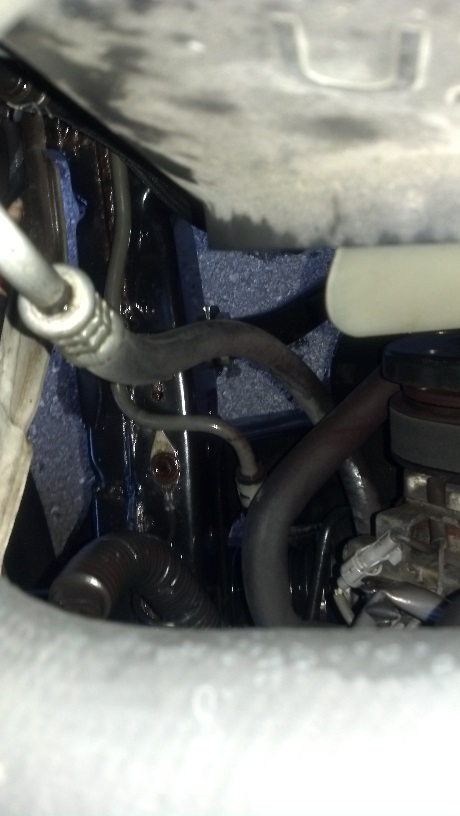

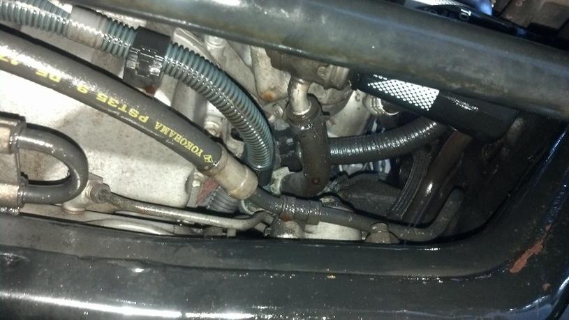

I got into my car an hour ago and the red oil light was on. I just did an oil/filter change this weekend with Mobil 1 5W-30 7 quarts and a Toyota filter. I torqued the bolt to 30ft/lbs, it's snug, and I hand tightened the filter. However today there was an oil stain on the cement. I pulled the front skid to check the oil filter, it's on there good. I cant figure out where the heck this is coming from. The top part of the engine all looks dry, down below the CVs and cross members all have a coat of oil. Any Ideas? This is great timing as I'm about to head to Colorado on Saturday. Any insight is much appreciated...I'm trying not to freak the hell out! Here's some pics...
1.) is from the front looking head on to where the skid plate would be, oil filter in the top right.
2.) is from standing by the driver side wheel looking down into the engine bay.
3.) is from under the engine bay where the skid would be looking up towards the filter.
4.) is from under the engine bay, close up near the filter.
5.) is looking down towards the filter.

Could the o-ring from the old filter still be on there?
Now that you mention it, that could be the case. I was doing my brakes when I changed the oil and didn't think to check if the Microguard o-ring came off. The thing is the filter itself doesnt have much oil on it. I just hand tightened the filter, and it was pretty snug. Should it be much tighter than hand tightened? Also, the oil filter light wont go on for things like the front diff, will it? I changed that a while ago, but the oil is all around the lower 1/3 of the engine bay, the top 2/3 is pretty dry, save for the area near the fan where it blew some oil around.
To set my mind at ease, there's not any other issue that would cause a bunch of oil to fling around the engine bay in the vicinity of the oil filter is there?

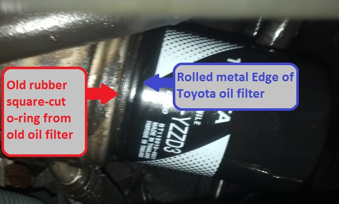

Its double gasketed, look at the picture closely; you can see the old rubber square cut o-ring between the rolled edge of the Toyota filter and the oil filter pedestal.

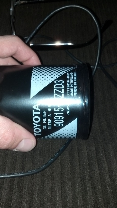

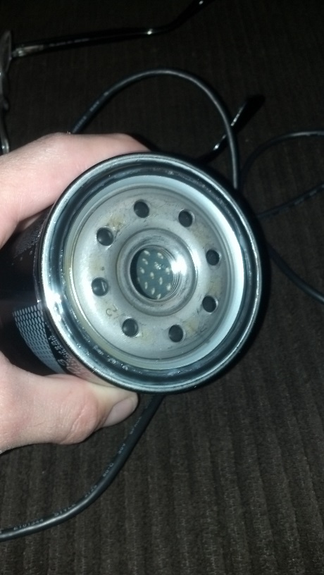

Thanks for the insight. I know what you're saying now, but is that it in the picture, or is it the metal lip on the bottom of the filter? I'll pull it off tomorrow to check for sure, and you guys are probably right. But here's the same filter unused and the lip at the bottom is all that I see in that picture.

Your picture is a bit blurry but if you look at the other pictures you posted with a fresh Toyota Oil Filter, you can see that the rolled metal lip of the filter is exactly at the end. While if you look at the notations I made on your original picture you will see there is a black rectangle between the rolled metal lip and the oil filter pedestal.
When the filter is installed correctly that lip is flat against the oil filter pedestal with no space in between like your picture shows right now.

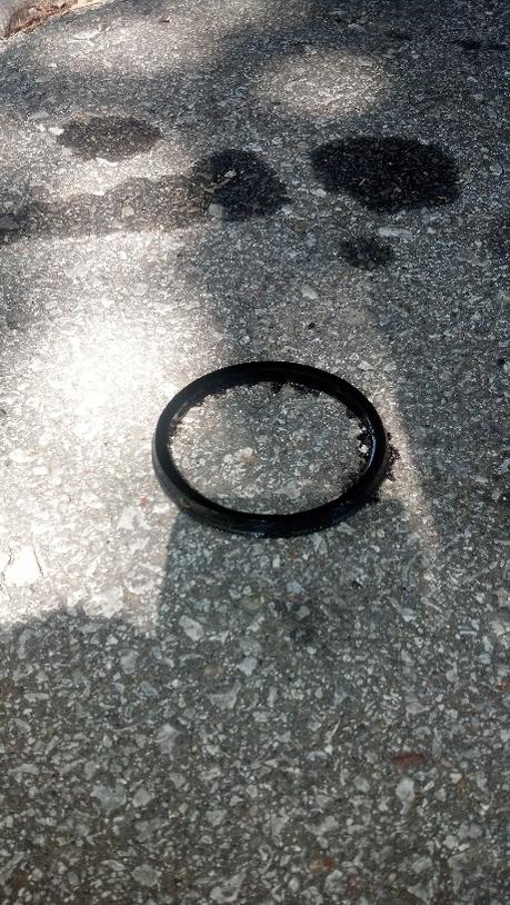

Also, you guys were spot on. The old oil filter o-ring was the culprit, and thankfully this happened before I hit the road on a 700 mile drive to Denver tomorrow, yeesh. Got the filter back on, used the filter wrench to secure it well. Drained the oil and put in 7 more quarts of Mobil 1, another $40...but better than $4000 on a new engine or whatever might have happened.
Here's the little bugger below. Hopefully this thread saves someone from the same headache I had.
