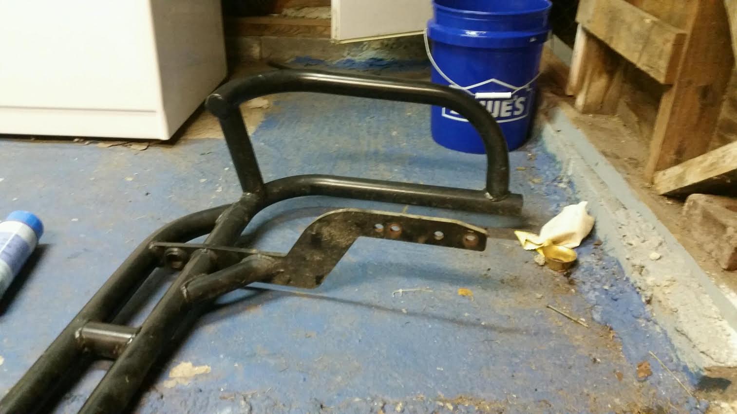

Another forum member told me to check out your build on your rear bumper. I found a pretty good deal on one made for a 2nd gen and it looks nearly identical to yours. The seller doesn't know who it's made by but it looks like the Trail Gear Rock Defense Rear bumper (https://www.trail-gear.com/TG/Rear_...r_/i_0_0_3202/_120111-1-KIT.aspx#.VCMM8fldXcI)
I was wondering what you did to your brackets and how you altered the bumper to create such a good fit.
This is the picture he sent me of the mounting brackets

Just called a few local shops and just to get it fitted for a 3rd gen, it would be around $250-$300 so I might hold off, a little steeper than I wanted to go
I have the same bumper on my 3rd gen. I didnt have to do much to mount it. I only had to cut off the brackets and slide two small shims in and weld it up.
