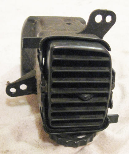

I have the same question. My passenger one has a broken blade, so I ordered an used one off Ebay. I've attached a picture of the unit, which appears to have holes on the top and bottom for screws to hold it in place. Does anyone know how to access the screws? I'm really hoping it doesn't involve dropping the entire dashboard... :shrug:
You can see in the picture there are two "snap-in" tabs on either side near the middle. I don't think you need any tools to remove them. Probably just a light pull outwards.
