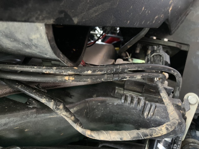

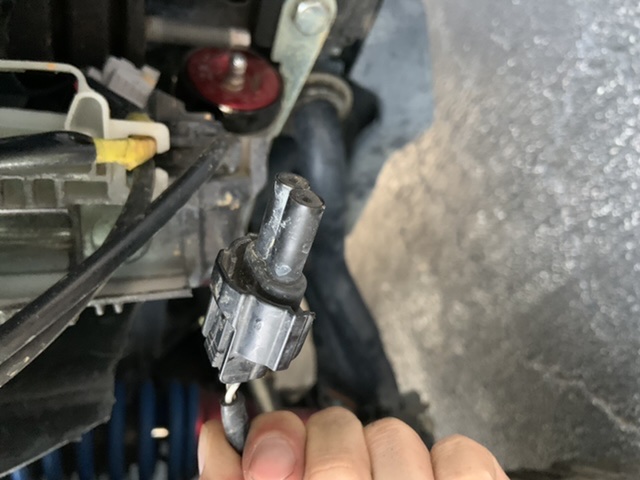

Front passenger side below the washer fluid reservoir. Found random plug hanging, but could not find a spot it would plug into.
Photos should be rotated 90 right.

I’ll double check that area again. Could not find a similar wire on the driver side. Did see some dinky wires (insert joke here) from the fog lights.
Prob because it's plugged into the back of the fog on the other side.

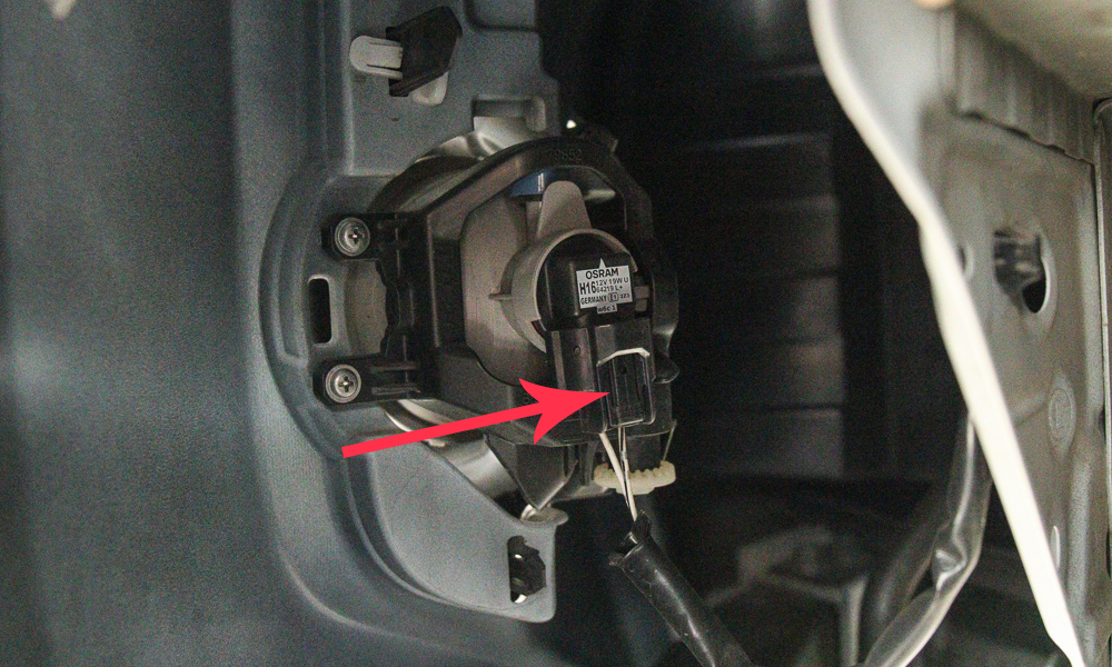

Looks to me like it snapped off the back of the fog but the male end which would be on the fog-light housing remained in plugged in.

Did you swap out your fogs and wire them to a dedicated switch? Could just be the oem loom plugged but not tied up out of the way properly.
You win! Thank you, found the torn wire. I must have snagged it on my last camping trip
