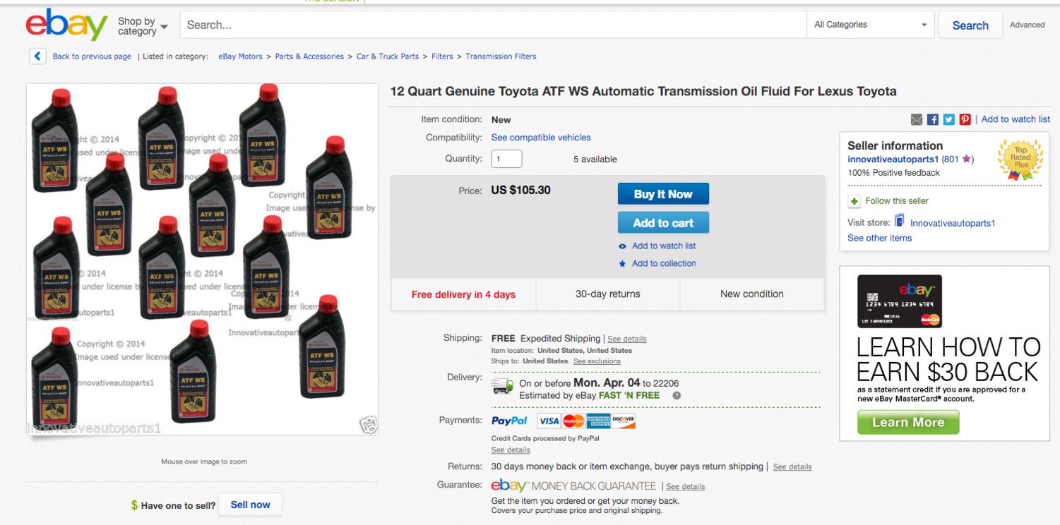

Didn't know where to share this, so I thought I would post to this old thread.
I got a case genuine toyota ws ATF on ebay for $8.75 a quart delivered.
I think that's a good deal.
FYI, in case anyone else is interested.
-Phil

If you are comparing to valvoline maxlife, that is almost double what I paid. I bought 6 gallons (24 quarts) of valvoline maxlife at Walmart for $114 out the door.
My Toyota dealer sold it to me at the discounted price that they usually charge local shops that buy parts. I think I paid around $7 a quart.
I don't like my local Toyota dealer's service department at all, but their parts department rocks.

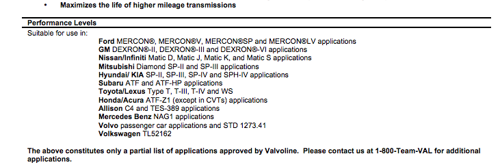

http://content.valvoline.com/pdf/maxlife_atf.pdf
...if this is not enough evidence that it meets spec than I don't know what to say.
That's exactly my point. It says suitable for "Toyota/Lexus Type!T,!T@III,!T@IV!and!WS"...
Yet Toyota says don't use WS in Type T, T III ,or T IV cars.
So I'm skeptical that one fluid can meet *All* of the properties for these types of fluids and the many others listed.
Is it close in many ways. Probably. But that doesn't mean it's the same.
I doubt it will blow up your tranny, but it's a judgement call on what you want.
For me. I'll stick with true WS rated fluid, not just "suitable" fluid. If and when there are cheaper true WS fluids available in the US, I'll buy them.
Right now the ones from Europe cost way too much in the US (they are probably imported by a person or small company and not officially distributed here), and the Mobil WS rated oil that Mobil sells in China is only available in China.
It's your call. No need to fight. But "Suitable" is not the same as saying it "is WS rated" or that it meets 100% of the WS specs. It's marketing talk for saying it's "close" or "close enough".
