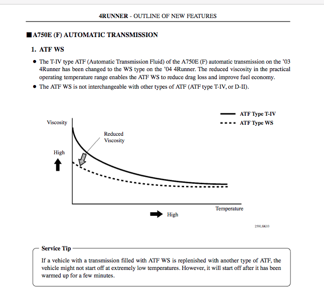

Despite ranting about NOT using alternatives because the probably aren't THE SAME as Toyota-WS, I recently discovered this from Toyota:
I found it illuminating, since on the one hand Toyota says that WS is not interchangeable with other fluids, yet, on the other hand, they seem to imply that if you do use other fluids, you may notice different shift points, especially when cold, but they don't seem to imply catastrophic failure.
To me that means that something like Amsoil or MaxLife might just be OK to use,although I still plan to stick with Toyota WS. After all, we're only talking about $100 in fluid every 50K miles or so,
plus, if I find myself in a really cold climate (say -10 F), I'd prefer that my 4Runner not have to warm up for 10+ minutes before it can go anywhere!
