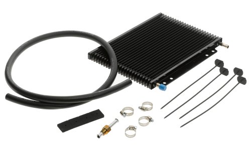

Anyone have any experience with this Hayden trans cooler kit?
EDIT: after readng this post http://www.toyota-4runner.org/2822974-post18.html I am leaning towards the Tru-Cool LPD with the internal temp bypass feature
