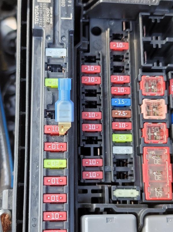

First mod on my 2020 4R TRD Pro (army green) over the weekend was a Switch-Pro 9100, with AlphaRex Nova series headlights. Install went smooth just wanted to shed some light on some info already mentioned in this thread:
1. INJ fuse tap (provided and included by AlphaRex) from headlights DRL harness -- still able to close 2 of the 3 tabs of the fuse box cover. Looks secure enough to me. I didn't modify the cover at all.

Update:
Ensure you add an extra 5amp or 10amp fuse into the fuse-tap when tapping into the INJ fuse slot in the fuse box (ie. place existing 10amp fuse from the INJ slot into the fuse-tap and add another 5/10 amp into the second slot of the fuse-tap). My positive and negative wires from the Nova headlight DRL harness is connected directly to the battery. Now the DRL bezel led works and is on when the headlights are in the "off" position or in the "AUTO" position (during daylight)

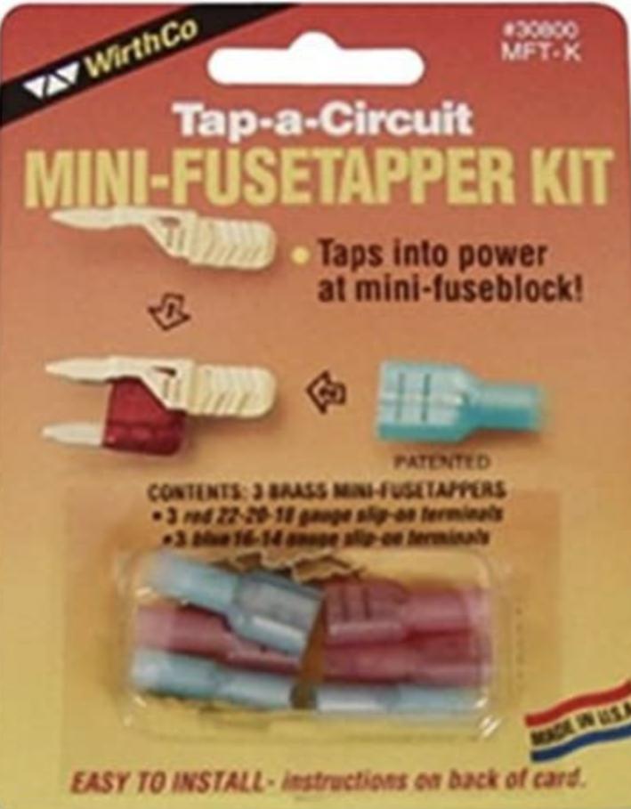

Not ideal but should work. 8 bucks on amazon...mini tap
