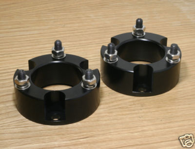

Just to clarify, there are spacers that are installed into the front strut assemblies and then there are spacers that are installed on top of the strut assemblies. The ones that go on top DON'T compress the coils, while the ones that get installed into the struts DO compress the coils. Obviously manhunter was talking about the traditional ones that go inside the strut and jeremyH was talking about the ones that go on top.
Top spacers still require taking the strut assemblies apart so you can replace the short stock upper bolts with longer ones that will go all the way through the thickness of the spacer and still have meat to get the nut on at the top. Recently Daystar has come out with spacers that go on top and don't even require taking the struts apart to put longer bolts in, but AFAIK they don't make them for 3rd gens yet, just 4th gens:
Daystar Toyota 4RUNNER 03-08; 2-1/2" Lift Kit "Full Package"; KT09115BK
These are better than traditional ones because they do not compress the coils at rest (like all top spacers) but they're also way easier to install since there's no disassembling of the struts. To the OP: Since it's just for looks, I would really just suggest a 1" or 1.5" body lift from 4crawler.com instead of the spacers and some meaty 265/75R16 M/Ts (basically 32s). If you want 33s, then you'll have to get a 2.5" lift and I think ALL of those are the type that have a spacer installed into the strut which will compress the coils. In other words, the top spacers aren't offered that thick, they're like 1" or 1.5" and most likely will not allow you to get 33s on.
Not sure if Daystar makes them but a guy on ebay sells them. Again, not sure of the quality but they looked fine to me. I guess the bolts could snap but if you were worried you could get higher grade bolts.
I will not be doing much offroading and was just looking for the cheapest solution without doing a bodylift. You do not need a spring compressor to install these.
