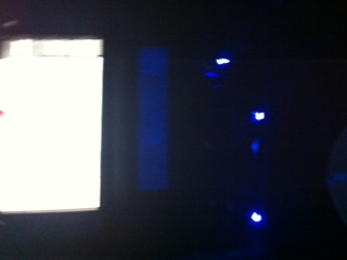

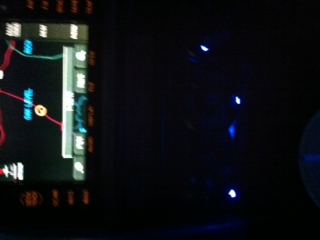

Ok maybe someone can point me in the right direction. So this is the first time that I've driven at night since I got the truck running again and I noticed that none of the LEDs that I replaced are turning on (expect for the arrows, the ones when you press a function on the HAVC unit). The LCD displays all information, so I know it works and when the lights are off I can see the blue lights in the background but when I turn the lights on, none of the HVAC unit LEDs turn on. I'm thinking that it could be a fuse but I'm not sure which one to check first. If it's not a fuse, then I'm thinking it could be the circuit board but I'm not sure. Has anyone else had this issue or know what it could be. The first picture is with the lights on and the second is with the lights off.

Anyone, any thoughts? At best I have to change a fuse, at worse I head to a junk yard to try to find a replacement HVAC unit. I want to avoid the dealership but will probably head that way towards the end of the week.
Hey guys, I've been out of town for a while and have recently returned. I noticed that I am still having the same issue (shown above) with my HVAC cluster, so I'm resurrecting this post. I checked all of the individual LEDS and they work, so I'm wondering if there might be someone on here that has seen this issue before? The backlight on the LED turns on when the lights are off but when I turn the lights on, the LED turns off. The only lights that work at all times are the indicator lights that (the little arrows). Anyone have any suggestions?
