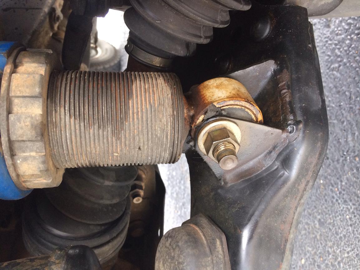

Been lurking here for a while, and recently bought a 02 sr5 4x4. My suspension is making a loud knock when I hit bumps. I think this bushing is completely gone. Any help on what is, and tips on fixing it would be greatly appreciated.

You will need to remove the front strut assembly and replace the shock bushing, possibly the whole shock if the bushing can't be done by itself. If you need to replace the shock on one side I'd suggest just doing both.
Google or search here, how to replace suspension.
A mechanic can also do this pretty cheap.

In addition to the above it might be handy to know what the brand/type of the coilover you have there. Perhaps that manufacture sells replacement bushings?
just change the bushing, no need to replace the whole shock. any parts store will have the replacement bushing, either press the old bushing out or just torch it and clean it, then with a little lube press the new bushing in
DON"T torch the shock. It contains compressed gas and it will blow in your face if you try to heat a shock absorber.
Use a proper sized box socket to press out the old bushing. If you can find an OLD TOYOTA strut bushing, that might work. To install the bush, you can use a box socket that fits right on to the outer metal ring. Don't force the bush to slide into the shock by the center metal ring.
That strut looks like it's seen better days... Just my .02 but if you are going through the hassle of replacing the bushing why not replace both of the struts and be done with it?
The shock bushing is bad so it's good you found that, but the loud knock when hitting bumps could also be a broken swaybar end-link. Keep that in mind, as that what was bad for me when I had the same symptom.
Thanks a lot guys. I've got a friend who has a shop so I'll take it by tomorrow. Also I've never posted a picture of the truck, so here it is!
