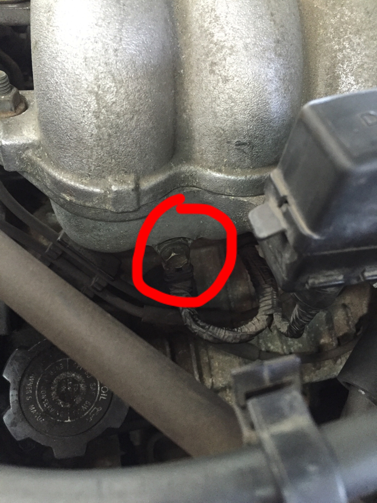

If anyone experiences this problem, check the ground on driver side of upper intake plenum. Several vehicles checked have had this loose causing the p1126 fault and a new/used TB doesn't fix it.
Checked that ground wire on the plenum as described and it was loose. Tightened it. I'll report back in a few days to see if it's a definite fix.
So it's been about a week. No further problems, no codes, no nothing. So far so good. Saved $2200 from giving to the dealer.
