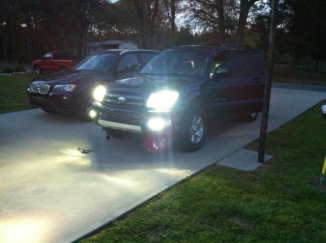

I bought the 6000k kit from DDMtuning.com BEFORE I did my research about the whole projector/reflector housing set ups. I had just purchased a new car and talked to some guys at work who had used DDMtuning before and I "wanted what they had" type situation.
Unfortunately I later found out they all had 2006+ model toyotas (with projectors) and mine was only a 2003 with reflectors. So with that in mind I did not INTENTIONALLY have this outcome, but since I had paid the $40 for the set I figured I'd see how they looked anyway.
I do plan on eventually doing a 2006+ housing swap or a retrofit, but for now I dont think they look to awful. They do not look to have too much of a blue look like everybody says to be a 6000k IMO.
Also this pic was taken with a iphone so its far from perfect. I do realize there is some glare in the picture, but none that can be seen with the naked eye.
I have tested the functionality of these HIDs in every way possible to try not to blind fellow drivers on the road. I have driven behind my wife's Maxima, passed her oncoming, passed her stand still, etc and neither of us think that they are too much.
Dont get me wrong, they are bright, but nothing thats going to run somebody off the road. I have NOT adjusted them down yet. I will adjust them down if I start to see people flash me or people start throwing up hands in front of their face as I drive by. But as of right now I have had them in for 7 days and I do 90% driving at night as I work 3rd shift. Not one single person has flashed me yet.
I do realize that the flamers will bash me in every way for not using projectors but IMO its not as bad as everybody says. Im sure it all depends on the height of the car, size of the housing, style, etc that makes some cars just blind the S*#t out of people, but the 4th gen 4runners dont seem to be too bad to me.
Like I stated before I had already spent the $40 on the lights before I learned all the information and Im not a big fan of wasting money. I put these in just for a simple test and honestly think they will be fine, even without adjustment. However if it starts to be a problem I'll adjust them down and eventually move up to projectors.
Edit: I did use the 35w and 6000k kit from DDMtuning.com. As people previously stated you lose usable light as you go up in Kelvin color. So maybe since I have a lower wattage light and a higher temp the glare and stray light is reduced. IDK but I know my lights do not look BLUE or PURPLE.
