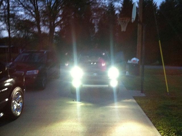

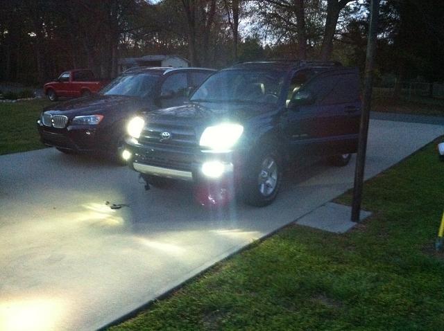

I have posted 2 pics of 6000k (cheap ones even) from DDM tuning $40 and I have yet to find anyone saying "those are blue" and certianly not purple.
Please adjust the gamma on your 1975 IBM computer I think your color scheme is a little off.
Then post us some 6000k purple lights Im literally about to pee my pants to see this.
