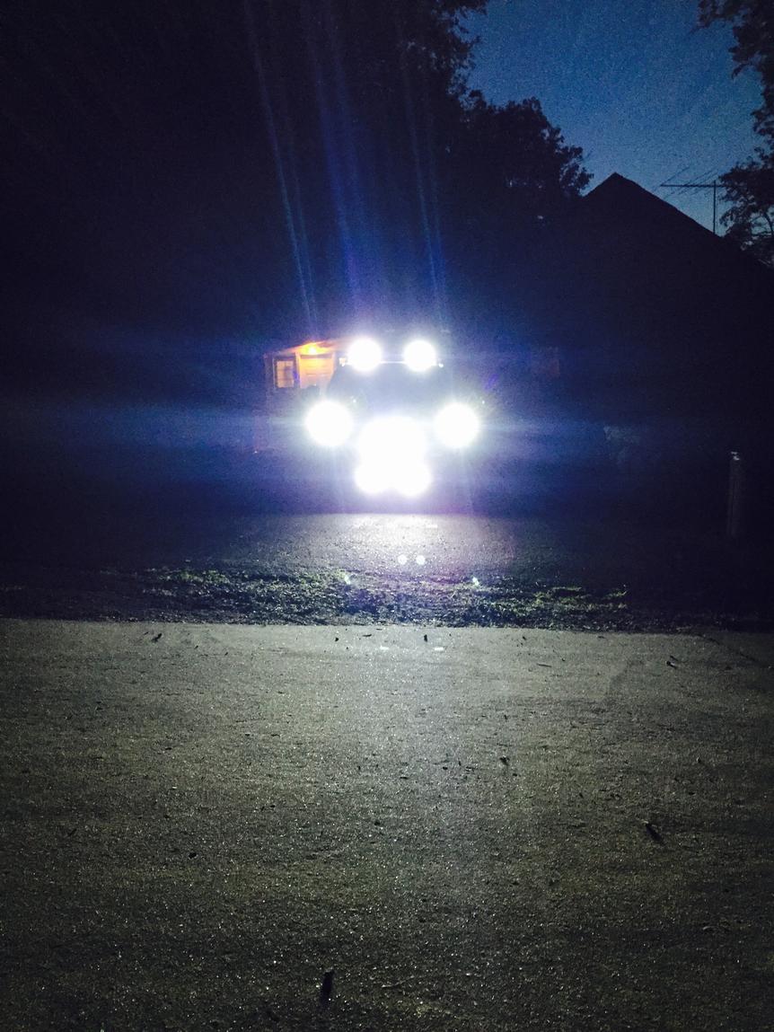

This is my 2006 4Runner. All LEDs in the front end. Got a couple extra lights tho lol
