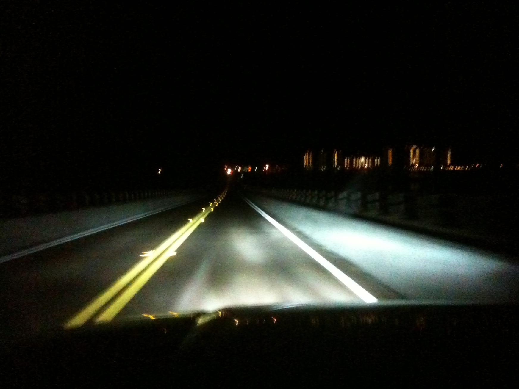

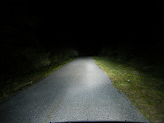

I have a 35w 6000K kit and in my original 97' housings they dispersed the light evenly but my housings had mud and condensation inside so I opted for the nice blacked out crystal type but they are horrible for HID's. They throw the light in a scattered pattern. Next I'm going to do the projector retrofit and throw this kit in a set of 8" off road lights.
DO NOT get any kits from Ebay that claim to be hi/low HID. They must be "bi-xenon". That means the shield is moved to direct the light higher for high beams. The bulb doesn't get any brighter and they're not dual filament. The ones I have now are dual filament with the high beam being a ****ty halogen that never gets used.
Here's the kit I'm getting soon. H4 9003 HB2 Bi-xenon projector HID CONVERSION Kit Hi/Lo - $149.99 : Car Parts Lights
35W/6000k factory 97 housings
same kit in the crystal housings

Jon- Those links don't work. I am interested to see the HIDs in the newer housings though. Have you tried to aim them?
