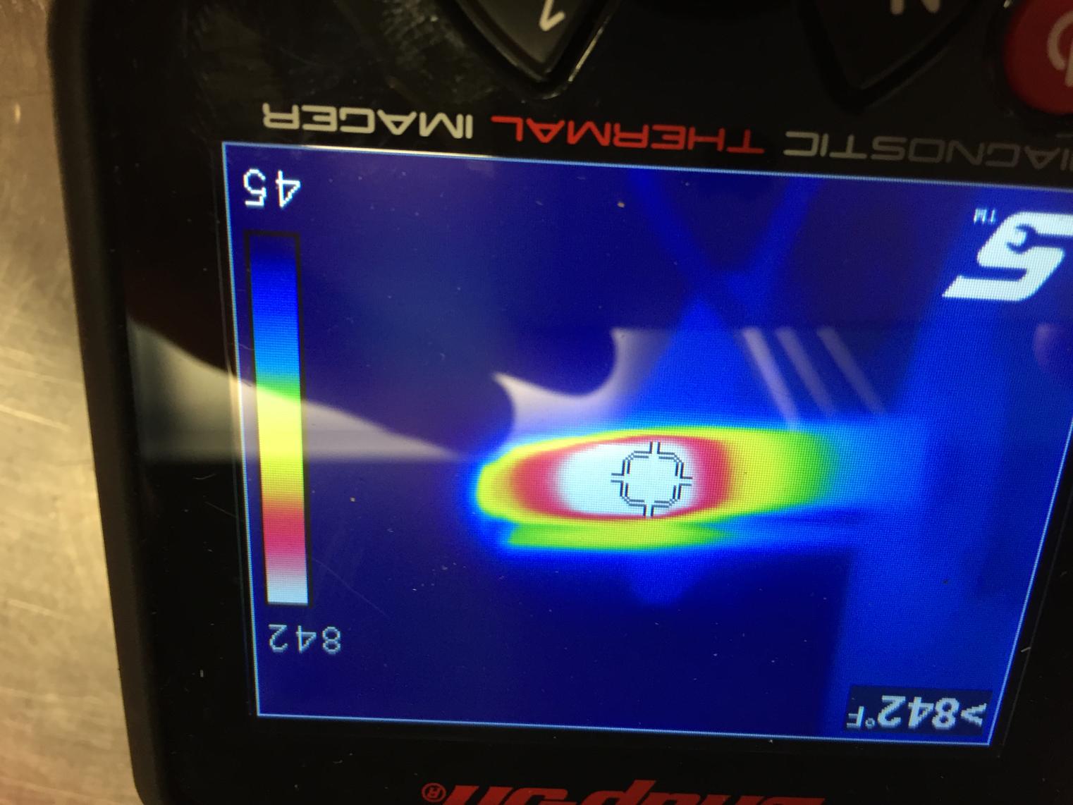

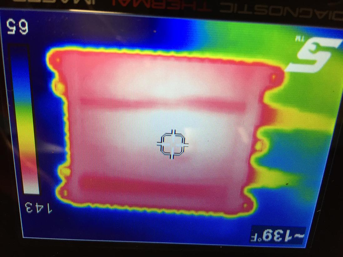

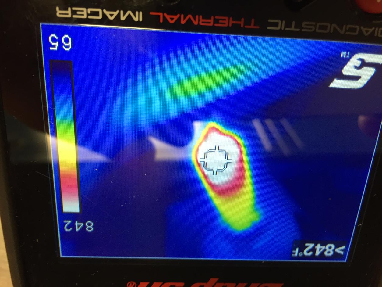

I used a thermal imaging camera and tried to run a halogen h11 and my xenon side by side and found both maxed out my thermal camera ( over 846 degrees F ). I then did some research and hound Halogens run around 1000 degrees F and xenon bulbs ARE SUPPOSED to run cooler but with aftermarket kits is hard to tell and there is no guidelines. Most Chinese kits actually run hotter!

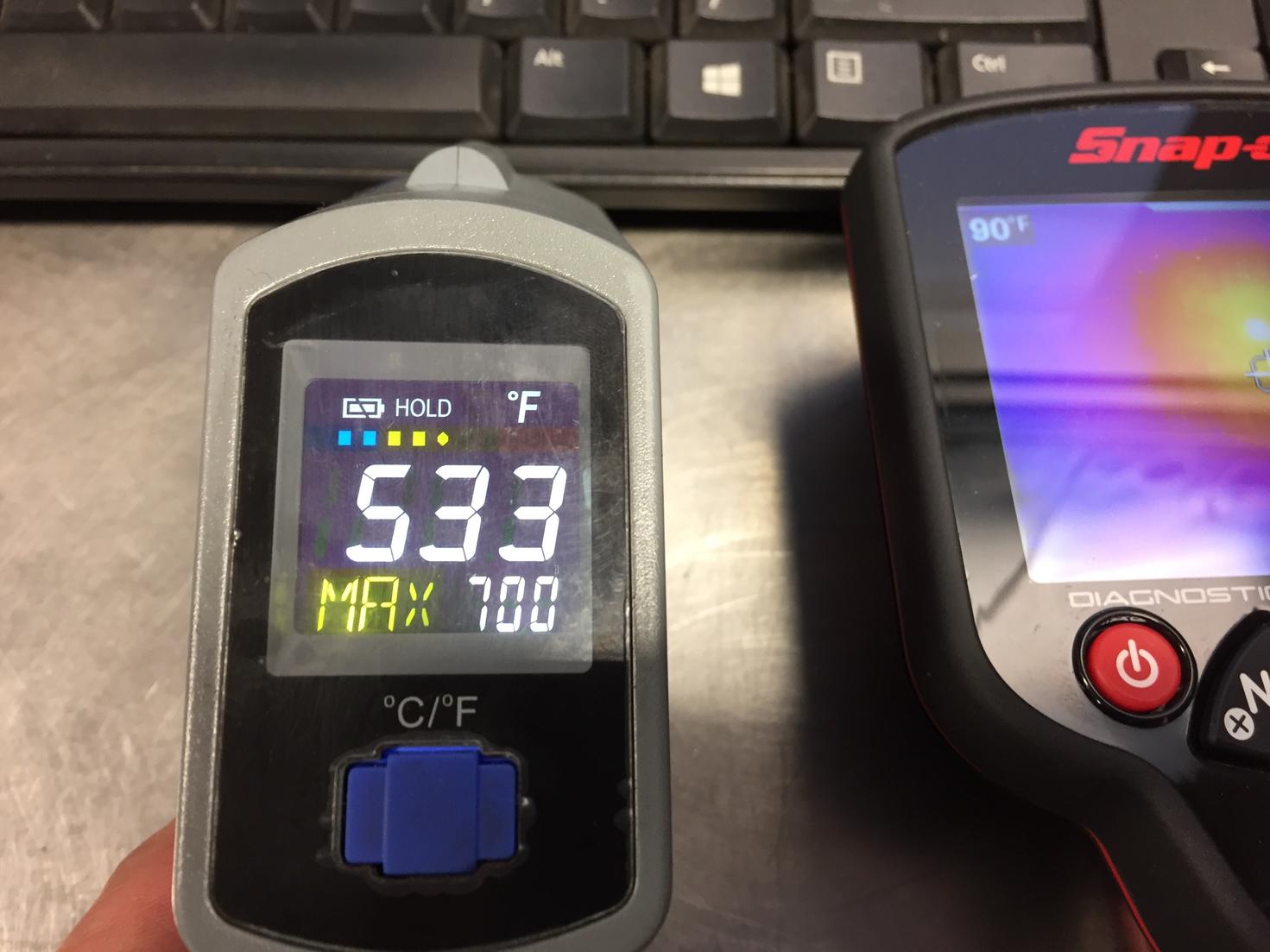

I used a temperature gun and got a reading of 1006 on the halogen and maxed the temp gun at 1400 on the xenon. I found that actual arc temperature runs between 2000-3000 degrees F depending on bulb and wattage/voltage.
I then got concerned by the sheer amount of heat POURING off the xenon bulb and got very concerned about melting my headlights and possibly starting a fire. The inside of the headlight appears some type of plastic but I found melting points and ignition points of MANY plastics and found they were nowhere near the temperatures I was getting.
I would advise anyone getting ready to install a HID kit to do a little research first. I ask what company should I go with? I'm leaning towards mormoto but can't find any hard data on how hot their bulbs run. Has anyone melted a headlight here? Anyone have ALOT of time running Morimoto? Anyone keep their HIDS for a few hours at a time? What is the best company? according to consumer opinion it's Kensun and Apex ( rated #1-2 ) all over the Internet which I have found through research and testing to be crap.
I have tons of pictures of my thermal camera readings, temp gun readings, various charts and other random stuff but 8 pictures is my upload limit.

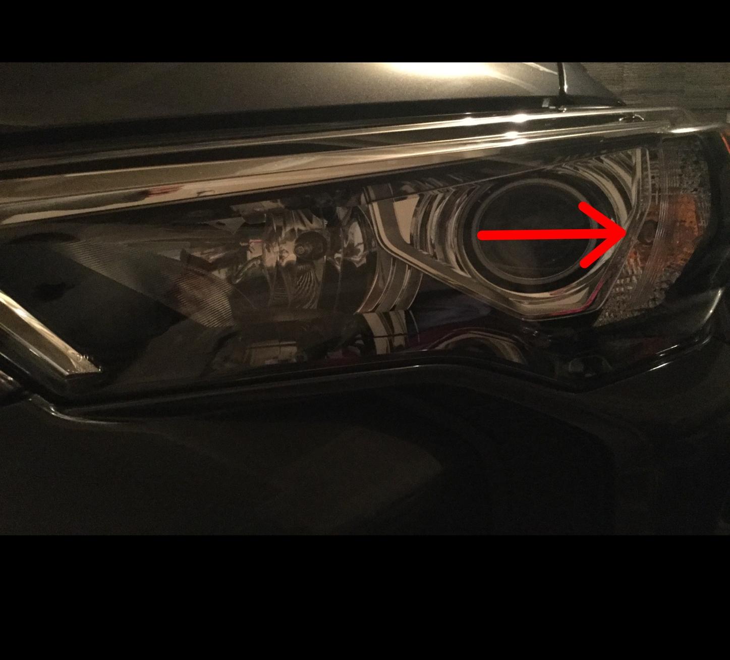

First picture shows how the bulb sits inside the headlight.

Third pic is the HID bulb maxing out the thermal imager
4th pic is halogen also maxing out thermal imager

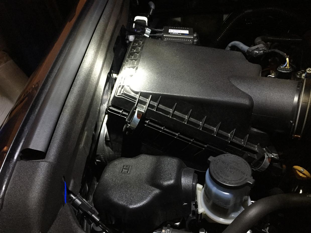

5th pic is ballast
6th pic is temp gun that shows max 700 reading I got off the BASE of the xenon bulb. Arc temps can be 2-3K degrees!

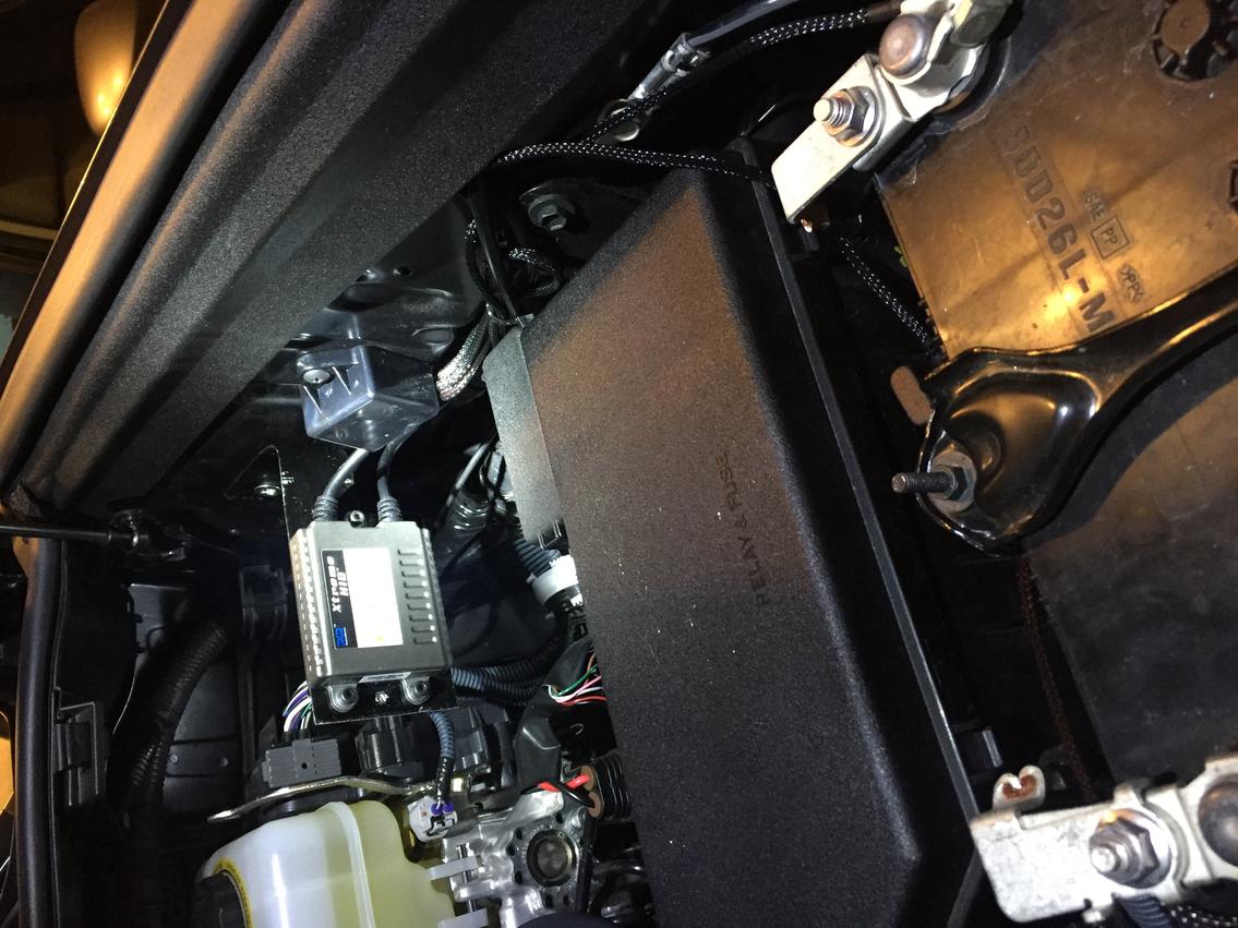

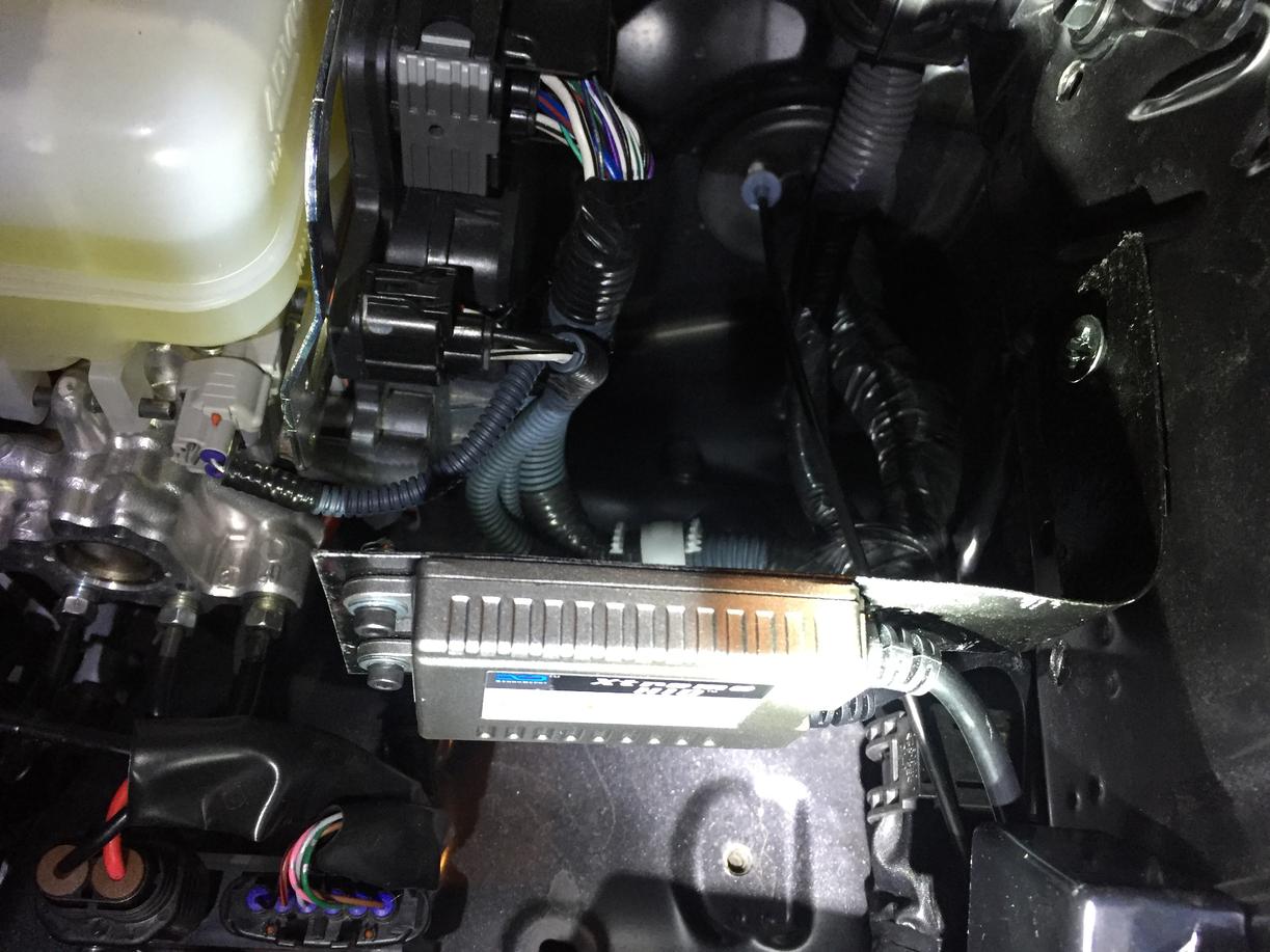

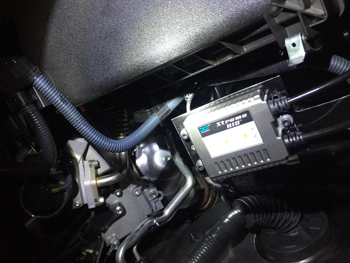

Ordered the XenonDepot kit from a lot of advice here. Philips 4300K option

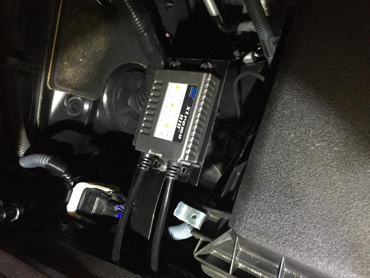

Kit looks pretty nice, lots of crap to find spot for though!
I wasn't a big fan of the double sided tape for the ballasts so I made some brackets. Other than that the look pretty good
The lights seem a little more yellow than I was expecting especially the drivers side...thinking they will burn in and may change to more white with use?
Anyways here's the install pics, I'll update after a few thousand miles, hopefully I can steer someone on the fence one way or another
