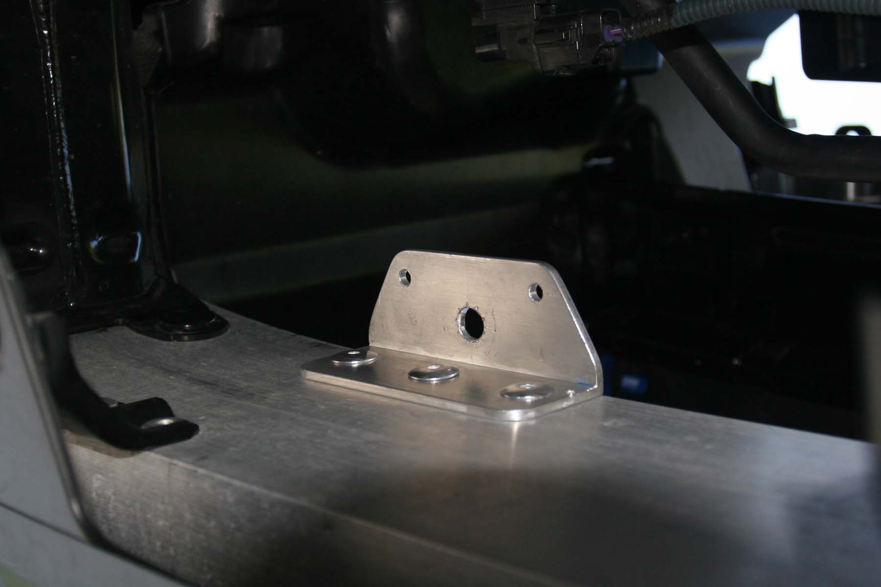

How did you attach the bracket for the lights? I looked at the aluminum hollow front bumper and not sure how to bolt anything to it. Did you drill and Tap it or drill through and use long bolts?
. . . I looked at the aluminum hollow front bumper and not sure how to bolt anything to it. . . .
No bolts here. Three-sixteenths blind ("Pop") rivets hold the easily-made aluminum bracket to the hollow aluminum bumper.
