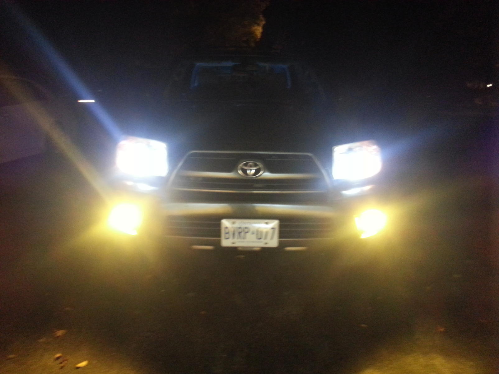

Hi - I'm running the xenondepot hid extreme kit in my lowbeams (5000k). I think it was $150 during a sale.
I am also running a ddmtuning 35w 3000k kit in my fog. It was $40.
Both work fine after about a year. The ddm tuning kit balasts looks the same as the xenondepot but I do believe xenondepots are better.
My ddmtuning kit sometimes only turns on one bulb if the fogs are switched on during starting. I guess due to the decreased voltage. I just flip them off and on again and they work. My xenondepot lows always turn on fine.
I also bought wiring kits for both sets. I had to replace the relay in the dmm tuning wiring harness. I think it was my fault though as it for wet, salty during winter and rotted.

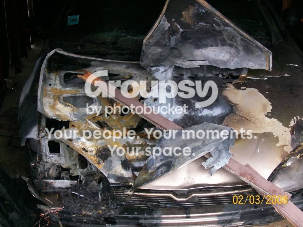

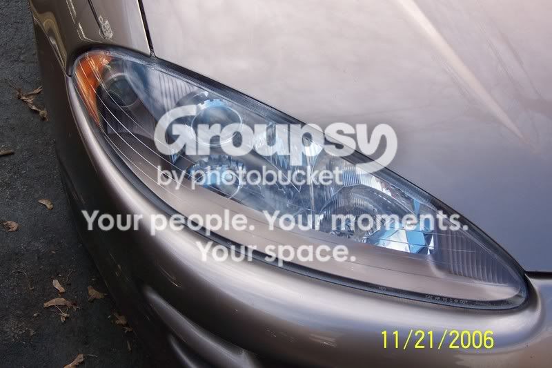

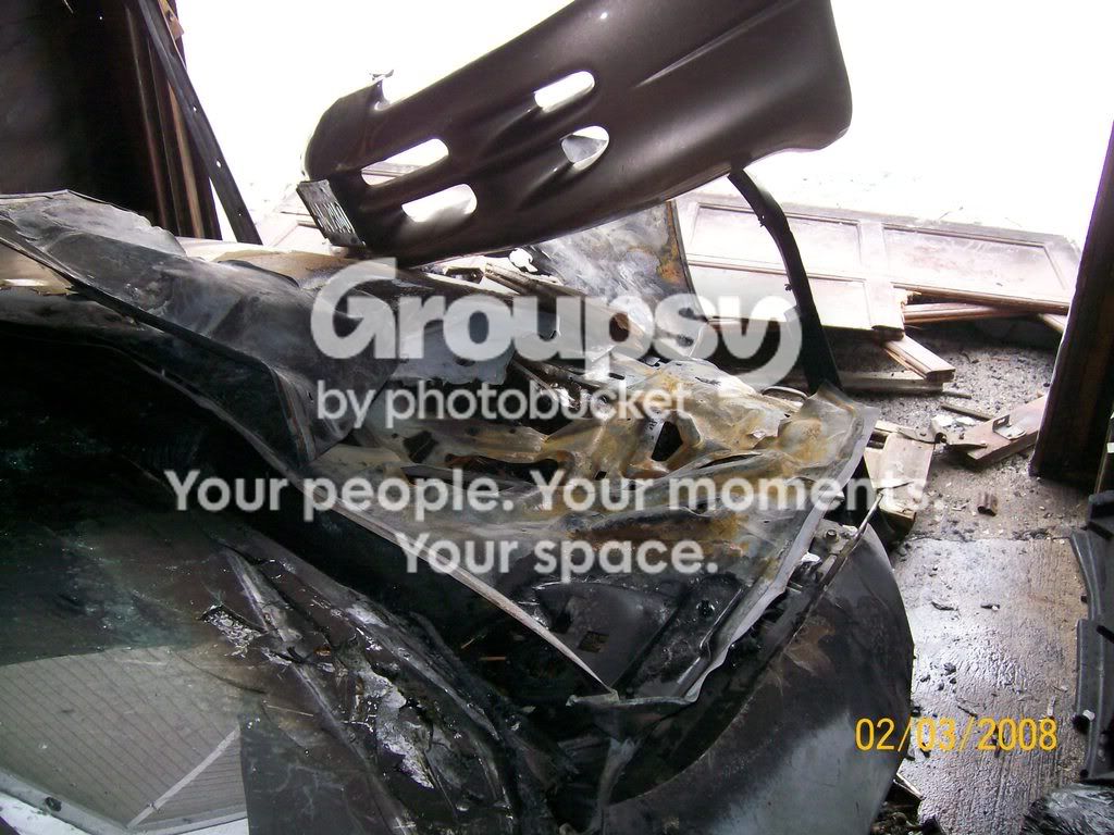

I had a retrofit completed by company with great reviews and from HiDplanet did a great job for the most part, the relay harness tho went crazy and well the end result (see below) concluded by investigators and the fire department to be a issue with the harness and relay some how shorting out..
From this
Picture004.jpg~original
To this
Picture001-2.jpg~original
Picture006.jpg~original
