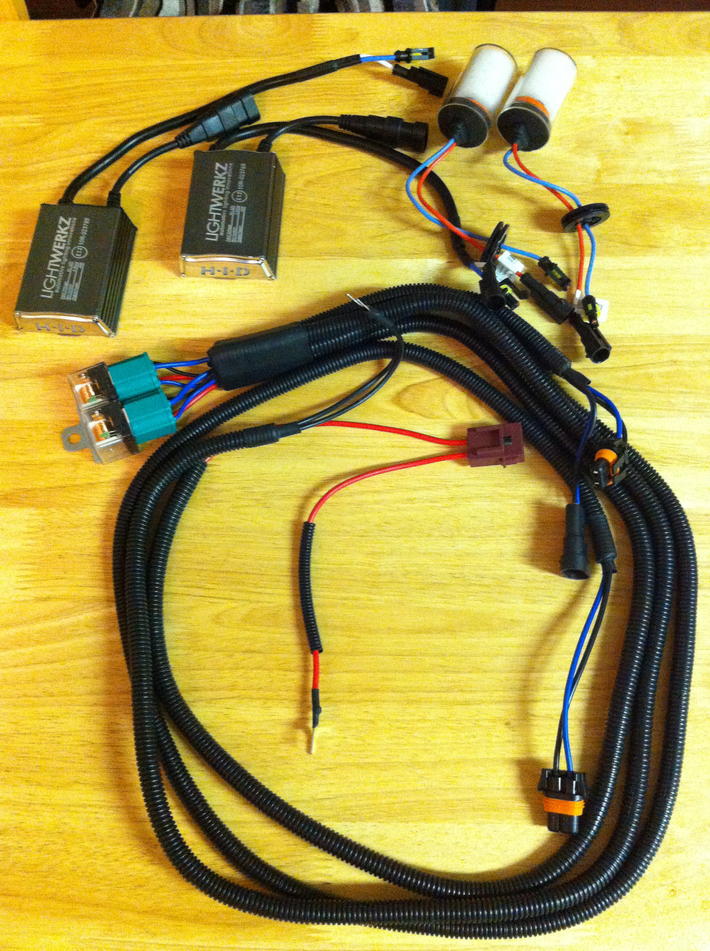

I just installed Lightwerkz for my low beams $135 shipped, and DDM for my fogs $50 shipped.
I really liked the kit from Lightwerkz it included wire harness but that is the way to go and its good quality, plus I got it in 2 days. EASY INSTALL.

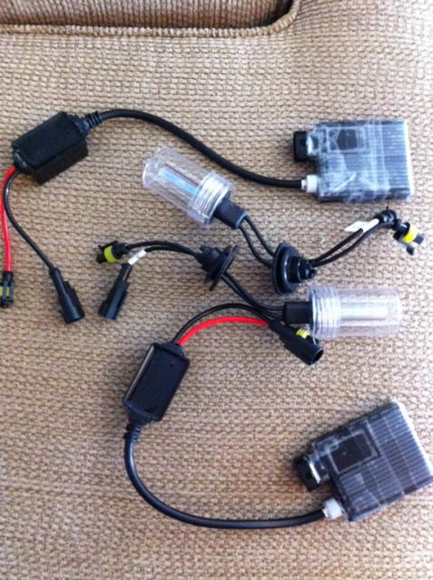

The second pic is the DDM after I wrapped them to better water to proof them. You could see into the ballast I didn't feel they were water tight and they went by the fog's so I wanted a good seal. But see how the plug for the factory light connection is right in the body of the ballast. This leaves no room for the factory plug to clip on and make a connection. Any better quality ballast has a wire attached to the plug, not just part of the ballast body.
When it comes to you low beams don't go cheap it's not worth it in my opinion.
