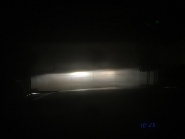

Installed a Xenon Depo kit on the driver-side yesterday, Extreme ballast with Philips 4300k bulbs. I'm particular with lights so wanted to see them side by side. For comparison, the passenger-side is a Sylvania Silverstar Ultra bulb. I'll preface this by saying I've never been a fan of HID's in non-HID housings, in fact I've often been a vocal critic of it. With all the positive feedback regarding the 5th gen projectors though I decided to give it a shot, knowing I could sell the kit if I wasn't happy.
Overall there is a noticeable increase in output. I'm not terribly impressed with the cutoff of these headlights, even with halogens. There is an increase in intensity above the cutoff with the HID but doesn't seem unnecessary so. That is, it's about what I'd expect with an overall increase in output, so that's saying something about how these stock projectors handle the HID. Is it enough to cause problems for oncoming drivers I don't know yet, but my initial reaction is it's probably OK.
I plan on installing the other side today and running them for a month or two to see how I feel after driving with them for awhile. I retrofitted bixenons into another vehicle and compared to the 4Runner it's like driving with suns attached to the bumper, however there's something to be said for the simplicity of keeping it plug and play. Hope that helps anyone on the fence.

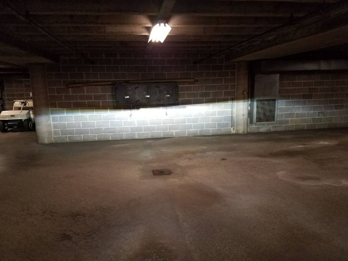

I'll just leave this here. Just got my IS350 retrofit finished, not the best pic (cellphone), taken in my lighted parking garage about 30' from wall. Dramatic improvement over stock - especially width.

The light above the cutoff is expected as that is the design of the projectors to help with road signs from what I understand. With the HID being brighter then there will be more light above the cutoff but I don't think it's enough to cause any issues for oncoming traffic. With the amount of installs we've had with the 4runner over the years, the feedback has been great.
Having said all that, would love to hear what you think after an extended period of usage.
