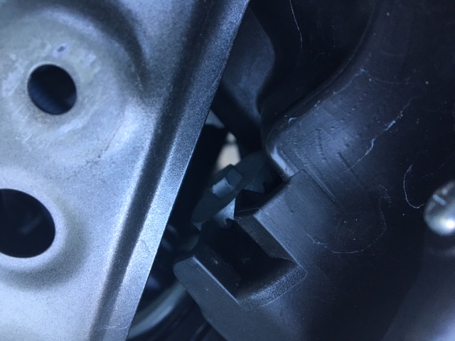

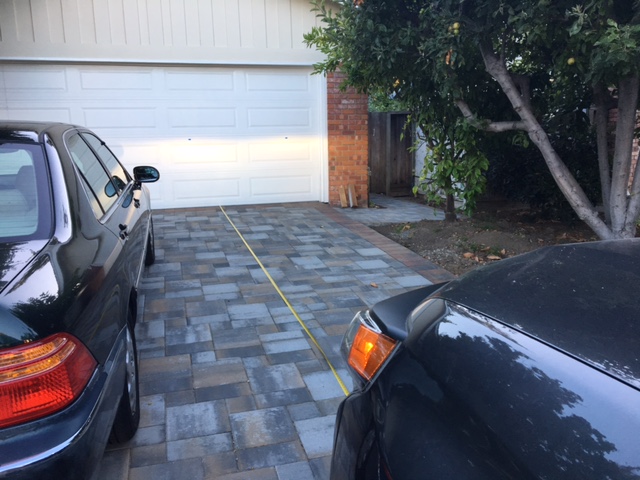

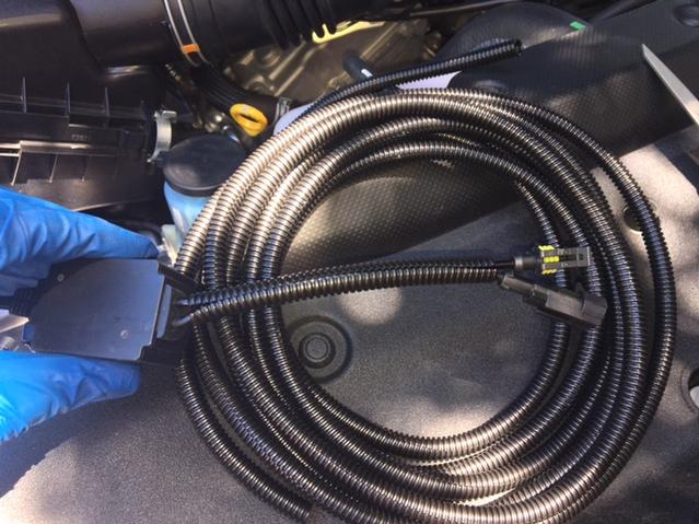

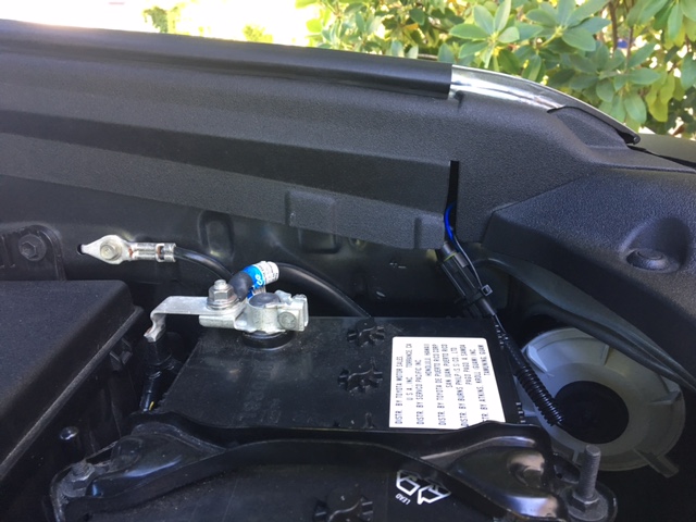

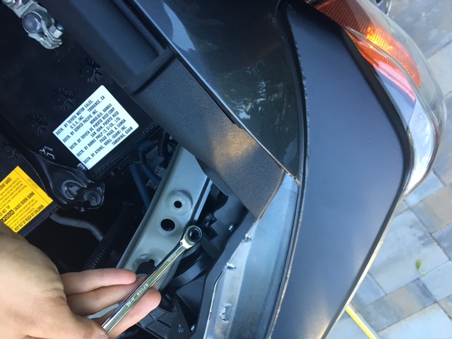

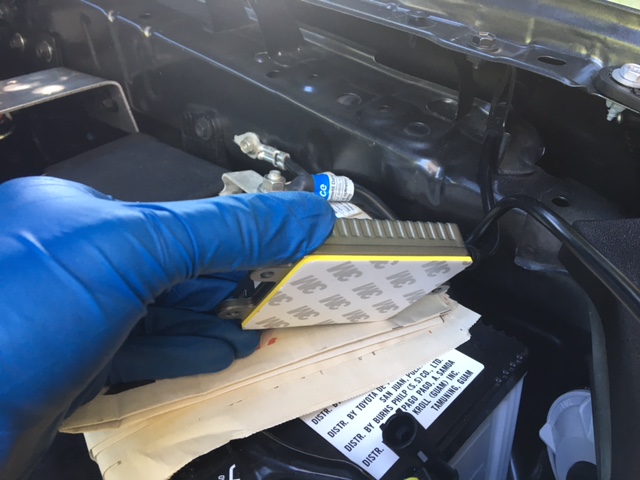

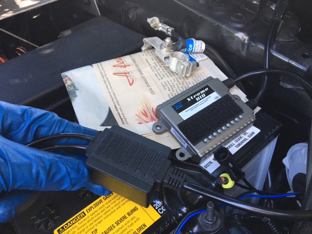

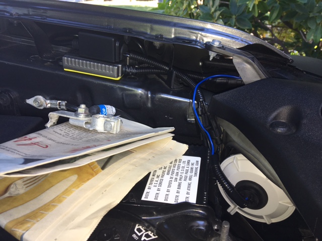

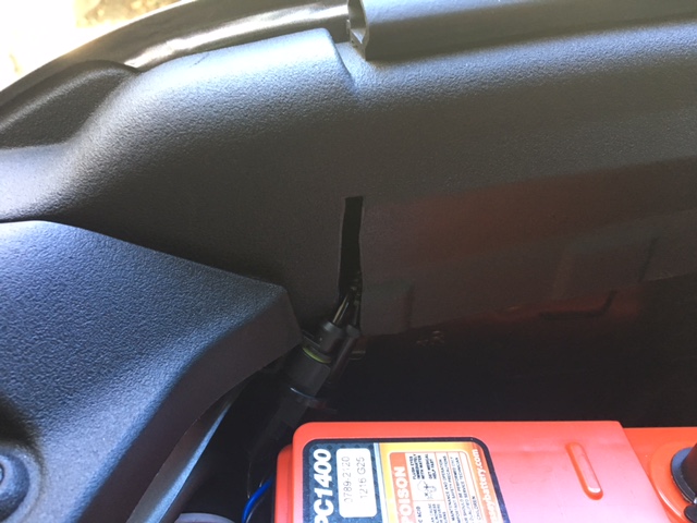

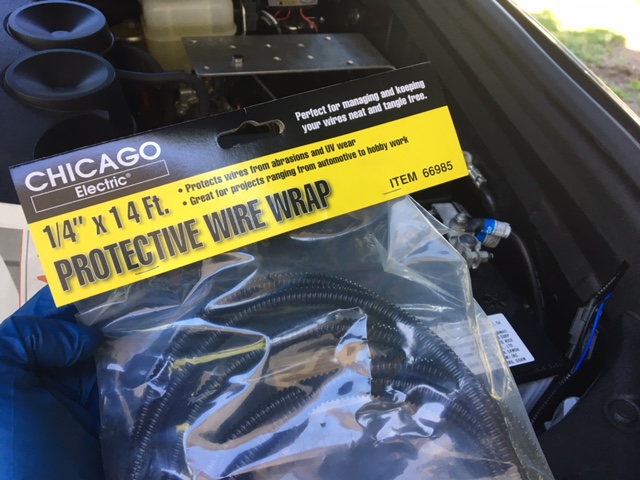

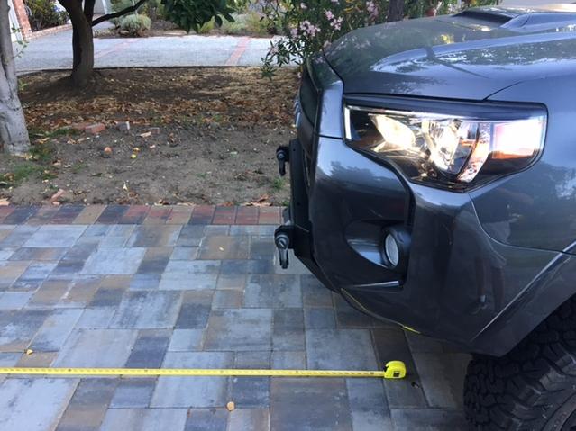

I love 'em! I did a clean install under the fender side skirt trim, added wire loom protection and Velcro tape to keep the ballast and wire harness box together. Used the 25' method against the garage door for initial adjustment, then refined it after a quick drive around the block. It's a tad lower than my brother's TRD Pro OEM headlights so I may raise the beams just slightly but very happy with these lights. One of the best mods to do since the OEM halogens don't cut it IMHO.

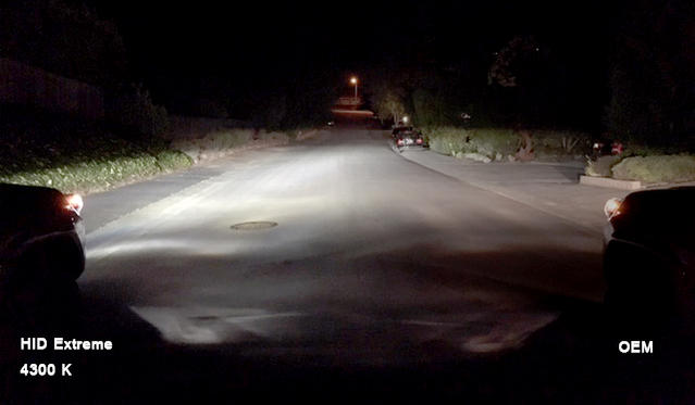

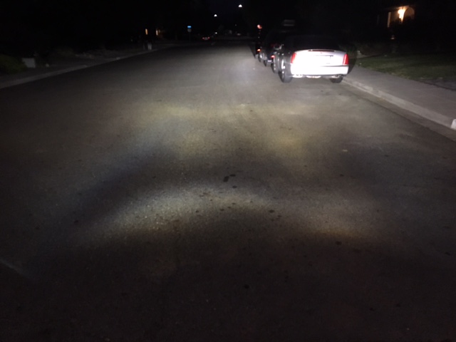

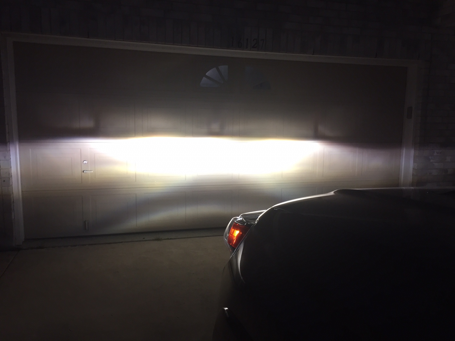

compared the HID Extreme kit (Left) to OEM headlights (Right). The beams are slightly crossing into each other but you get a good idea of how bright they are. Also, with the HIDs on - when turning the fog lights on, it almost does nothing as the HIDs light up the foreground very well on their own. It's like having the fogs and headlights on without actually having the fogs on.

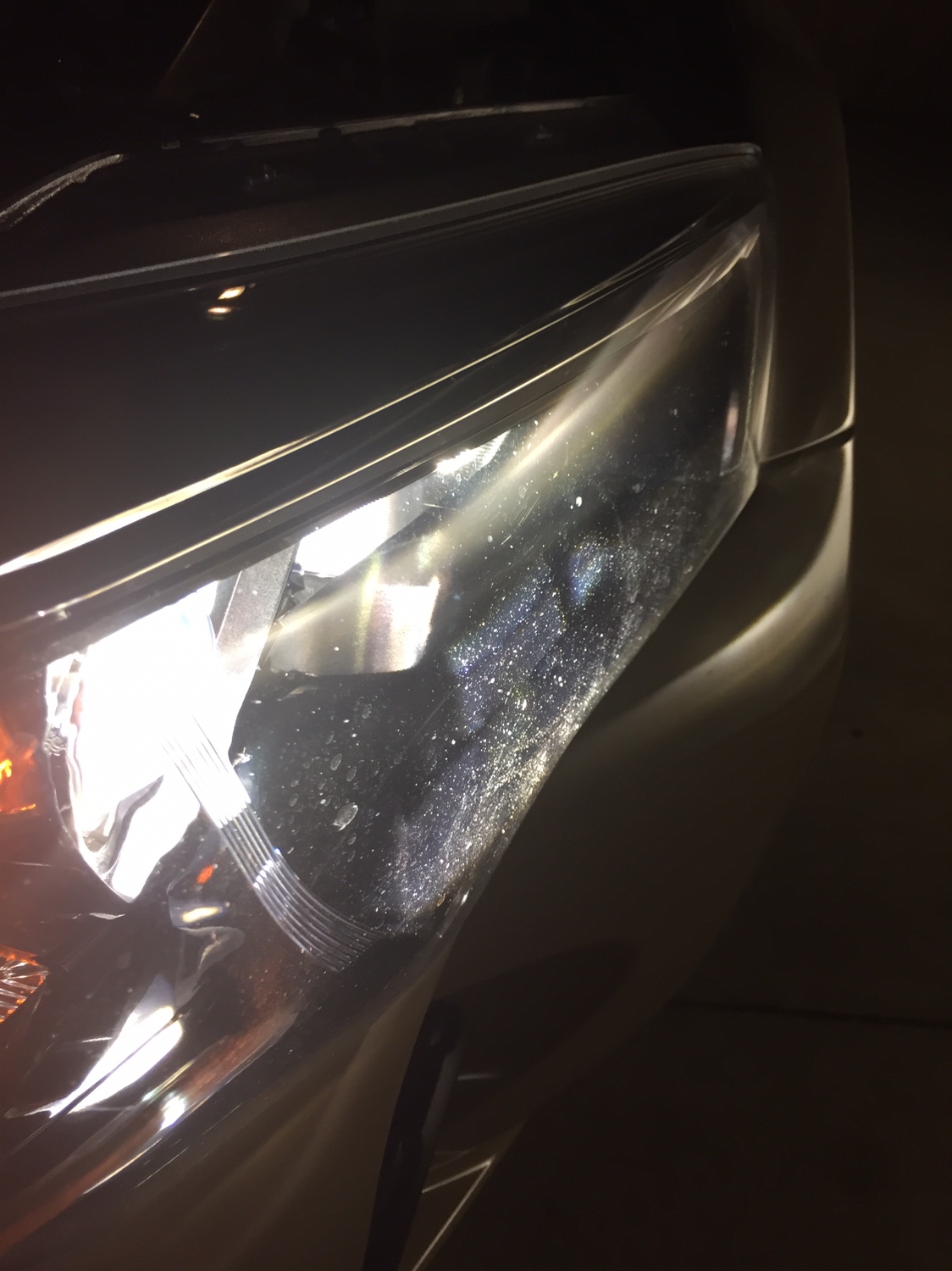

Looking to see if anyone has ran across shadowing? I haven't seen anything yet so thought I'd ask.
Right above the horizon line, on each side and the square shape in the middle. At first the only thing I could think was maybe part of the bulb, but after looking at it closer I couldn't see anything. The headlight housing projects the shadow just cant seem to see where it originates. It's minor but when I see everyone else's picture I don't notice it in theirs. Install was a clean as it gets I have OCD. I went with the 4300 kit. Looks great and I'm happy with it. I actually installed everything (relays and canbus) I read later I didn't have too. Can't hurt I guess.
. Thanks in advance for any feedback.
Cheers!
that is most likely due to light scattering due to HID bulbs in a halogen reflector. I bet all the other cars also have that same pattern nothing you can really do about it honestly.

Was this in reference to the light above the cutoff? If so, that is perfectly normal with certain vehicles as they have "Squirrel Spotters" for road signs.
Danny
Thanks [MENTION=153717]Biggu[/MENTION]
No [MENTION=156070]jacksparrow[/MENTION]
Thanks [MENTION=12905]XenonDepot[/MENTION] at least that gives me a search point. I see it now thanks for the insight

it may just be because of the picture angle, but your headlights look like they are aimed way too high. you might have a cleaner cutoff if you aim them down.

On a separate note I thought the same and I swear I turn my adjustment screw for a good 2 min and didn't notice a single change. I just had an open end wrench which is why it took longer. I never once felt any tension to indicate maybe I went to far or damaged anything. I tried both and didn't notice any movement. Though maybe I needed a ratchet and it just takes a lot of adjustments. Anyone else experience that?
Try a screwdriver from the top

Yea using a 8mm wrench was a dumb idea. It's 10x easier with a screw driver from the top. Either way all I did was move them down an inch. The lines are there to stay. I suppose you could possibly try and cover them inside the projector somehow. I don't think it would be worth the trouble. Thanks for the input though.
