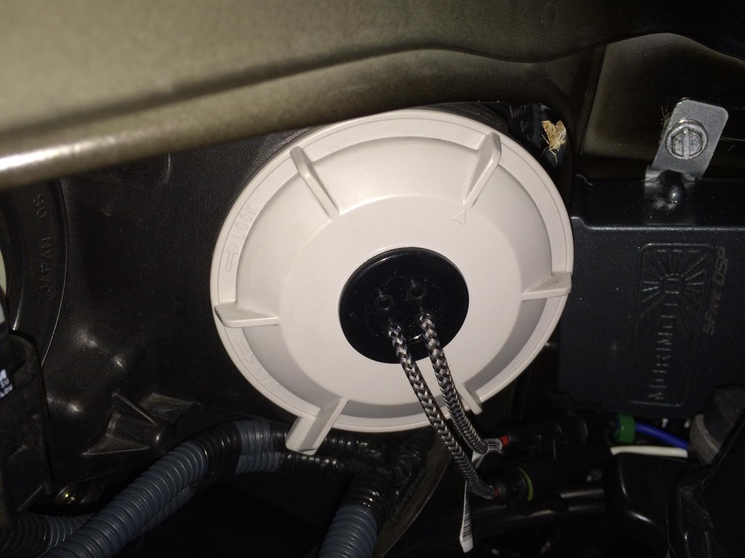

The 2014's have a gray plate on the back of the headlight housing. The wires for the OEM bulb goes into the bottom of the housing. You have to cut a 7/8" hole in the back of the gray plate and the HID bulb assembly comes with a waterproof plug that has the wires running thru it and that plug inserts into the 7/8" hole you previously cut into your gray plates.
The harness plugs into your existing bulb plugs, no modification is required from what I have seen and read.

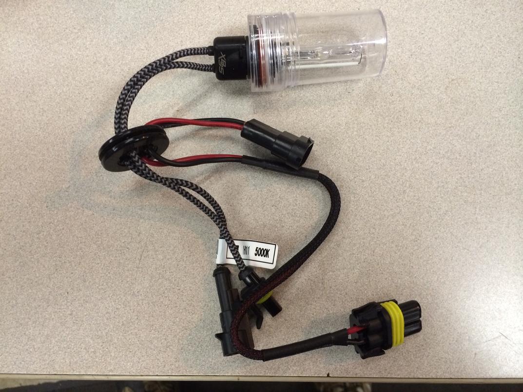

I purchased the Morimoto XB35 Bulbs in 5000k from the retrofit source, they look great and have a nice cutoff. The 6000K if you so choose will give you a little more blue.
The XB35 has the return wire on the opposing side as the regular H11 and work nice in the stock projectors with no shadows and a decent cutoff, I haven't been flashed at at... For my ballasts I had some older Zenex 35 watt ballasts that still work nice. Here is a link to both. You get a nice kit with a nice cutoff at a good price.

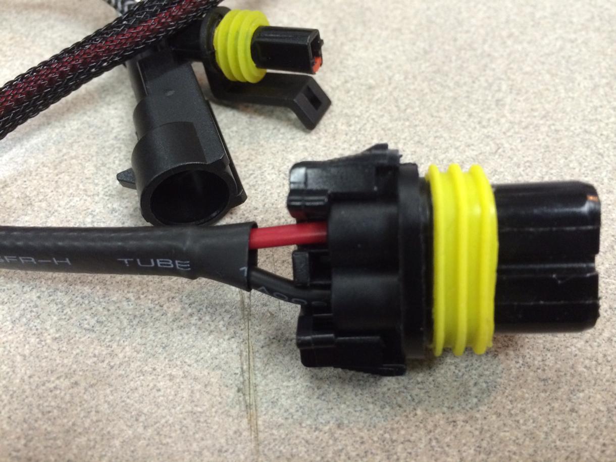

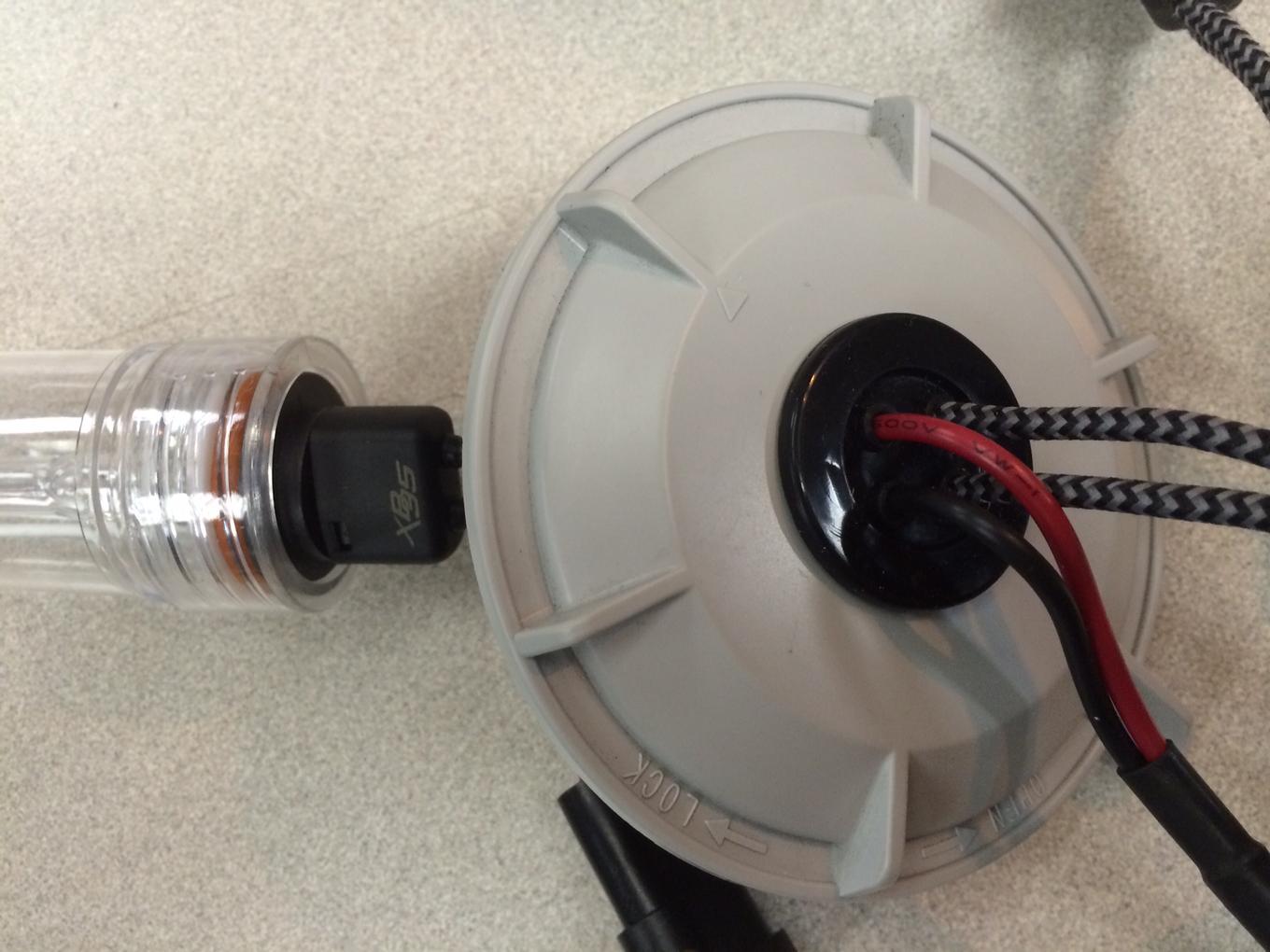

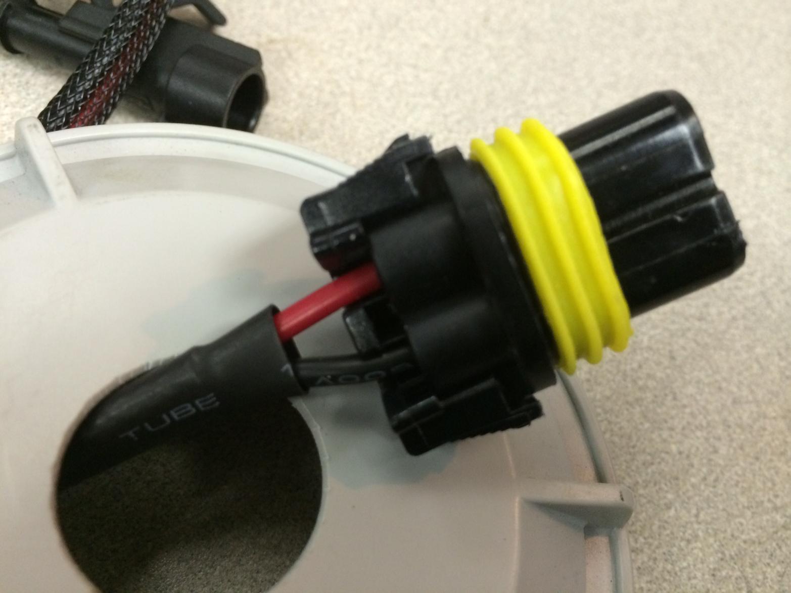

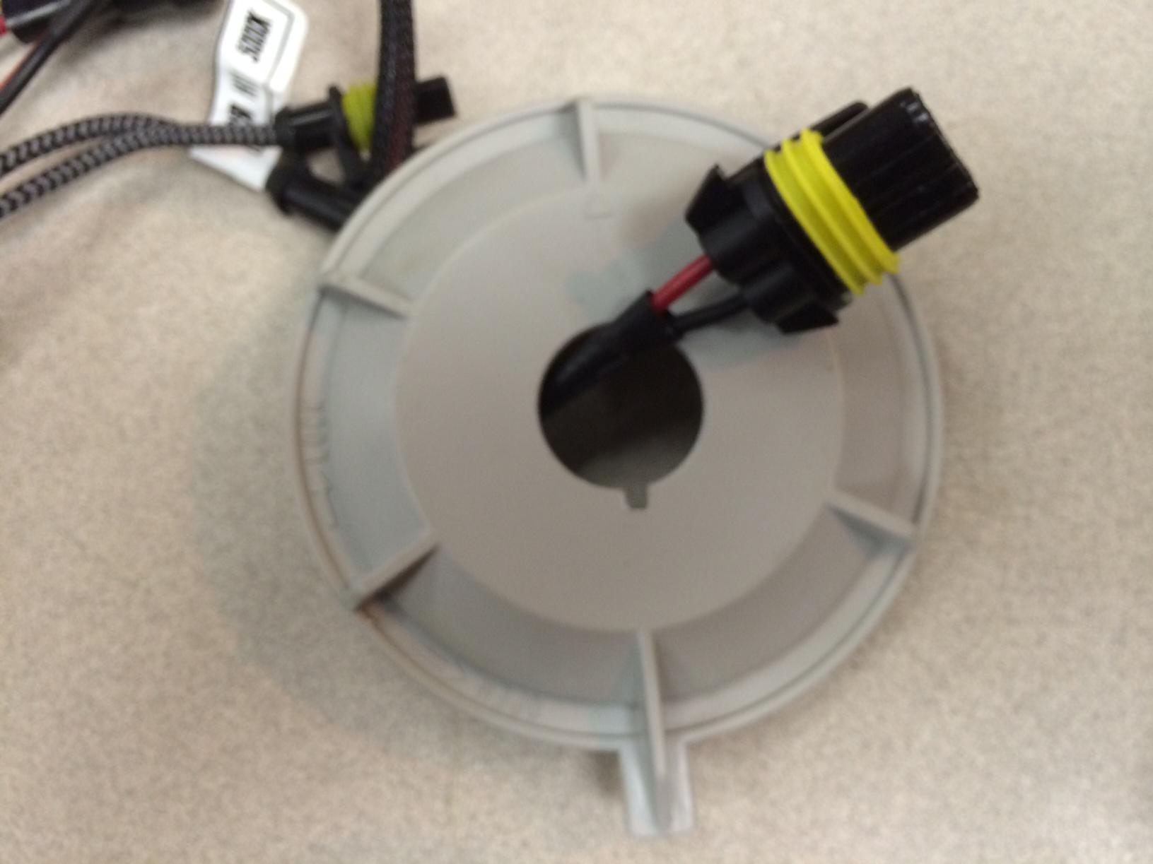

I received my TRS package today.... (ordered it Monday).

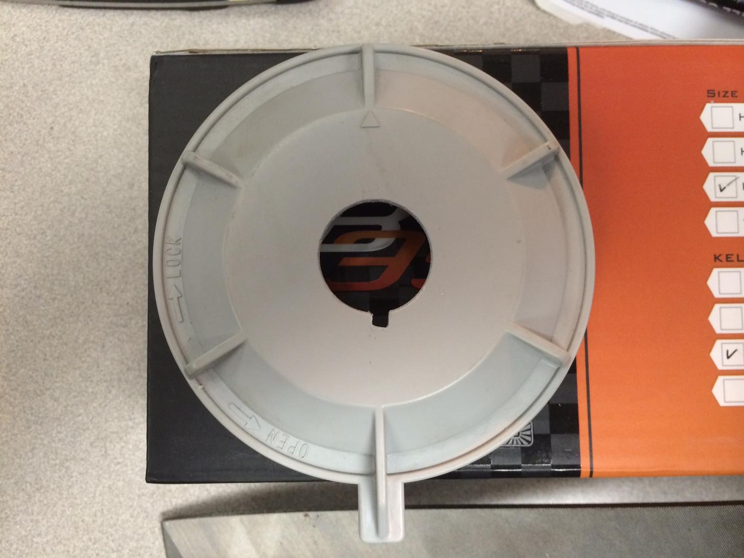

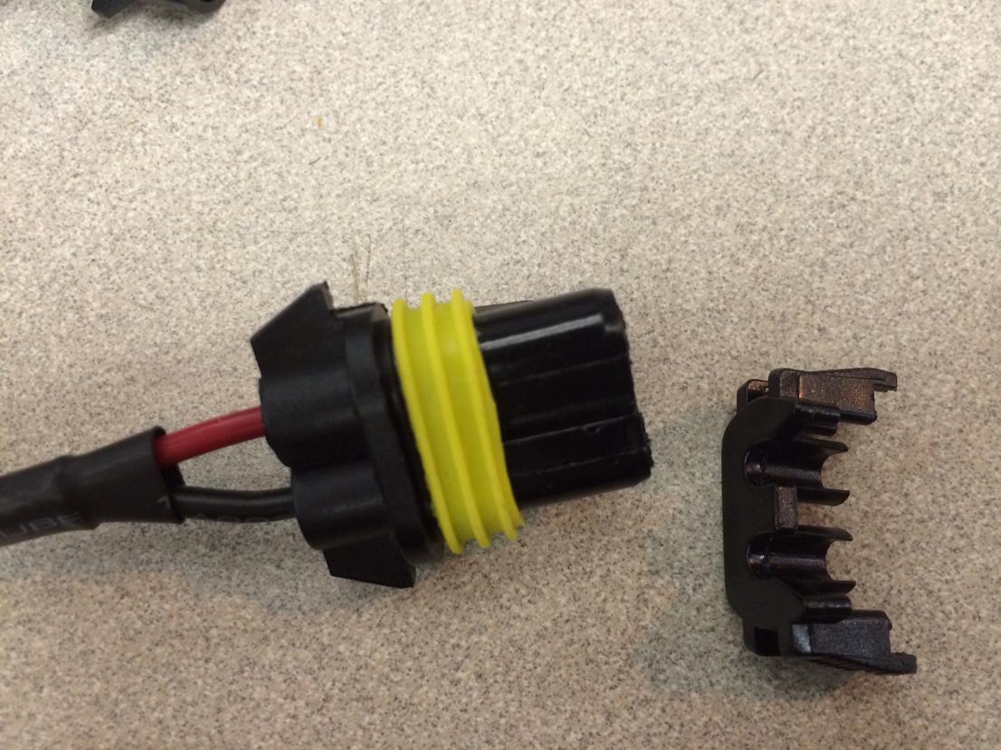

So here is what I have so far. Not doing the install today, but have some pictures / pointers for people that are interested.
*** For the 2014's, you will be required to drill a 7/8" hole in the Grey Plastic cover on the backside of the headlight assembly.
You will also need to make a 1/8" slot (as pictured) at the bottom of that hole. That is so the the connector with the HB35 HID Plug Wire Protector Removed will pass thru the 7/8" hole.
This is the order of the pictures:
  • HB35 HID Assembly
  • HB35 HID Plug Complete
  • HB35 HID Plug Wire Protector Removed
  • Gray Cover with Hole and Slot
  • Gray Cover with Plug Passage
  • HB35 HID Plug Wire Protector Re-installed
  • Gray Cover with Waterproof Rubber Grommet Installed

Saker, any install pictured you would like to post, lets say of the drilling, would be great!
[MENTION=2458]scott78945[/MENTION]
I don't have any of me drilling the Grey Covers, I just used a hand held drill with a 7/8" hole saw at a slow speed, don't get in a hurry.... it's easily done!

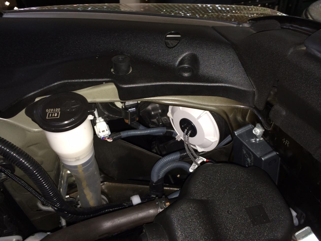

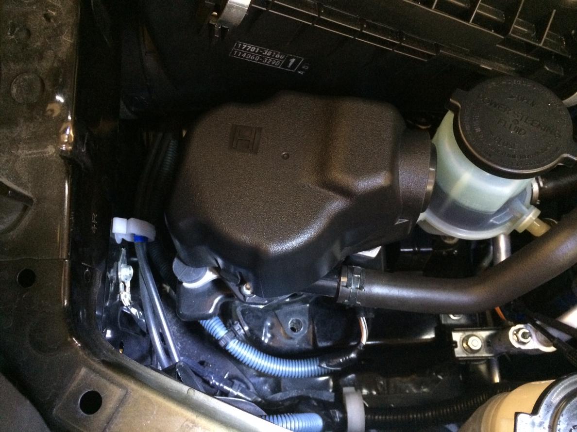

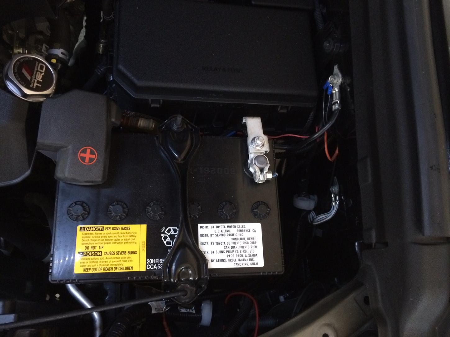

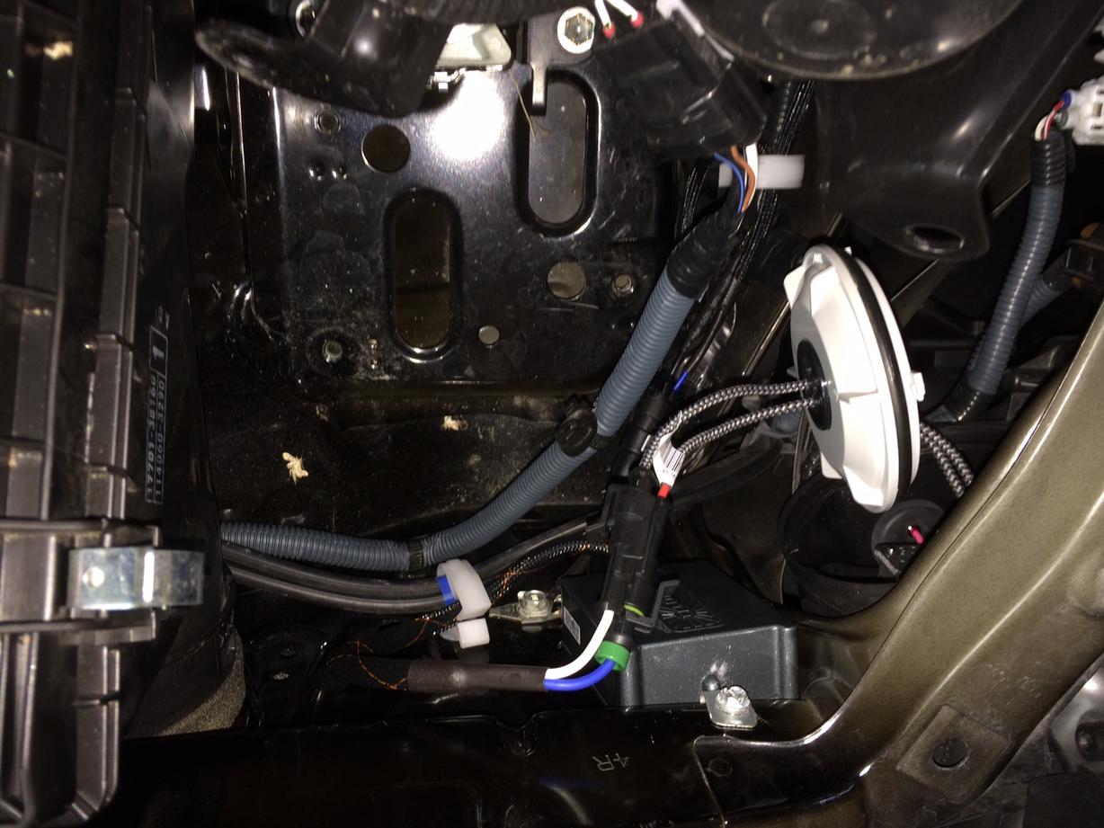

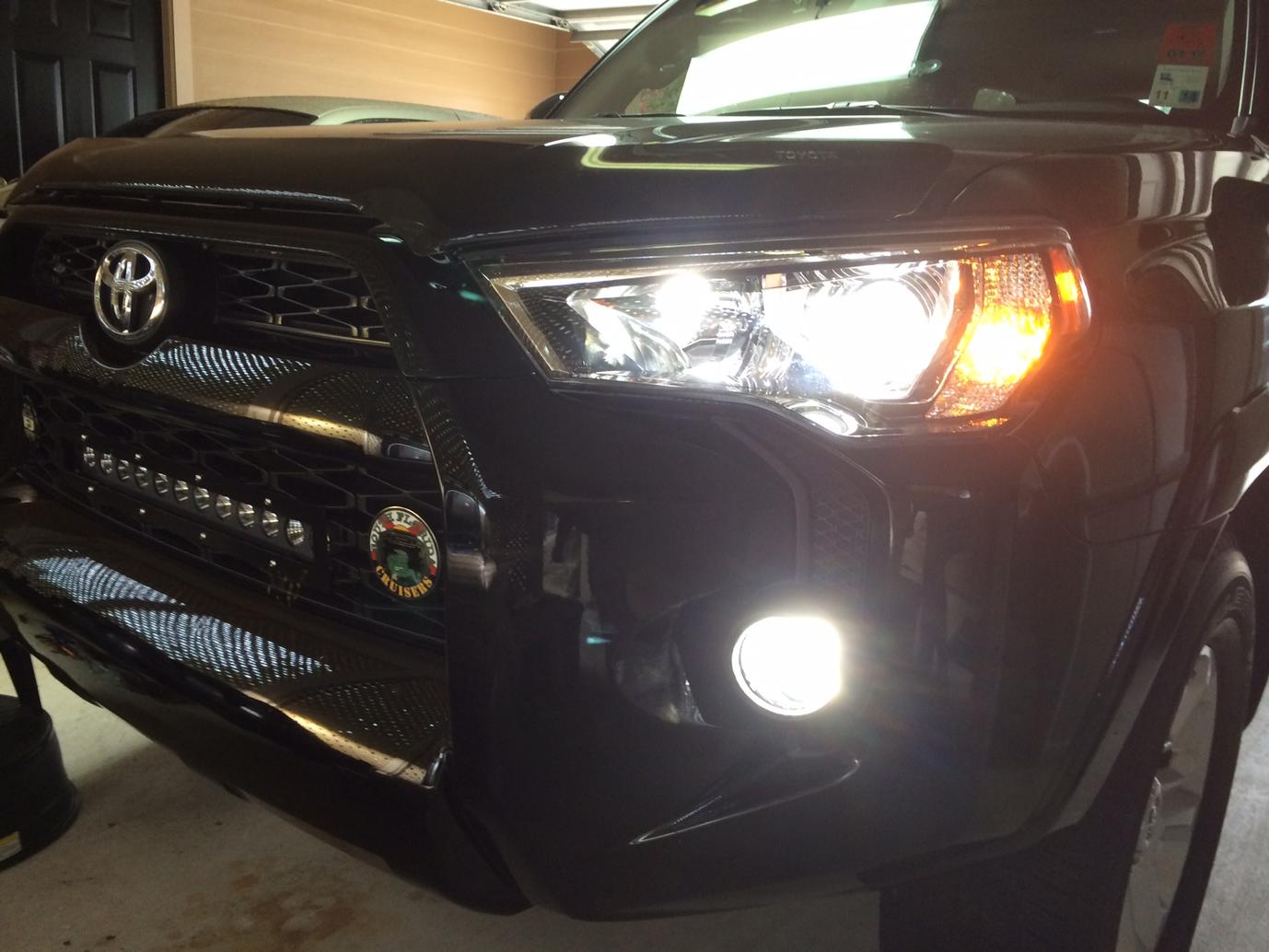

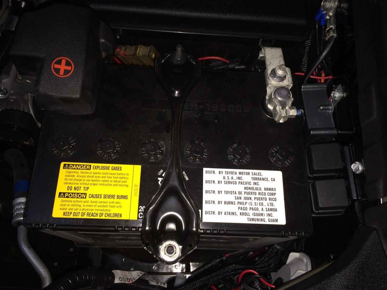

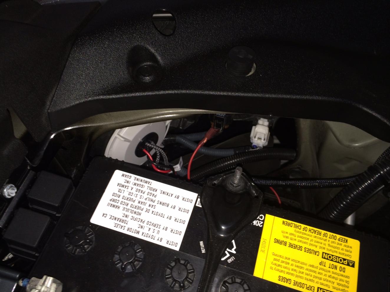

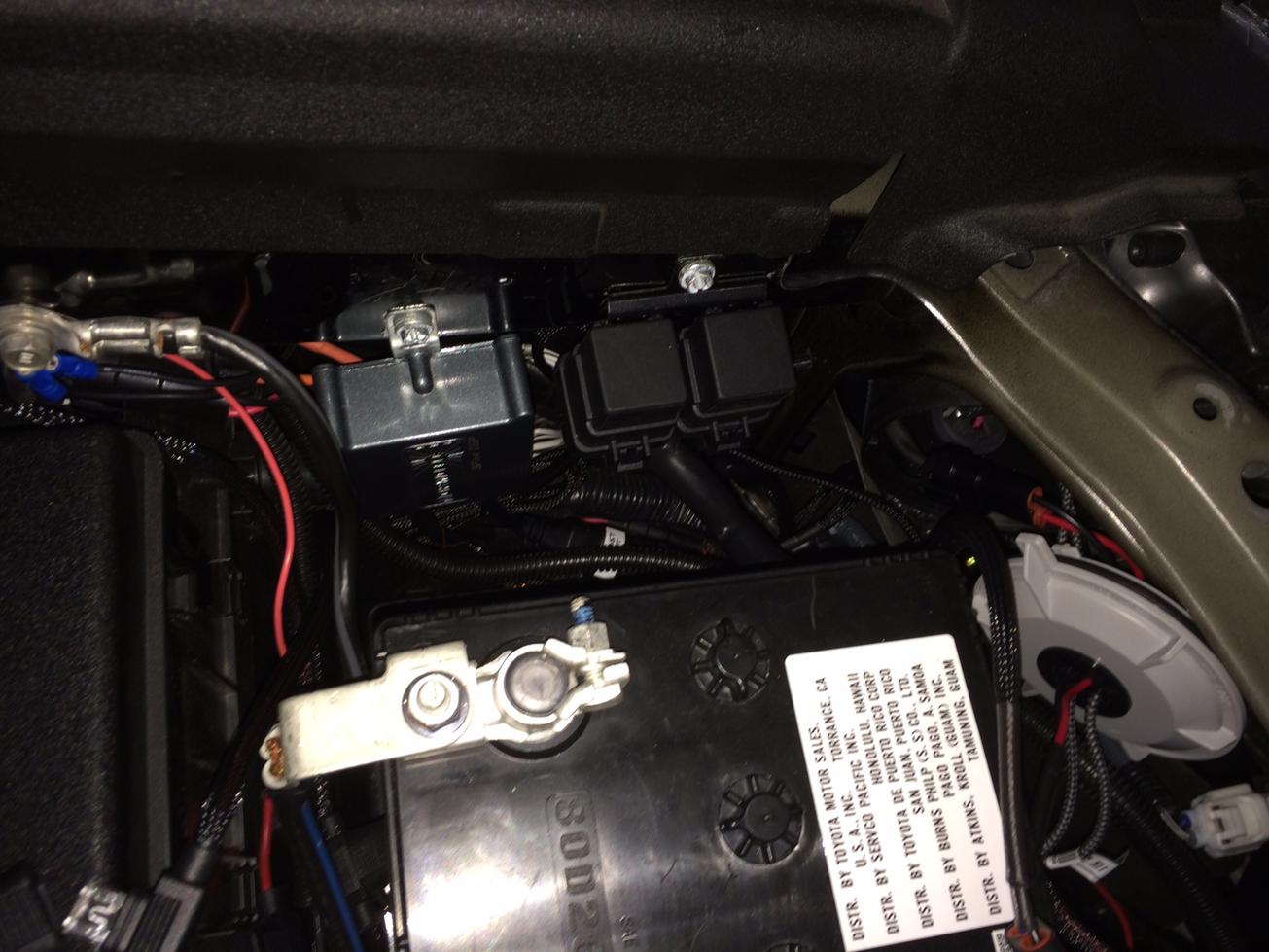

I completed my HID install this afternoon on my 2014 T4R.
Parts from THE RETROFIT SOURCE: H11: Morimoto Elite HID System
I made it much easier for myself by laying everything out on the desk, identifying all connections and where they had to plug into. (marked them and it made the install very easy)
When I received my bulbs and laid everything out, I noticed I would only have the drivers side that needed all 4 wires to connect.
The drivers side is where the OEM plug feeds to the Harness Input. After install, I was able to remove the 2 wires that did not go to the HID bulb.
I did have to remove the 3 bolts for the air pump so I could install the ballast on the passenger side and shifted the battery over to install the ballast and the relays/harness.
I hope the pictures and descriptions help!
  • Shifted Battery

  • Drivers Side Harness and Ballast Complete
