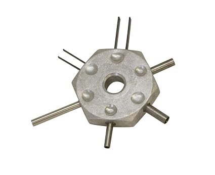

What you can do instead is depin the connector. Then pass the harness through the cover and repin it (pay attention to polarity...) How the Toyota is wired up and how TRS has it setup the black wire goes to the (+) marking on the weatherpak connector. I don't know why... maybe TRS chose a generic cheap connector... but pay attention where black goes and where red goes.
Use this to depin... Use the two thin smaller prongs. Wiggle it into the mating side, juggle it around, while gently tugging on the wire in the back. Once you have it out... check the tab and gently bend it out a touch so that when you go and reinstall it will snap back into the plastic body tightly.

What you can do instead is depin the connector. .....Use this to depin... Use the two thin smaller prongs. Wiggle it into the mating side, juggle it around, while gently tugging on the wire in the back. Once you have it out... check the tab and gently bend it out a touch so that when you go and reinstall it will snap back into the plastic body tightly.
Amazon.com: Lisle 56500 Terminal Tool: Automotive

Thanks for giving others the heads up for the Terminal tool.....
I didn't have access to one at the time and just posted a easy work around.
