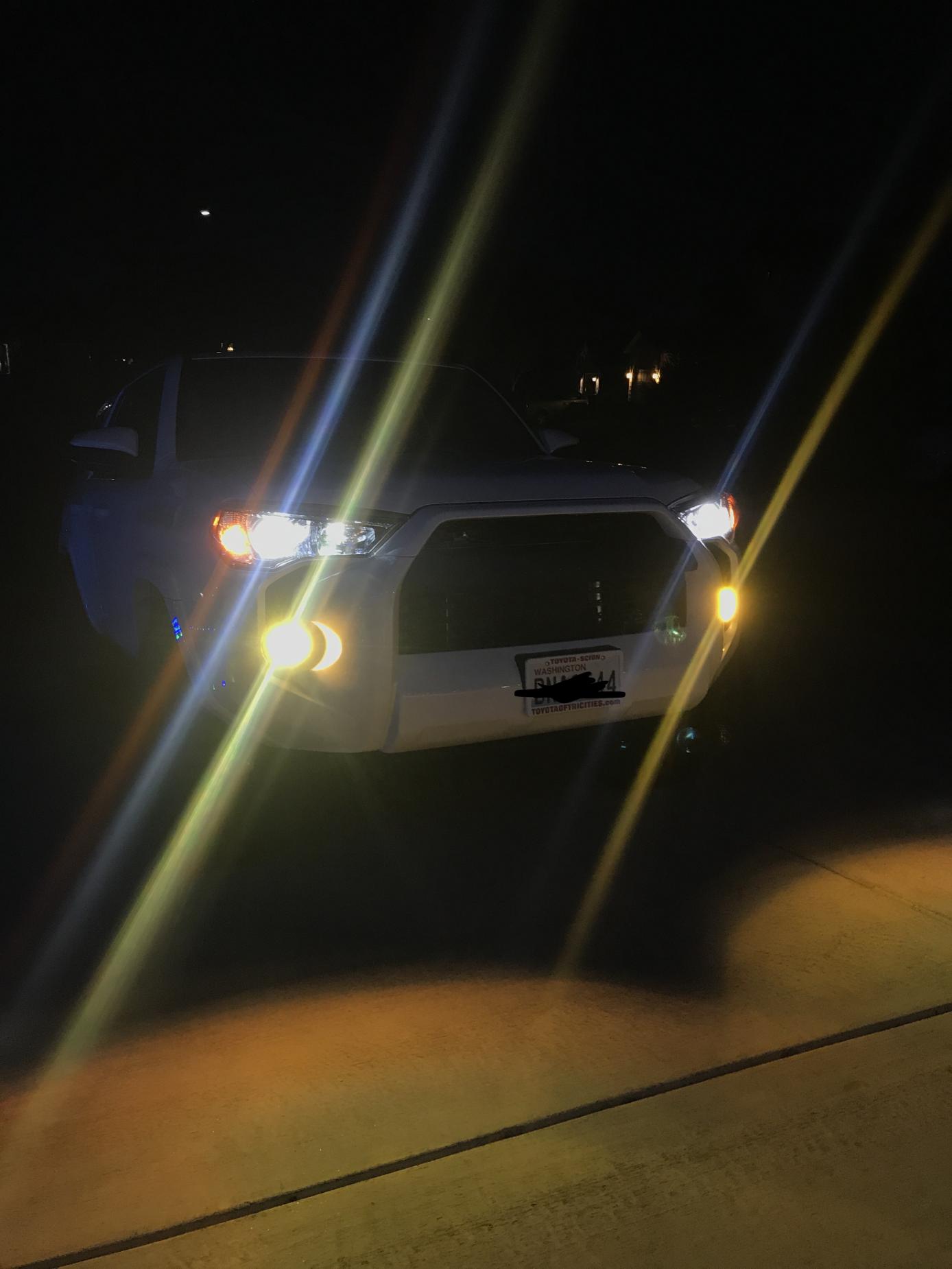

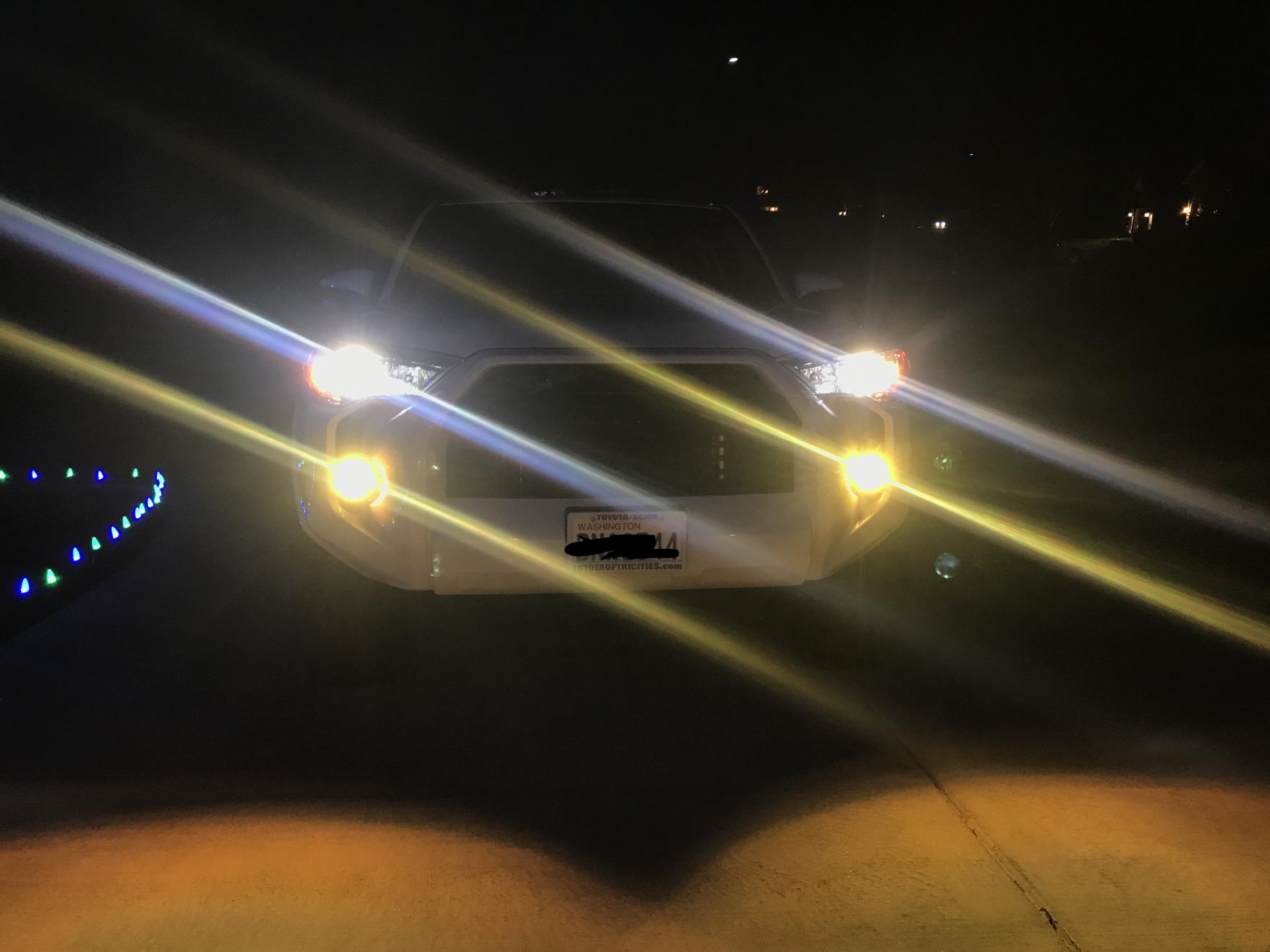

Just installed hidkitpros 5000k hylux low beams and hid hylux 3000k fogs! Super happy with the result and great company to deal with!
