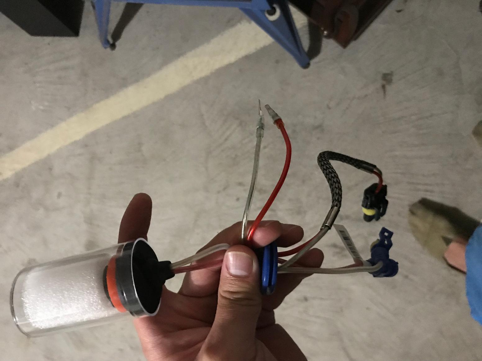

Anyone know what the white and red wires are for below???
I had a buddy with their kit, I’m pretty sure those wires are to connect to your factory plug in the housing. They don’t supply you with a clip on that end for some reason. It’s a solid connection though and he had no issues with it holding up.
