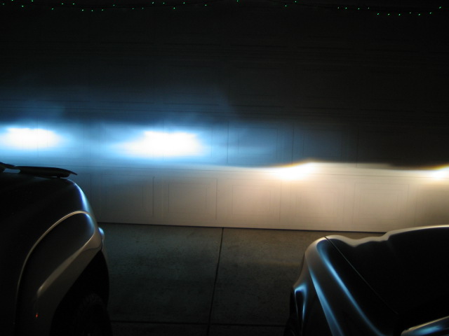

from what i've read it's not the turning off that's a problem as the required wattage is lower to run hid versus halogen. but the problem is in supplying enough power to the ballasts to turn them on, as in before the engine is started. that's why i asked about the stock alarm going off with the headlights flashing while the engine's not running.
other aftermarket hid kit makers have said to turn off auto headlights, which turn on before your motor can start to avoid this problem, but has not mentioned what to do for headlight flashing alarms.
here is the comparison between the E class and the 4runner (left).
you can see that there's more stray light comming from the 4runner, but that's a given because it does not have projectors. the intensity of both lights seem equal. the only difference is that the benz has a nice cut-off (no stray lights), and i's not blue. overall, i think the retrofit is a good deal. you get what you pay for. it'll cost 300 more for a custom fit projector. i'm still debating.
$300 more, allot of personal work and allot of luck to get it right and looking good you mean. Adding projectors won't be easy, especially to make it look "stock". I would suggest going with this retro kit and spend your efforts on other mods.
