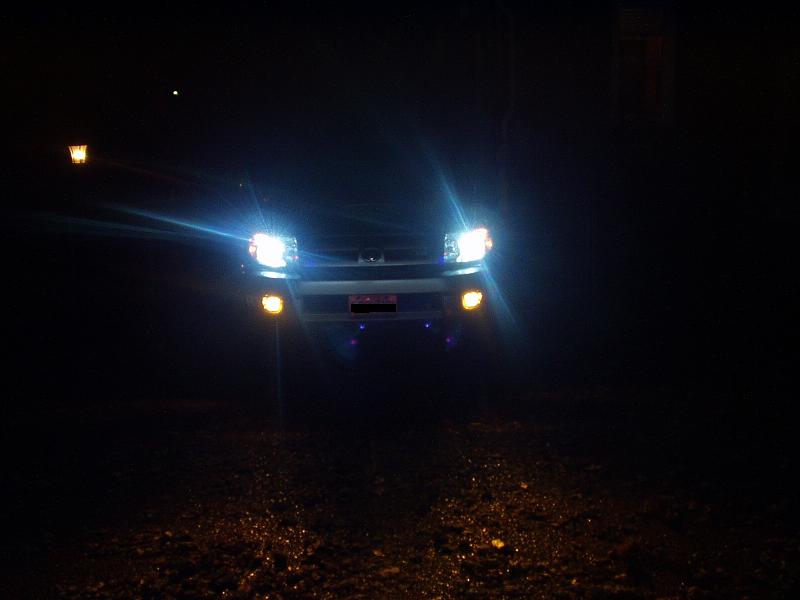

IS it me or is ther tremendous glare with this MOD???? I like the ambder fogs though.....I had and IS300 but now I actually like the clear fogs just for a change.
Is this the 8000K I see pictures of??
HIDS

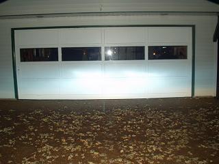

Unfortunately, my camera hasn't done much justice to the color and light pattern. I have a new Canon digital S500 Elph 5 mega pixel camera on it's way. I have been very impressed with the quality of the 8000K HID Conversion Kit. In fact, fuse upgrades weren't necessary and the kit uses less power than the OEM 55 watt bulbs. The first pic I was kneeling down directly in front of the light pattern and of course, these lights are 3 times brighter than any halogen bulb and with a camera, it's going to produce a glare. I have not been bright lighted once and a cop at the gas station thought they were stock. He said "Every new vehicle seems to be coming out with Xenon headlights". I'll never go back to halogen bulbs. I believe I'm going to buy another HID kit for the fogs. Two of my friends have purchase the same kit. One for an 02 Z3 and the other for an 03 Sequoia. Everyone's real happy. Unlike the retrofit in earlier posts (very cool) I installed the HIDs and fogs in 30 minutes. and I can take the HIDS out in 5 minutes if I need to (two 9006 Halogen bulbs in the glove box if the system goes down) In addition, HID bulbs create less heat than halogen bulbs and new vehicle headlight housings are perfect for this upgrade. Reflectors in the housing are angled to produce a specific light pattern. The type of bulb wont change that, just much brighter coverage. I live in STL. If anyone in my area is considering this upgrade, email me and you can see in person.

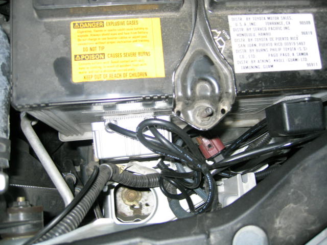

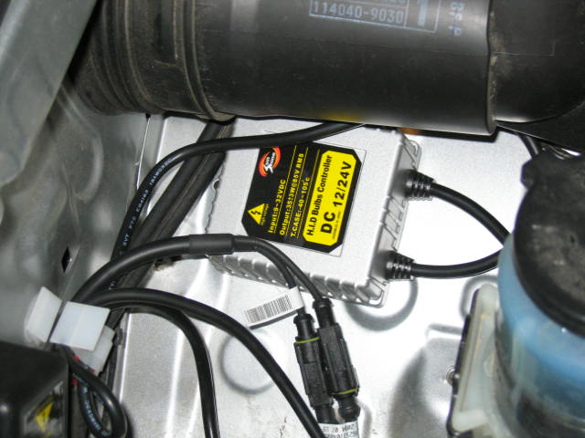

Very simple. Grab the base of the 9006 "low beam" OEM stock bulbs and turn them 1/4 turn counter clockwise and remove. Unplug the stock bulbs. Remove the protective plastic covers on the 9006 HID bulbs in the kit. (must be unplugged from the ballasts and igniters. Be very careful not to touch the bulbs with your fingers or anything else during install. Connect the HID system directly to the connector that you removed from the stock bulbs. Be sure all connections are secure and test. I was told to leave the lights on for approximately 15 minutes when you fire them up initially. I mounted the HIDs for easy removal with industrial Velcro, which created a clean, easily removable MOD. I posted a few pics of where I installed them. If you have any questions, send me a private message with your number and I'll call you. Enjoy. They're awesome. I would recommend the Nokya 2500 K Hyper Yellow 75 watt 9006 bulbs fort the fogs.

hey i see in the second picture that you mounted one of the ballasts to your battery. i know it's easily removed with the velcro, but what happens when you change the battery? you'd lose the velcro that's stuck to the battery.
