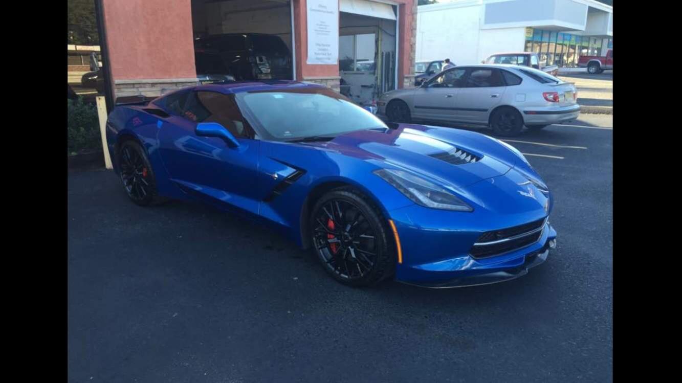

I am 33 so not some 18yr old dreaming. Single no kids so yes, I have the $. My other car is a C7 z51.
