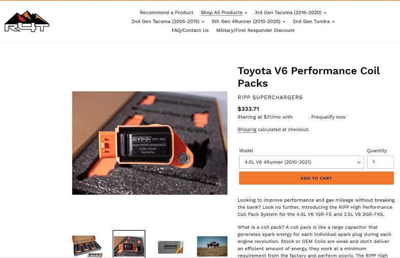

Has anybody tried these?? I'm sort of expecting a number of comments like "Snake Oil! Don't do it" etc. but maybe not.
I'm interested because I go way back to my 69 Z/28 that I built in 1982. One of the quickest ways to get those motors to run better was to put in an Accel Super Coil, better Plug Wires, etc.
So, that said, IF these are a quality product and really put out the increased voltage they claim, I'd think they would generate some better spark energy, which *MIGHT result in a bit more power and economy.
If you' tried them and have experience, that would be great! If you are a Toyota Mechanic and think this is a bad idea (not saying it is or isn't), why do you think so?
Thanks!
Toyota V6 Performance Coil Packs
– Runnin 4 Tacos

I’ve got those coils packs for ~15k on my 4Runner and here’s my real world experience. Quality of this coils packs: I would say same as OEM or better, no issues at all. Performance: If you looking to solve lack of power in your 4Runner, most likely you will be disappointed just because there is no way anybody can feel those gains (13HP) with their bud dyno.Fuel economy: It could be some improvement but mostly it depends on your driving habits. Ok bottom line, if you want to upgrade your OEM coils packs just for those gains, I wouldn’t do it, if your coils packs have to be replaced as maintenance then you can definitely get those, just because they are chipper and like I said , Quality and performance in my honest opinion is better than OEM coils packs. BTW guys that 4Runner on YT video was the first one those coil packs were installed and it’s my truck.
