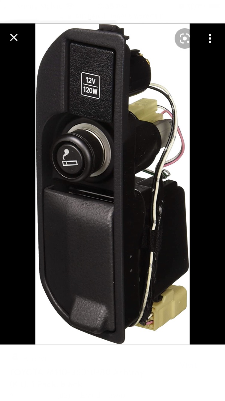

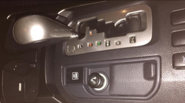

Could you post a picture of this setup?
Here are two pics, one off this forum.
You can google “4th gen 4runner smokers kit” and find a lot of photos.

I just found a pic online, and it’s a warning on the socket without the lighter. 10A is the total rating for both outlets, not 10A per outlet.
Do you know where the single plug version of this can be bought? The one with the larger compartment.
Probably from the parts department at the dealer.
The single plug version won’t have a lighter. You would have to buy that separately, and the lid won’t close with the lighter installed.
