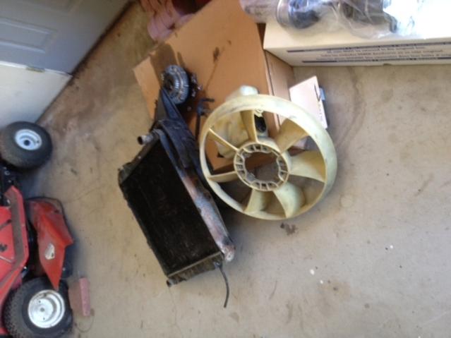

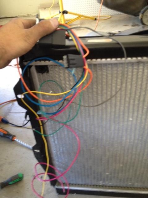

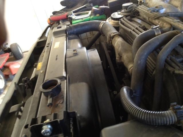

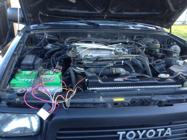

Got tired of the truck running hot so I pulled the fan clutch, did the ford taurus electric fan mod, replaced the thermostat & radiator, flushed my system and got a new radiator cap.
Runs cool in tripple digit heat with the AC blasting :thumb3:

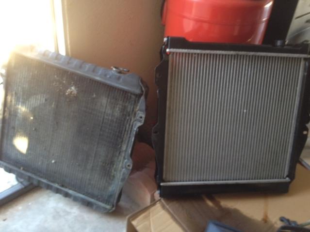

Look down in your radiator when it's cooled off. Willing to bet I still had the OEM radiator in mine. TONS of calcium build up and little calcium looking rocks settled in my radiator along with poor coolant circulation.
Probably could have gotten away with just a new radiator...But really wanted to do the e-fan mod. :redbrick:
