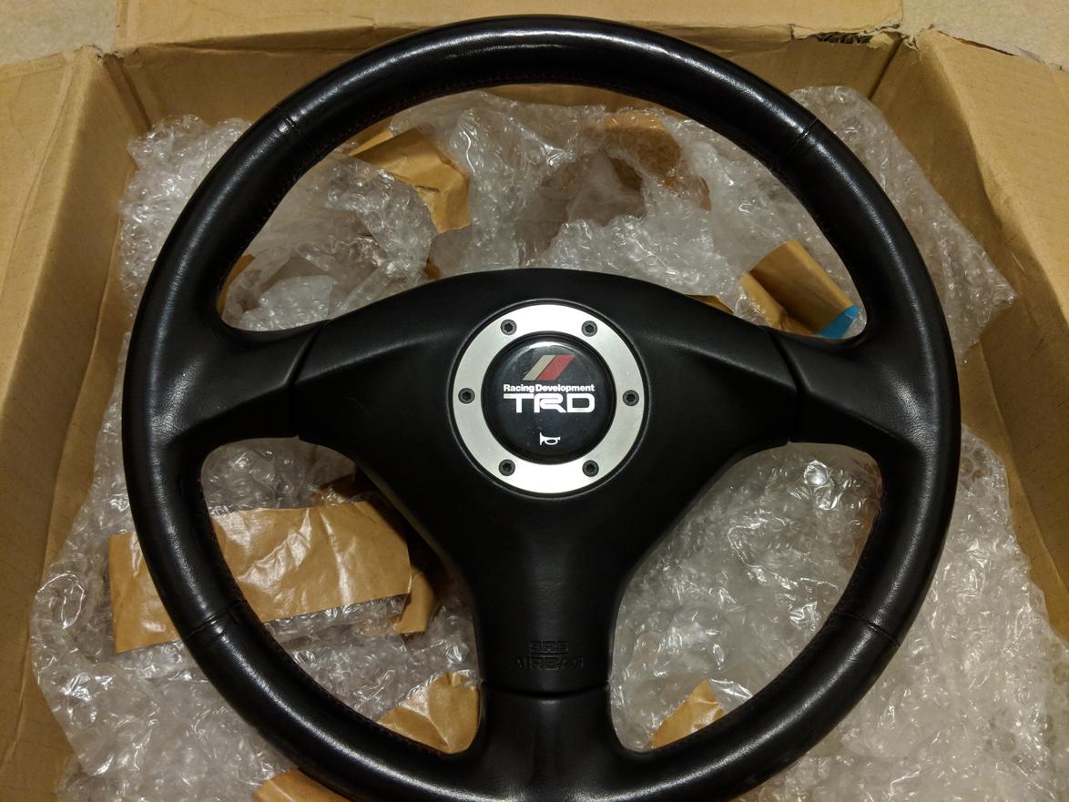

I'm sure the splines are the same, but the hub may be different from ours and may, or may not fit our clockspring directly. The plug for the steering wheel controls can be repinned to fit our connector, as well as the airbag. The other big factor is to make sure it's the newer dual stage airbag. I have a TRD steering wheel that was made for the Supra and the splines matched up, but wouldn't fit the clock spring without modification, and the airbag is an older single stage. I probably would've left it installed if I had an extra clock spring that I could modify to keep the horn and steering angle function. I'm selling the TRD steering wheel by the way if anyone is interested :thumb: just send me a PM
