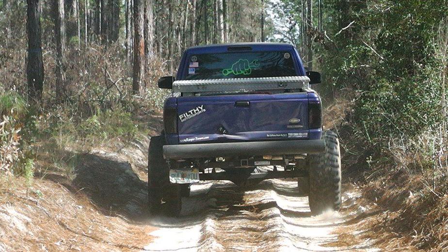

Agreed. Never put a strap around the hitch ball, it can/has/will break.
Picture is of a ball embedded into a tailgate of my friend's ranger, after he tried it....
Any of the mentioned hitch receivers (smitty, f55, or similar) will work perfectly fine and safe. You will break the strap long before you rip the hitch off the truck, break a proper d-ring shackle, or shear a hitch pin.
