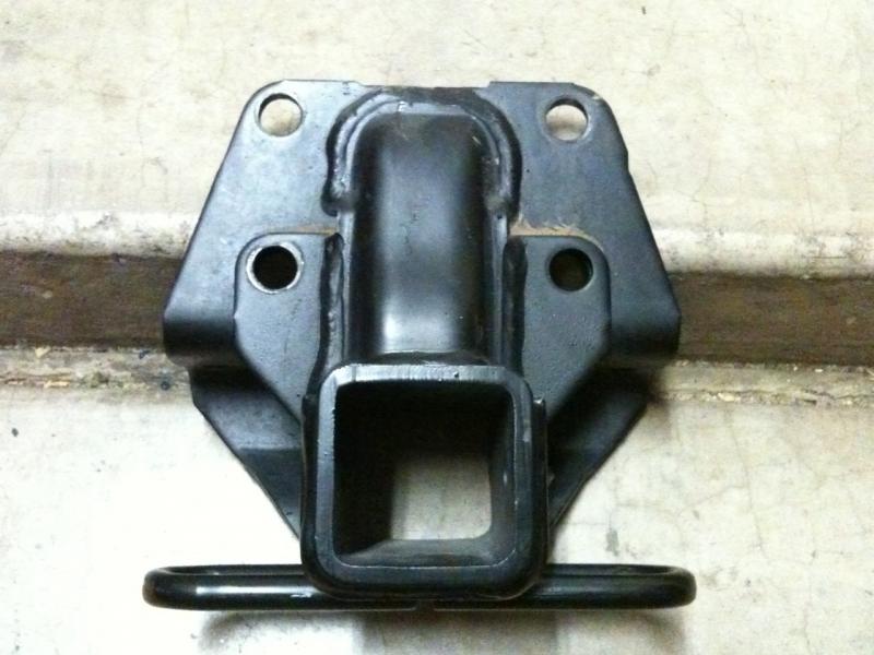

I have a 2008 4Runner 4x4, V6. I have the bumper that is cut for a hitch but no hitch, the only reason I want to put a hitch on is for my kids to take their bikes on vacation that's all, I will not be hauling anything else. I have a friend who has an OEM hitch, it is one piece that attaches to the crossmember and that's it, looks like the picture I posted. I looked at a couple of sites and this is what I found that looked like what I think I need, I attached a picture of a diagram part number 35 it says trailer hitch looks like it, what I want to know is, am I looking at the correct part on the diagram or am I missing anything else, and part number 36 in the diagram says trailer hitch bolt do I need 6 of these bolts to mount it to the frame??, I contacted the dealer and they wanted to sell me a towing package almost $400.00

Part 35 is the OEM hitch you are looking for which I found for ~$174, and then I would say you need 6 bolts. Do you need the wiring harness for hooking up lights to the bike carrier? Then you would need the wiring harness as well which I found for ~$204. So $400 isn't that far off if you need lights and the hitch.

shootersanks, thanks for the reply, I don't think I need the wiring harness now, I only plan on using it for a couple of bicycles, do you know how much weight this handles.
It's rated as a class 3 hitch which is something like 3-500 lbs tongue weight and 5000 lbs trailer weight...
Wimpy looking isn't it? I was shocked when I crawled under the back of my 4R for the first time and saw that! More than capable for a bicycle rack though.
Hard to believe that is rated to tow 5,000 lbs. But that's what I have on my 03 and I tow my boat which is probably about 3600 lbs just fine.
