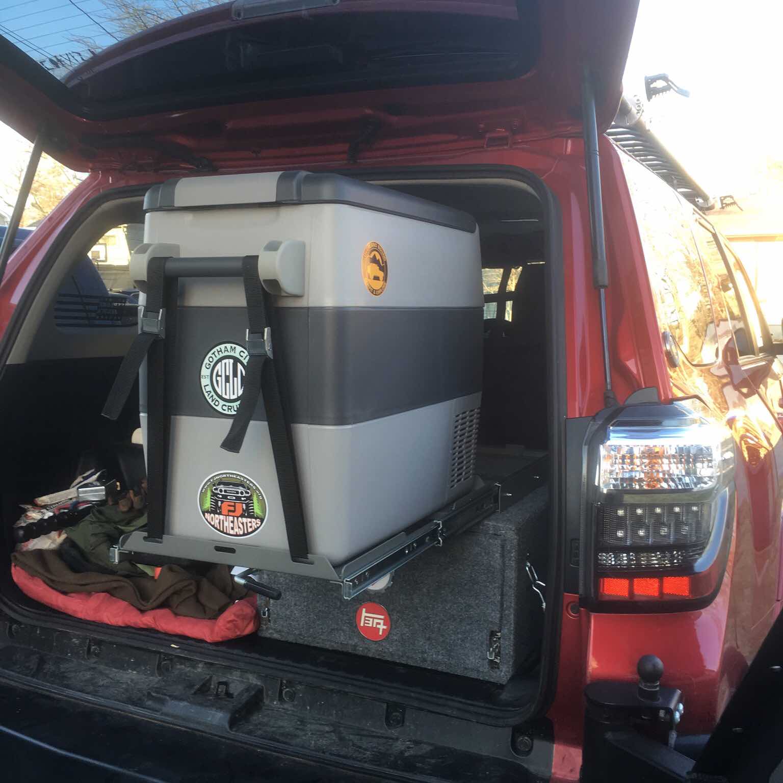

Rear Drawer with fridge slide

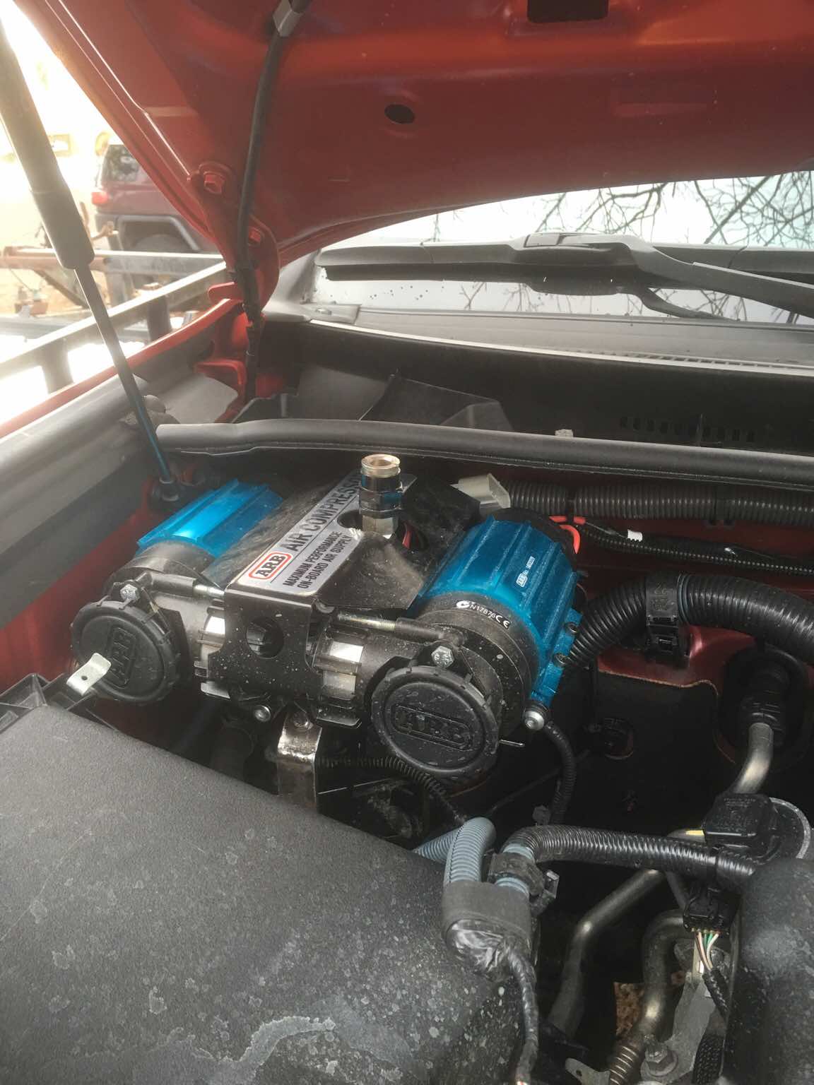

ARB twin air compressor

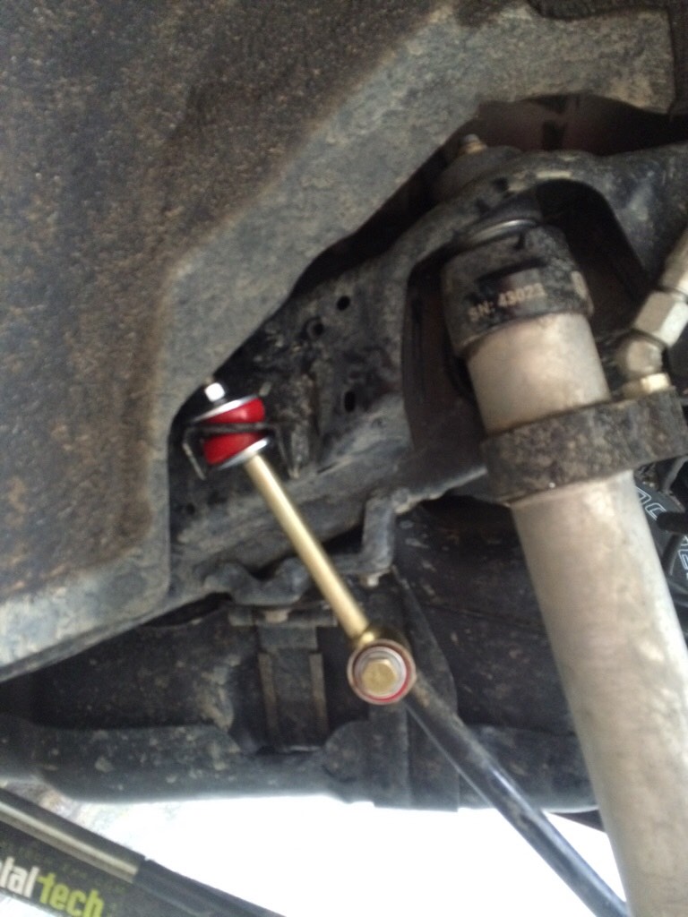

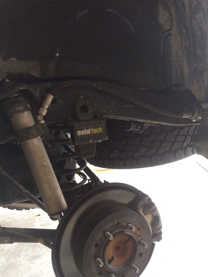

Relocated rear reservoirs because the tires were rubbing them. Also installed beefy longer rear swaybar links
View attachment 152656View attachment 152657View attachment 152658
good going on relocating the rear reservoirs. that's where they're supposed to be. :thumb3:
ICON should really call better attention to that. i've seen a number of pics of them installed improperly, but can kinda understand why: attaching that bracket to the frame blind (behind the rear body panel) is a real PITA, accessibility-wise, but once it's done the CDC adjusters are still easy enough to reach.
rig looks good.
Thanks [MENTION=29376]sandcrawler[/MENTION] the kit didn't come with directions so I just slapped it together until I figured it was mounted in the wrong place lol

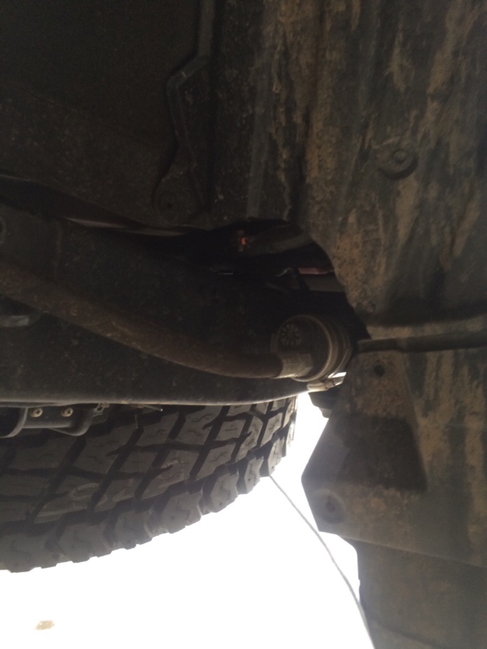

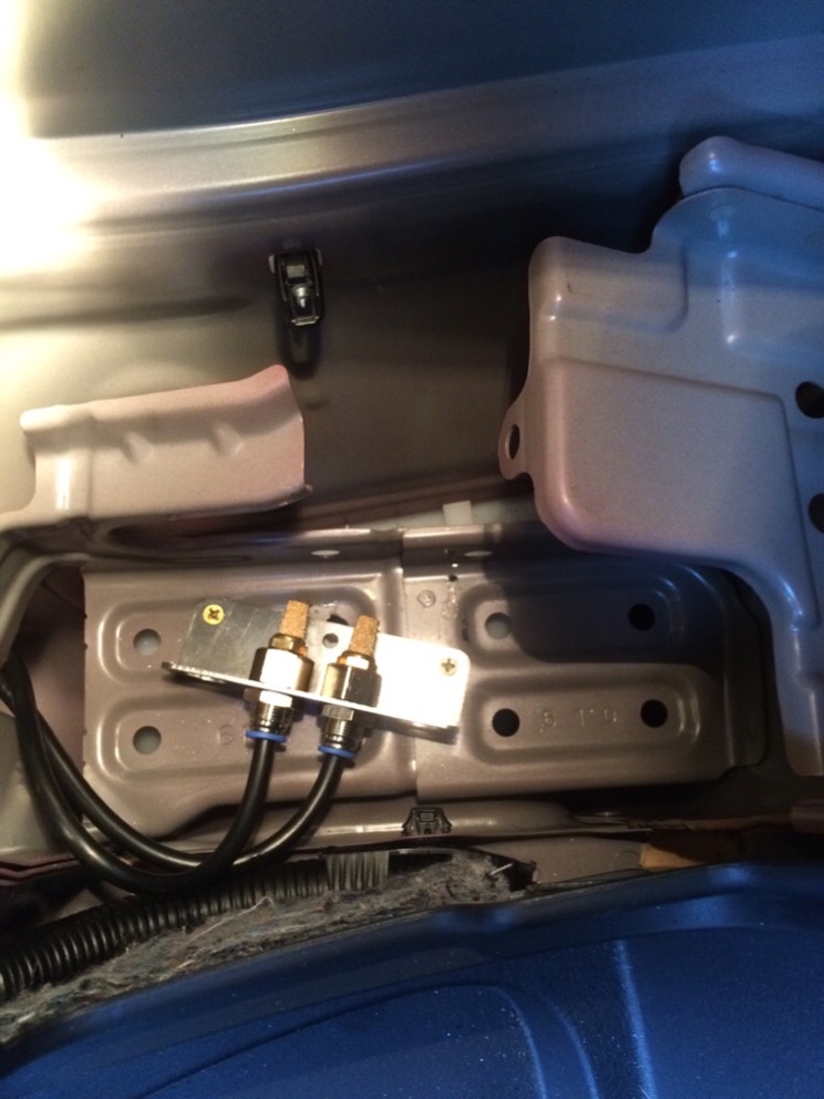

Extended diff/locker breathers in to the jack compartment

Have any more pictures of the relocation of the breathers? I need to do this soon and weighing my options on how I want to do it.
And with the LT rear got to go sway bar less to get the full use of the travel. Even with the new links they are WAY stressed. But on road they should be good.
[MENTION=49966]mikey's2010SR5[/MENTION] I do not, basically run the hoses through the round rubber grommet in the jack compartment, I used AOB kit 4 Port Diff Breather -Air On Board, you will need double sided barbed hose fitting 1/4 " to tie in the e-locker hose with the hose provided with the kit.

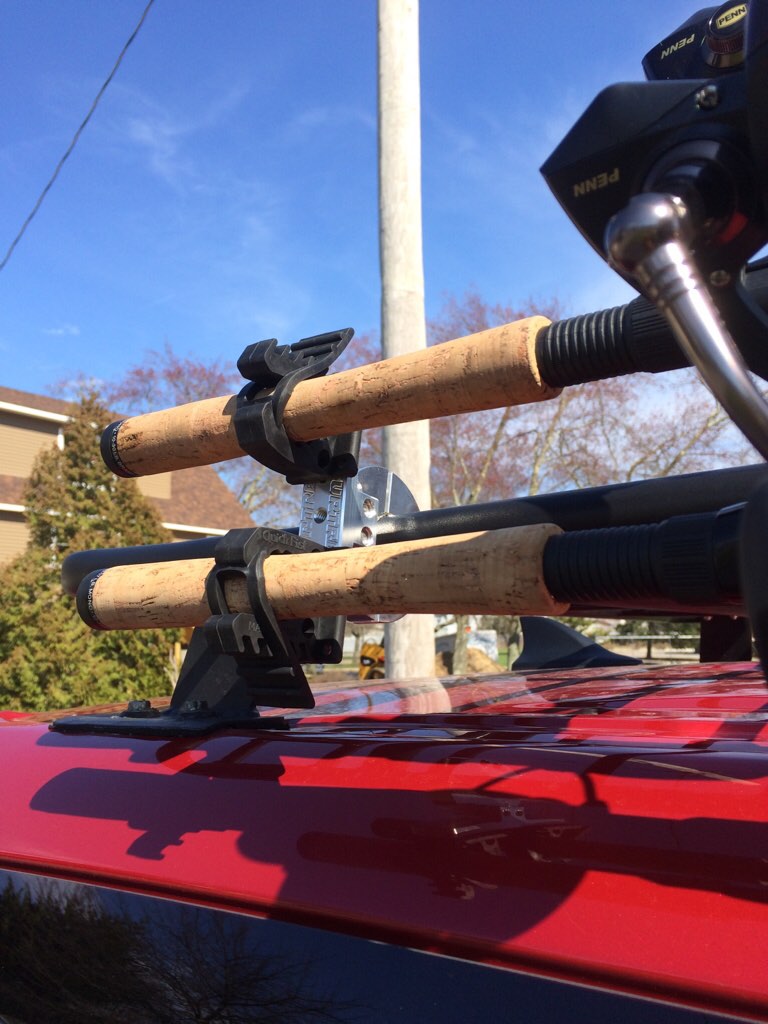

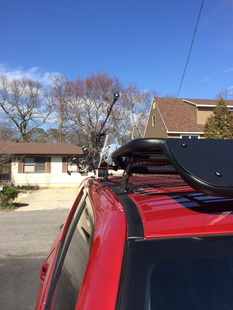

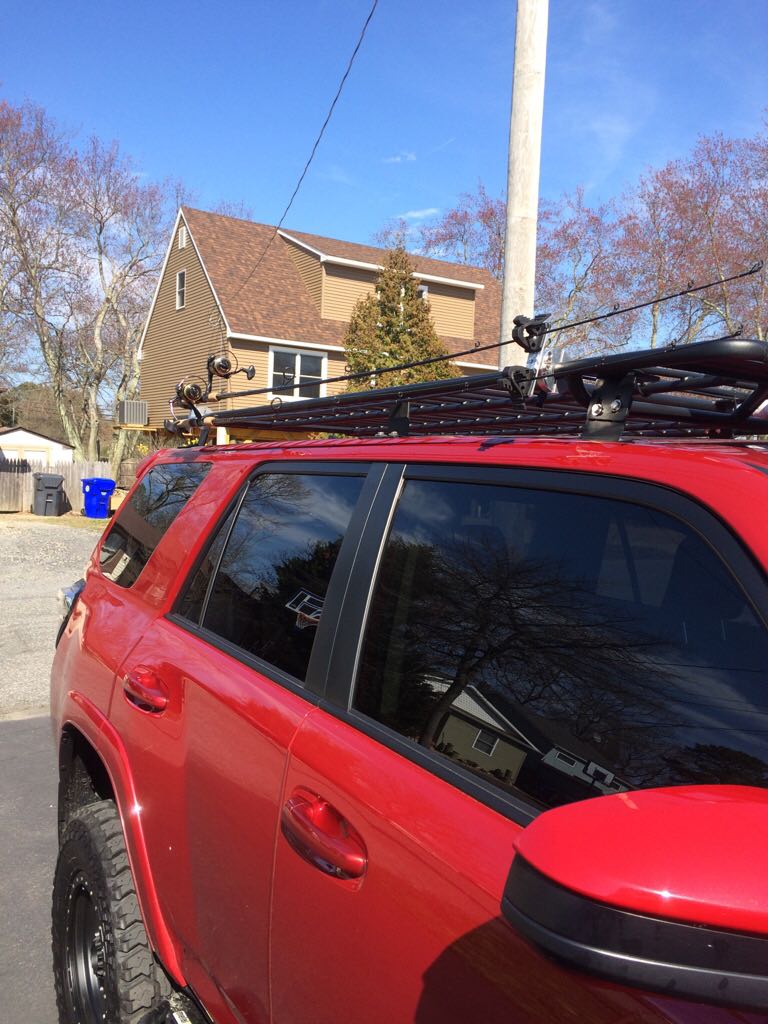

Mounted fishing poles using fourtreks vertical mounts and mini quick fists

great work on the rod holder...I'm looking at doing something to hold my rods on top as well. Wonder if I can do something with the stock rack. I notice people use ski/snowboard rack to hold rod as well.

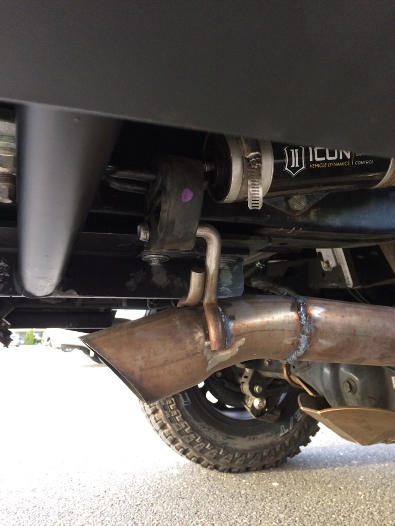

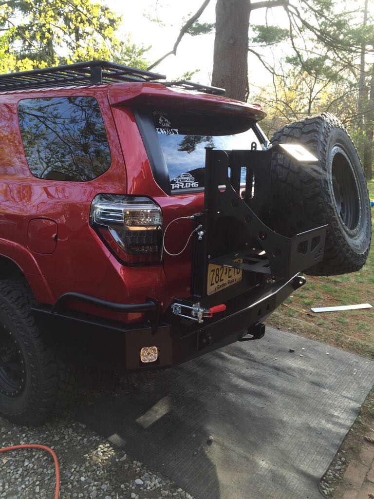

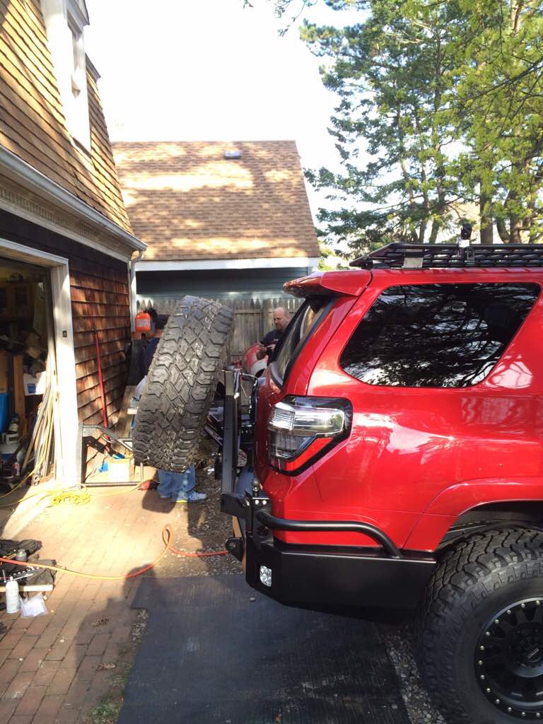

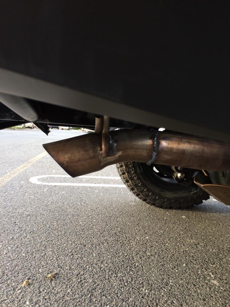

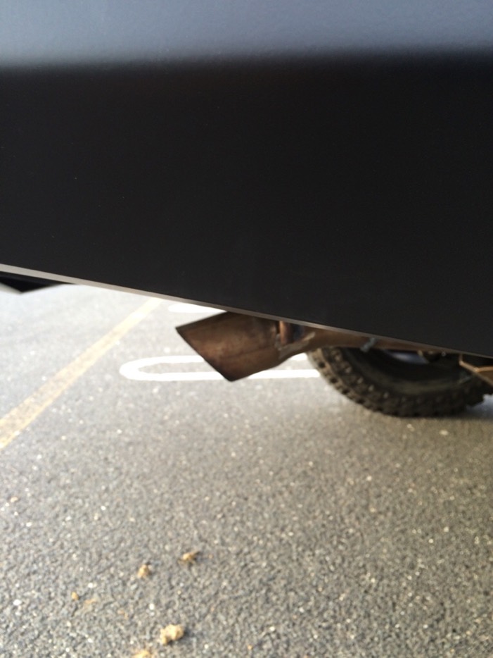

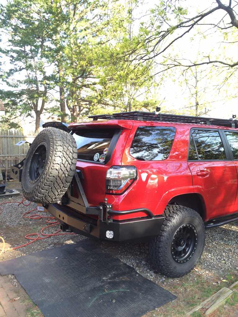

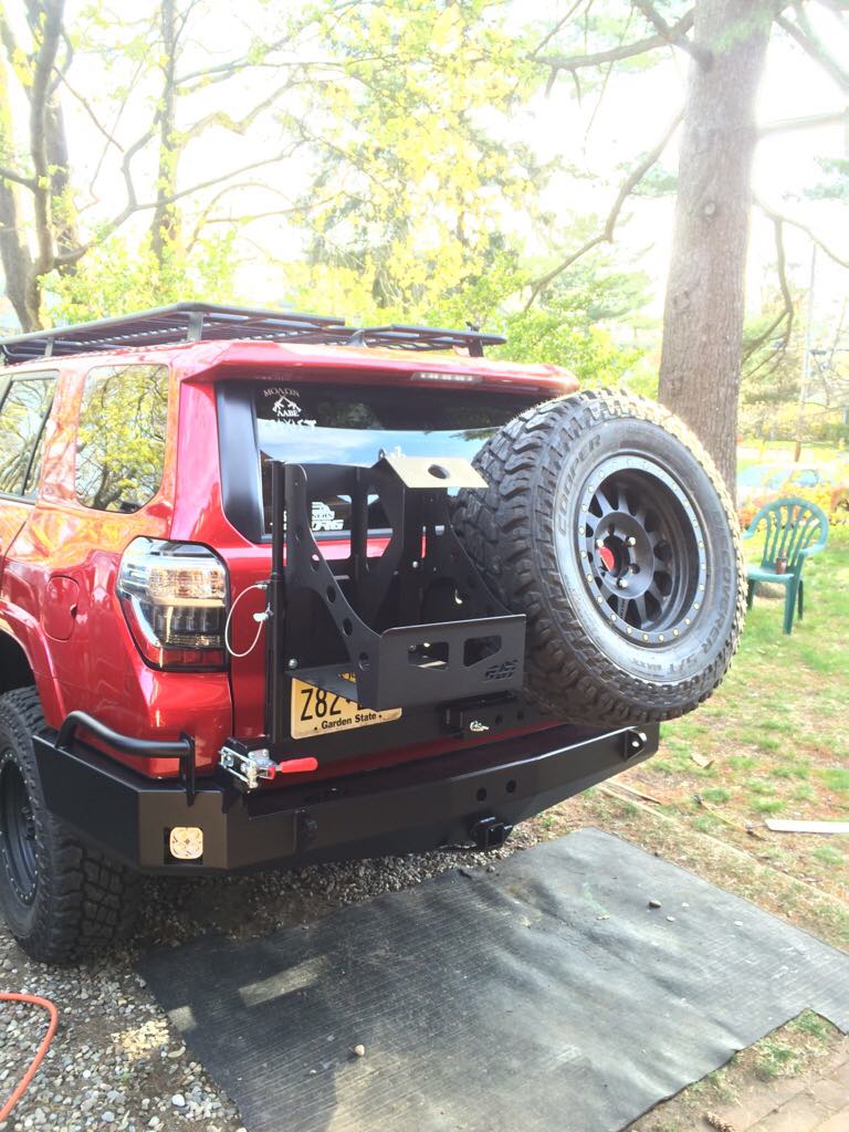

Took advantage of nice weather and installed CBI swingout bumper. Quality and build of it is awesome, unfortunately it did not come with instructions (for the bumper or swingout attachments) and edge dressing. I used [MENTION=107119]2014 Warthog[/MENTION] measurements and instructions, thank you Sir. Also cutoff about 10" from the tail pipe, welded the tip and hanger further back away from the bumper.

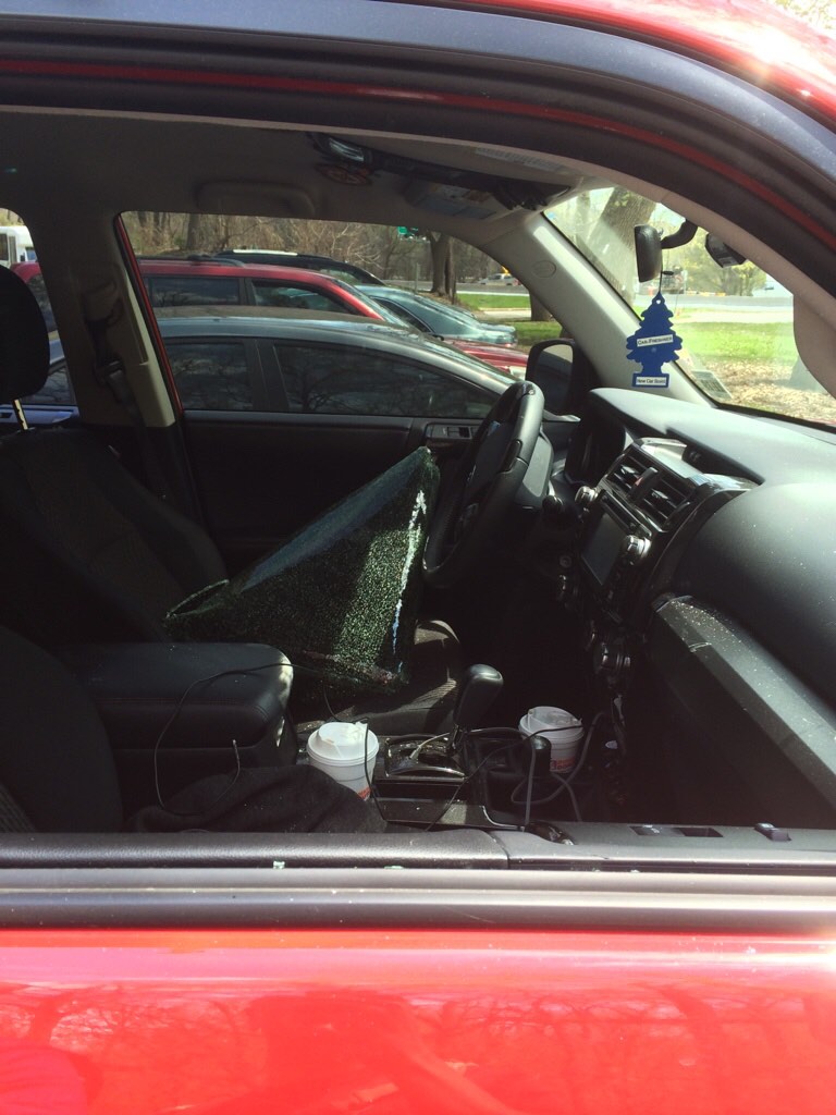

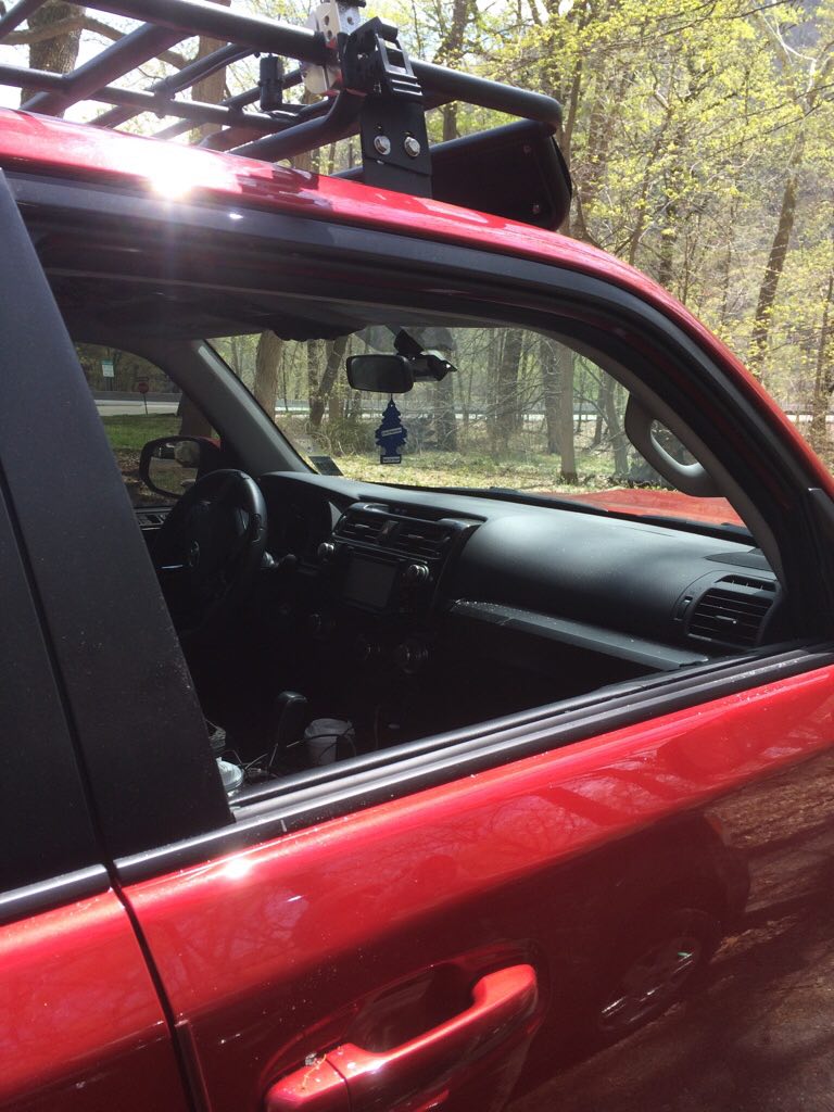

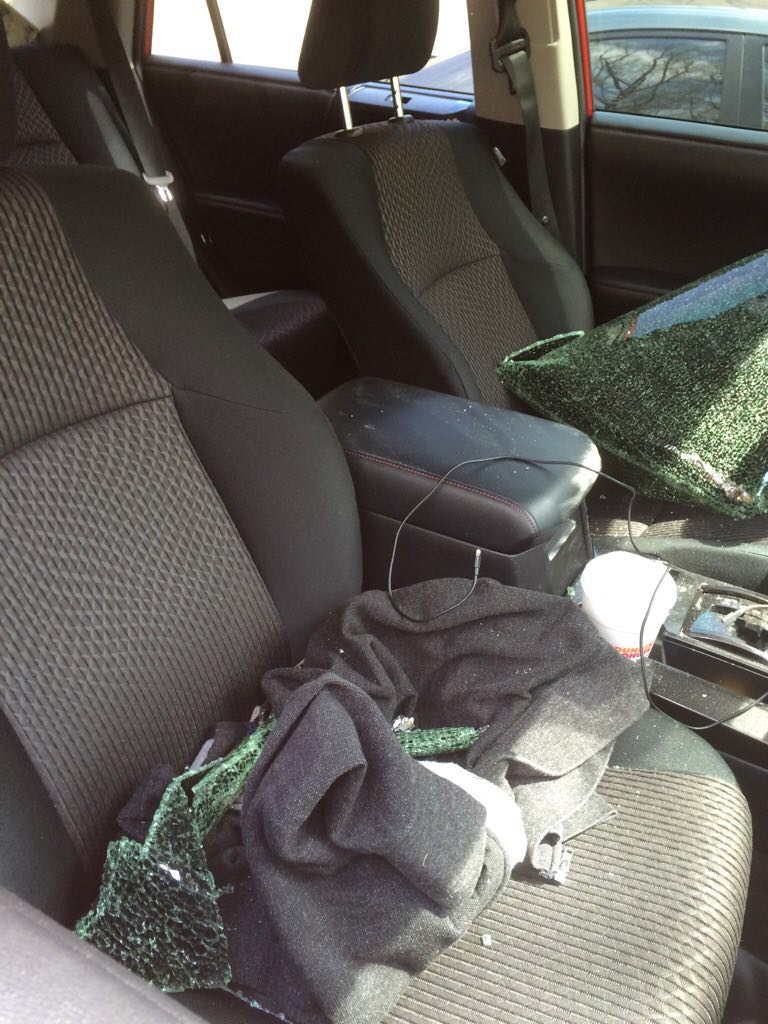

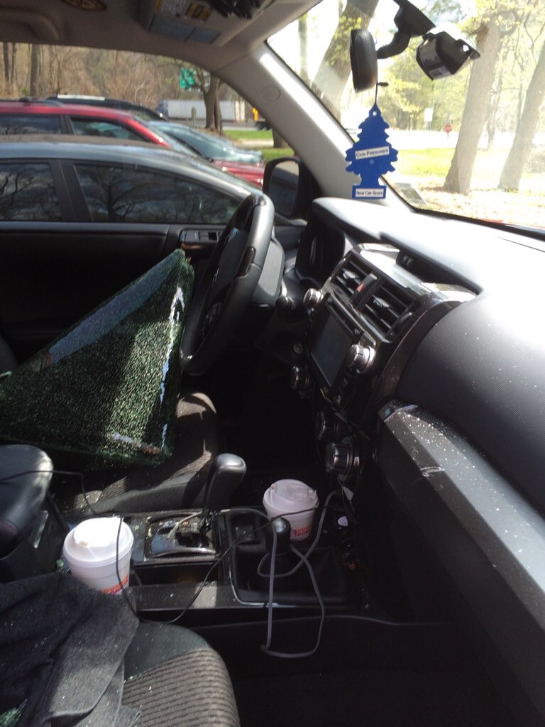

Went hiking in Worthington State Forrest NJ, upon return found out Hodor was broken in to. Two backpacks and a sleeping bag was stolen. These scumbags kicked in my window and destroyed almost every plastic trim piece in the process.

Damn loser a$$holes. I know the feeling all too well.
At least insurance will cover it. Sorry man...
Bear pic is really cool BTW!

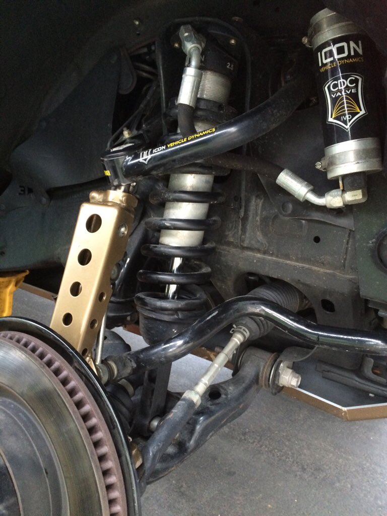

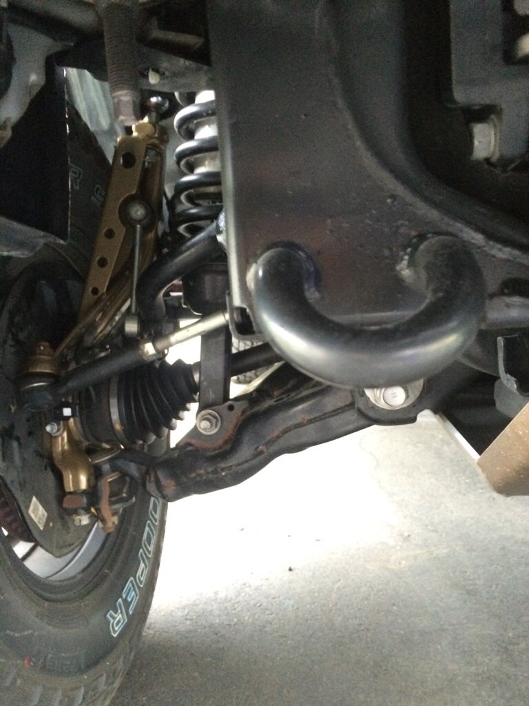

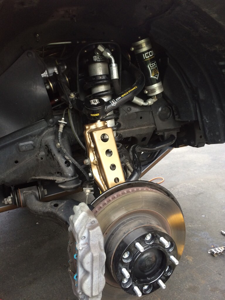

Installed spindle gussets

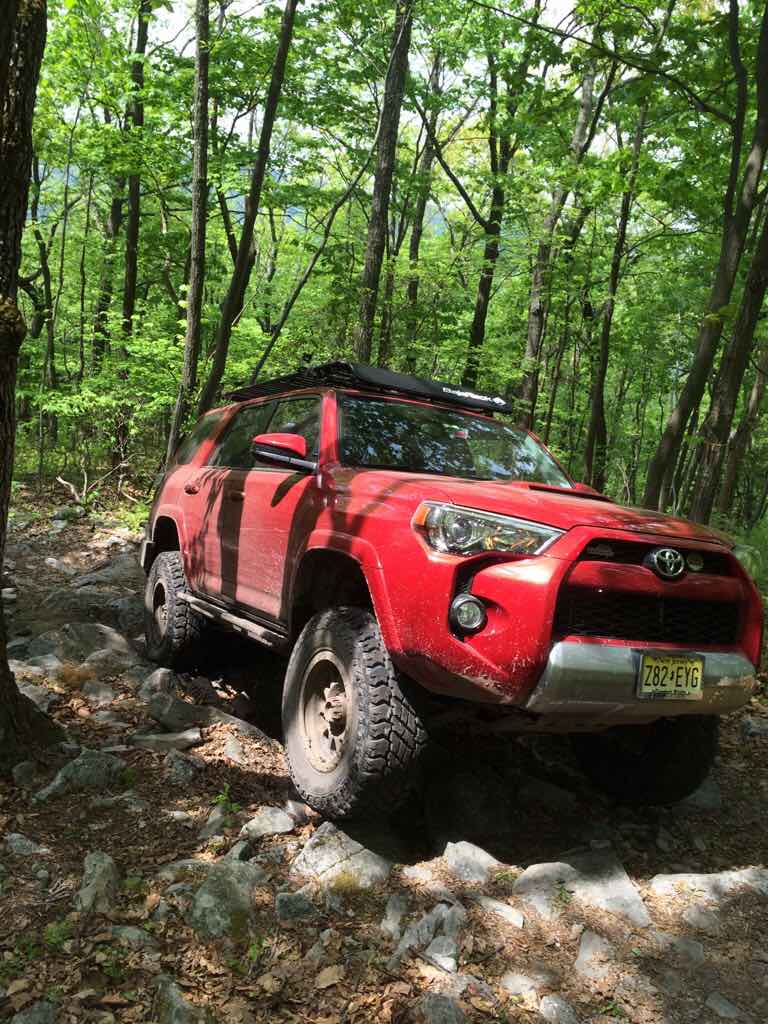

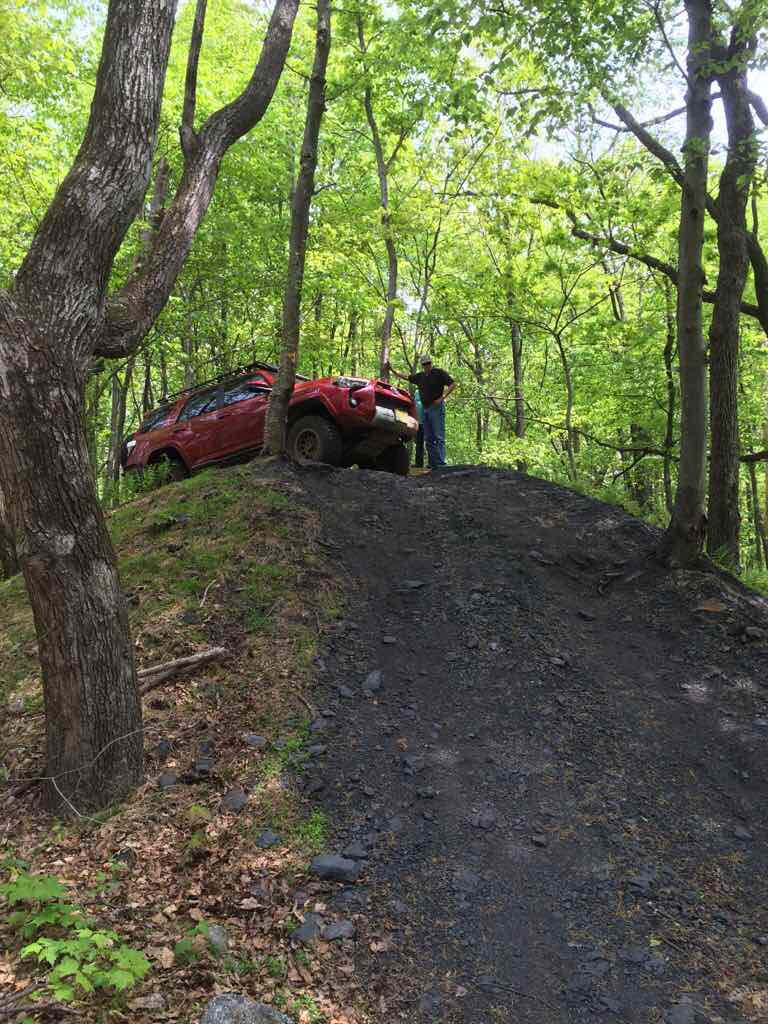

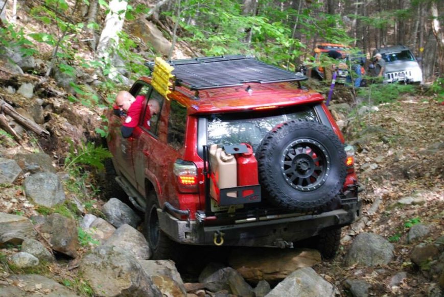

8th Annual FJNortheasters run at Raush Creek PA was a great success. Hodor behaved excellent and in return received some new scratches dents and pinstripes lol
