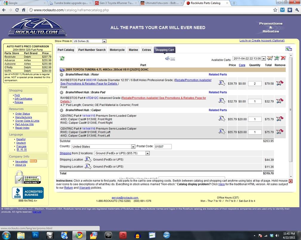

Can someone tell me if this parts list looks correct? Thanks guys.

You don't need to buy calipers.
Just buy 2 rotors and 1 set of pads. 1 set of pads will do the whole front end.
I would recommend Brembo rotors if you do not want to go through this again.
When doing pads, all you need to do is slide them out from the back, just removing 2 pins. To remove the rotors, you have to take off 2 17mm bolts on the back side of the caliper, and knock it off with a mallet. Its about an hour job.
