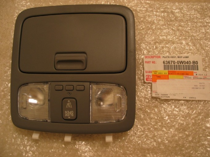

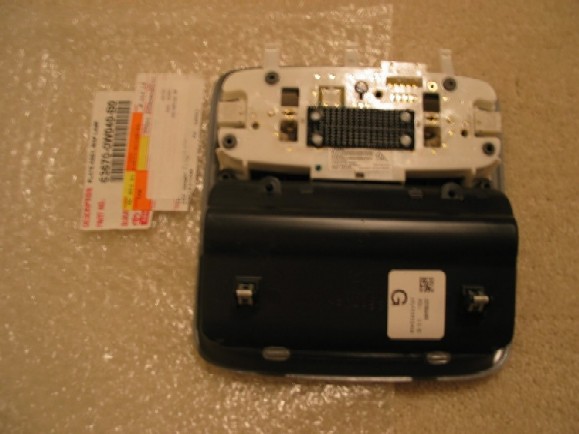

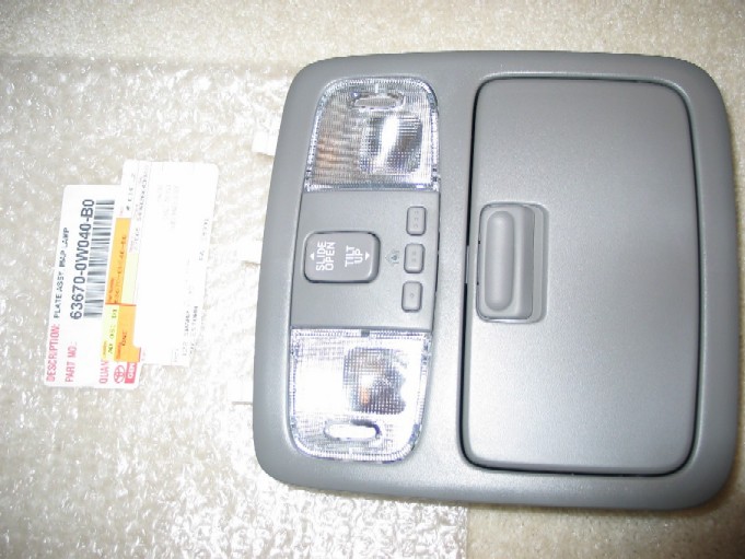

I'll try to post pictures tomorrow. Again I held this part in my hands.
This had to be the easiest mod I ever did, easier than changing a light bulb.
First here are the pic's of the part that I picked up last night at the Toyota dealer:
All you have to do is pull down at the front of this plate, it pops out, undo one plug and it is off. Plug the new one in, pop it back into it's place and you are done. 2 minutes flat. Then it only took me about 5 minutes to read the manual and program it. Very simple.

If you look at the pictures you will see two clips under where the sunglasses holder is, this is what you are pulling out. They are just pressure clips so I doubt that you will do anything wrong. If you had the new part in your hand you would see these clips and realize there should be nothing to it.
