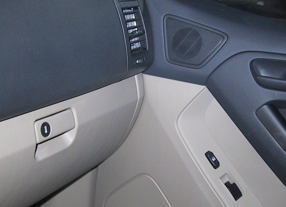

I like to get one for my 03 4Runner too (Titanium color). You guys kept saying oak/stone/taupe, my interior is a tan color (yellowish tan), what part number should I order?

You have a silver with tan interior? Wow I don't think I've ever seen that combo before.
Any pic's?
BTW you need to order the Oak.

Thanks, Toybox. I bought it new from a dealer's lot and that's what came with it. I'll take some pics and show you.
I'm going to order the oak one then.
-Mike-
Toybox, I just took a pic of the interior of my 03 4Runner (titanium color). The dash is dark grey but the carpet/roof and everything else is tan.

It says "fawn". Is this the tan color that I need?

There are only two colors choices for the plastic portion of the 4runner interior (regardless of trim level).
oak = fawn = taupe = tan = brown
stone = grey
First I've heard of the tan interior on a silver 4Runner. But according to the 2003 brochure, it is a valid color combination.
