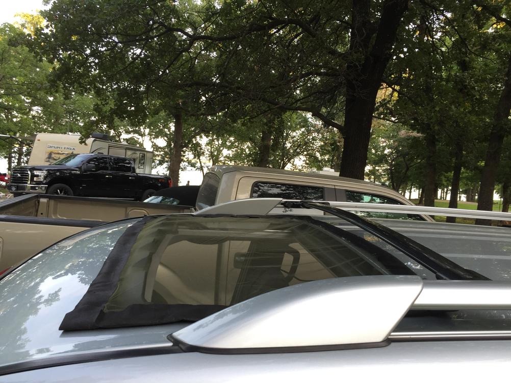

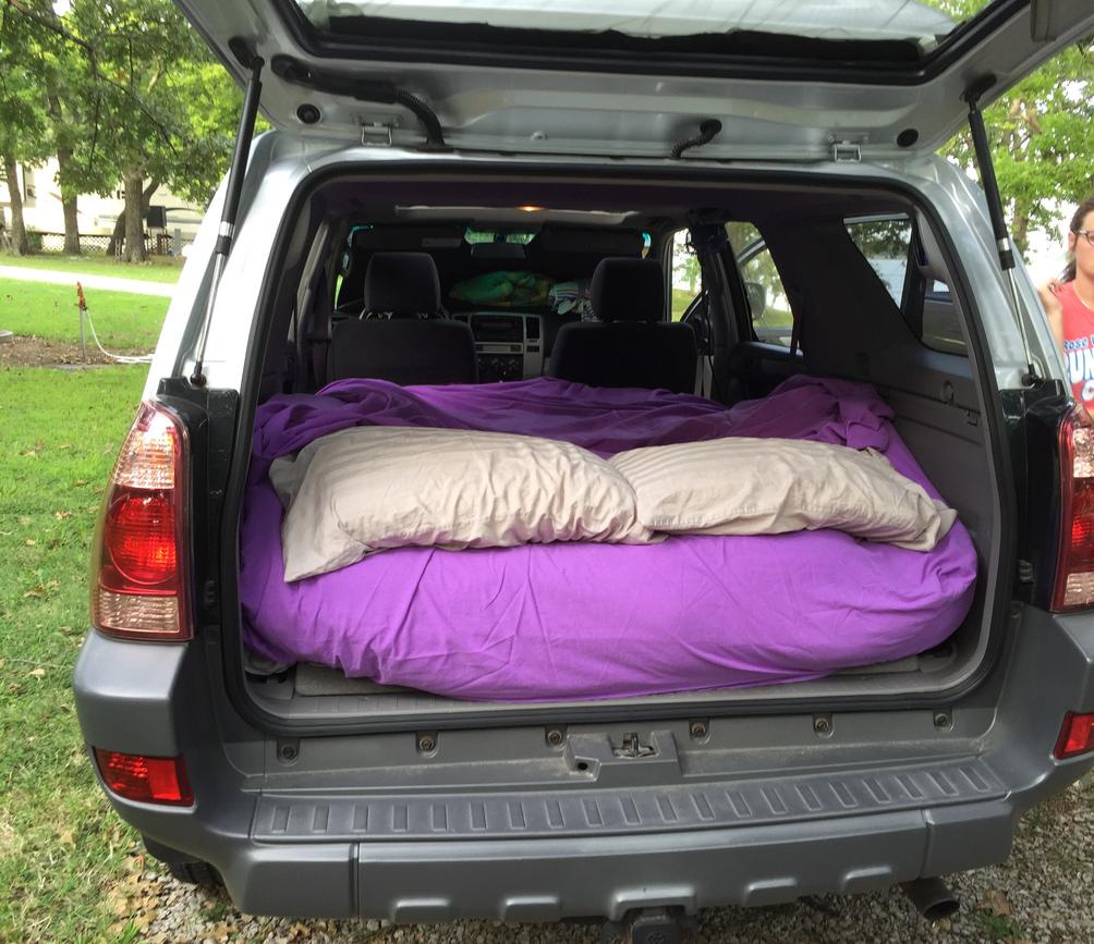

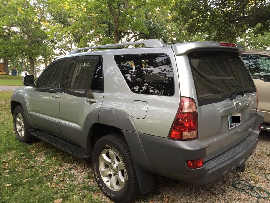

We like to camp, but it's such a drag to set up and tear down. I made these real cheap. We went camping with friends and family. We tore down and packed up in 15-20 minutes. (Of course, we then spent 3 hours helping everyone else "tear down" and pack up tents and RVs.) Some places don't want you sleeping in "cars," but this was way more comfortable than a tent. My wife loves it too! To make it I bought a mosquito net at Academy ($10). I went to Walmart and bought some tent-like fabric ($4). I then went to Ace and bought some magnet strips ($15-$20). This made screens for all the windows (even the rear) and the sun roof. I wish I had gotten stronger magnets, but overall this was awesome!!! Once they're on, they're on. I used hot glue to put them together. I actually glued them together on the 4Runner, so I knew they would fit. Here are the pics.

Those look great. I made some myself a few years back and did a pretty poor job of it. I really like how wide you made the magnets at the bottom. Much cleaner than my version. Any chance you could post a link to the actual magnet strips you used?
I tried to make myself something similar however the magnets just didn't work. They fell at the littlest bump. I tried to search for larger magnets, but wasn't having much luck. Nice job.
