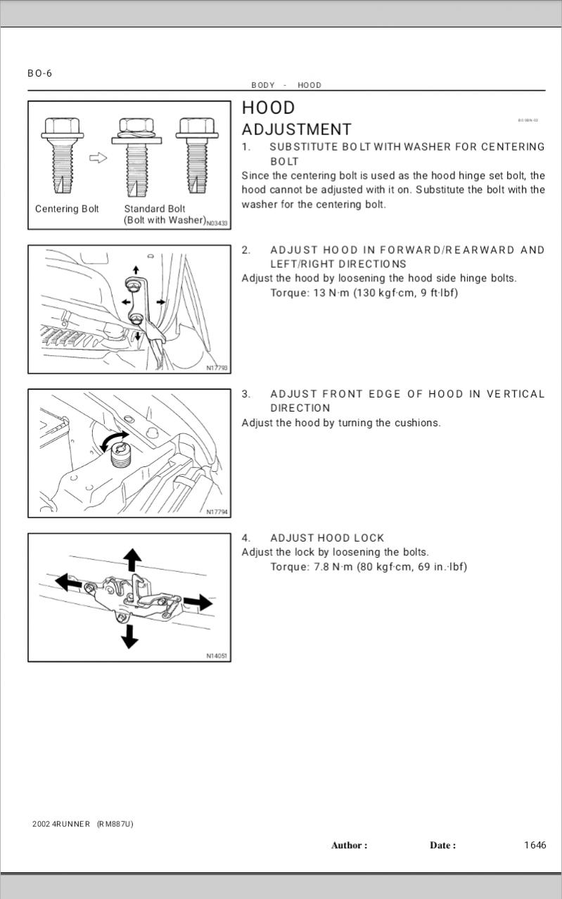

lubricating the mechanism and pusing the right side of the spring down has worked for some.
Start with lubing the latch and adjusting the the hood instead of the latch, if possible. The latch has the 'centering bolts' as shown in the above procedure. You might even be able to bend the latch loop a bit to line it up.
